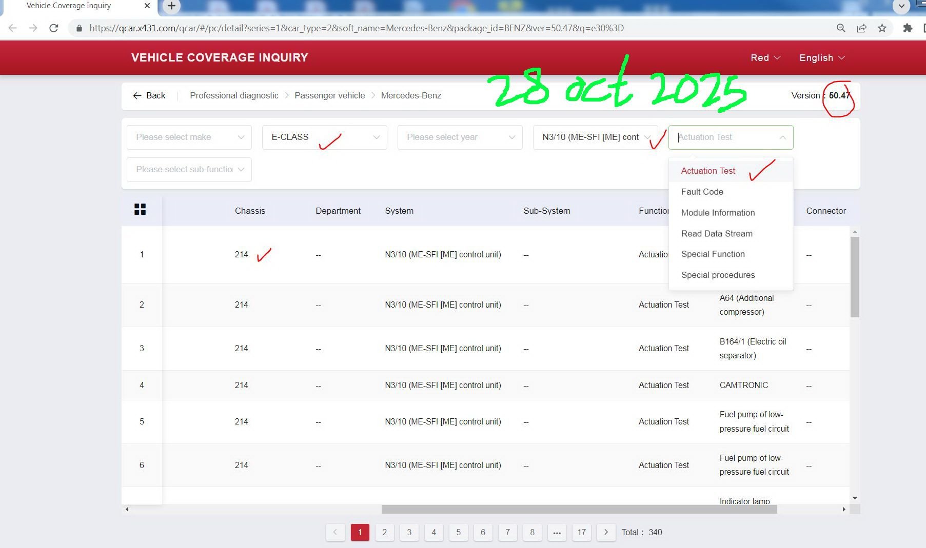

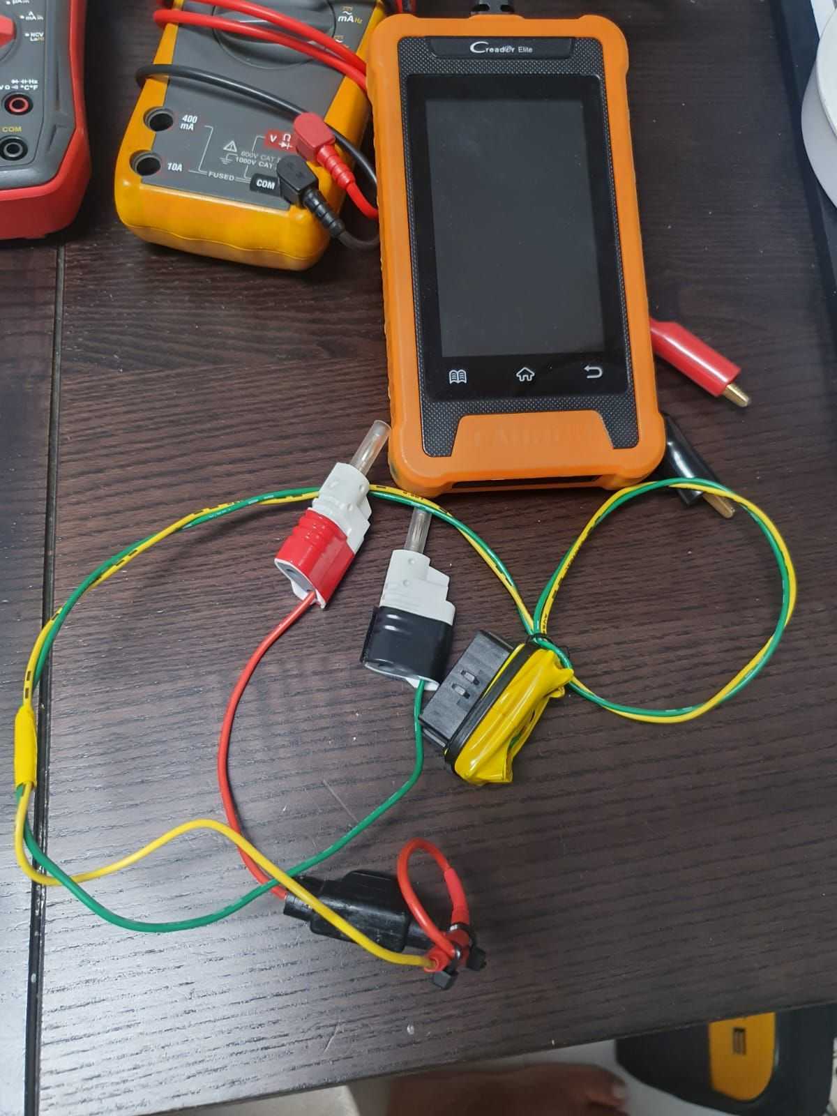

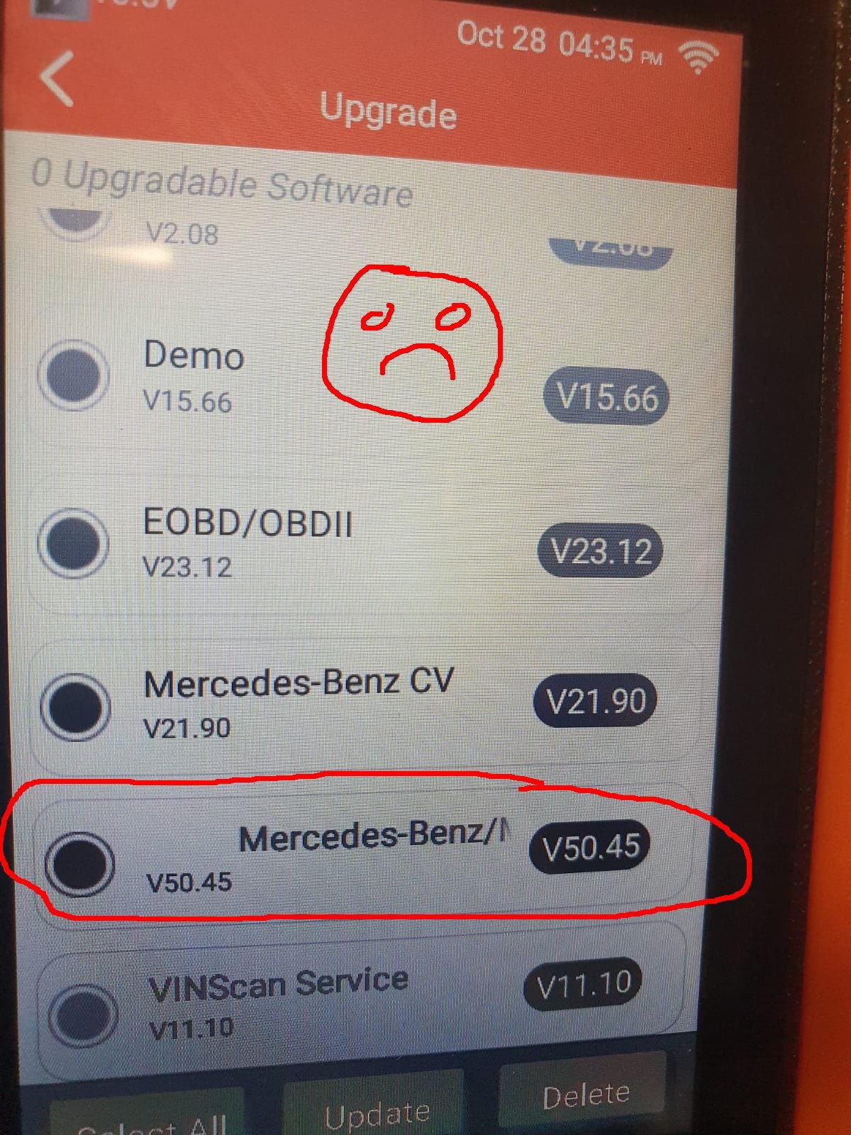

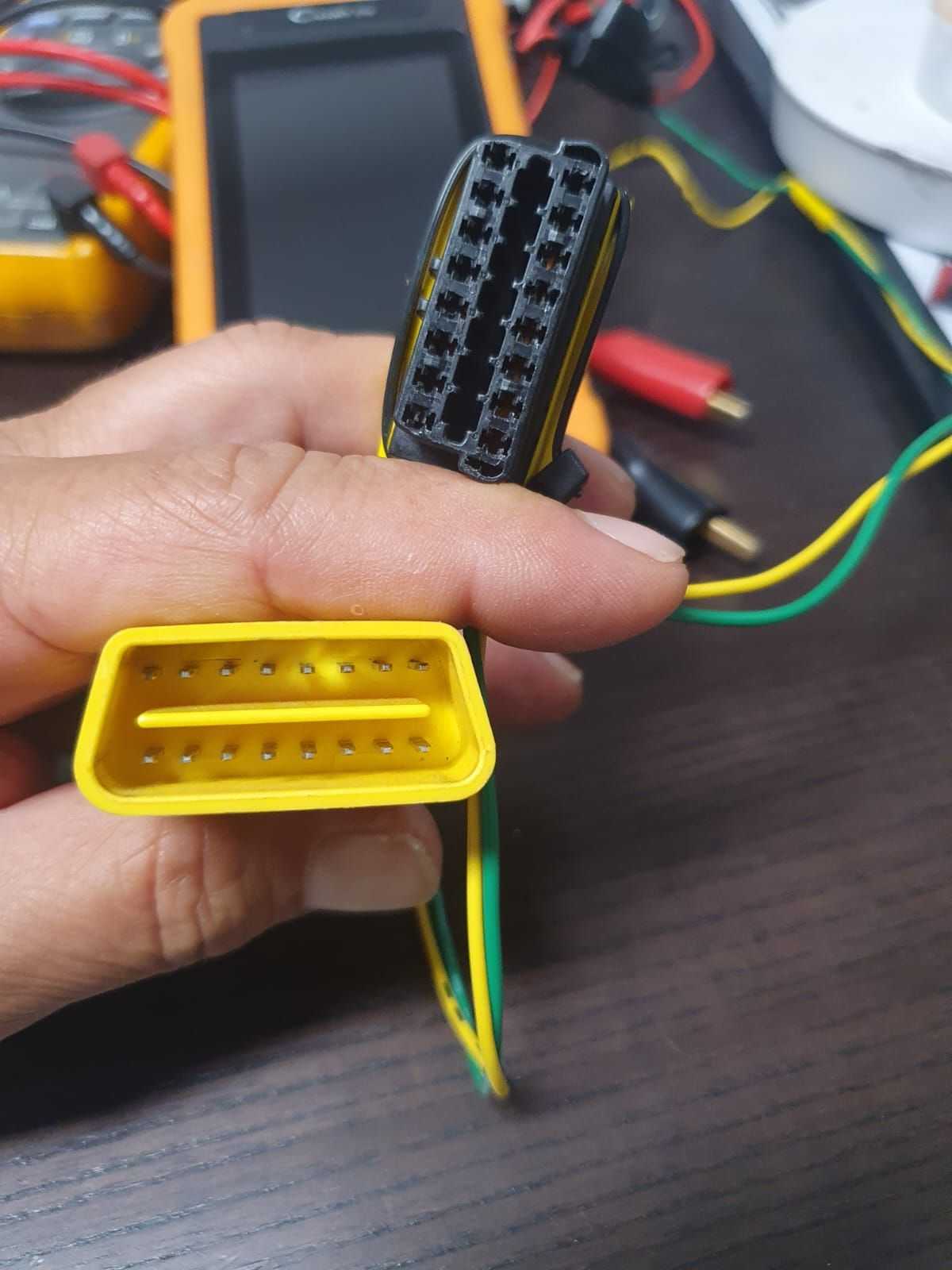

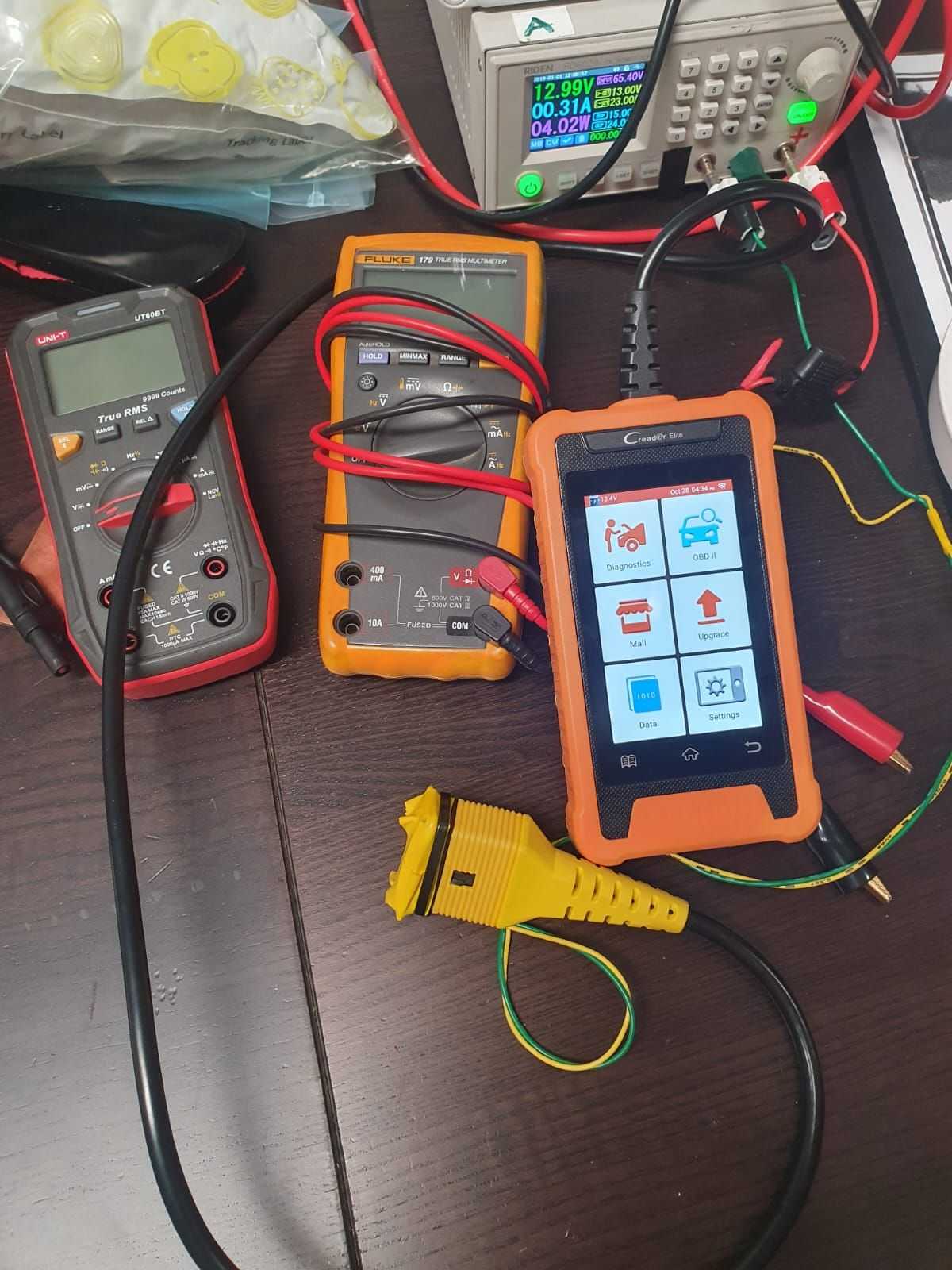

Well updating baby launch is always a BI-E-TCH
Not only it is super slow for me in Indonesia, I mean 5kb/sec sometimes....hello....my internet is 100mbps
FOR ME : UPDATE will fail like 3 times at least.
But all 3 times I get some data already bit by bit so its like their server timed you out after X mega bytes.
You can see the progress colored bar when updating for 2nd or 3rd time, it wont be zero, it will be 1/4 and then 1/2 and then 3/4 .. and when all done = UPDATED.
Its dumb-azz tiring this poor process, few hours it will take and I use stand alone bench power supply to power it, I do not use my car OBD port.
Xtool will update my MB software in under 2 minutes at 20mbps easy.
You guys can buy a ready made OBD wire extender and cut it, get 2 aligator clips red and black and 1 small fuse block and use 1A or 2A fuse and make it for running the baby launch without bench power supply.
Use your battery jumper post direct at engine bay. If you use your OBD port, car door opening and staying open will consume approx 6 amps constant, first door open is 10 amps.
Hood open is OK, car computers will deemed it as SERVICE MODE and does not wake up much computers. I keep my hood always un-latch at home.
TODAY : Still oldie software V50.45 and not the latest one V50.47

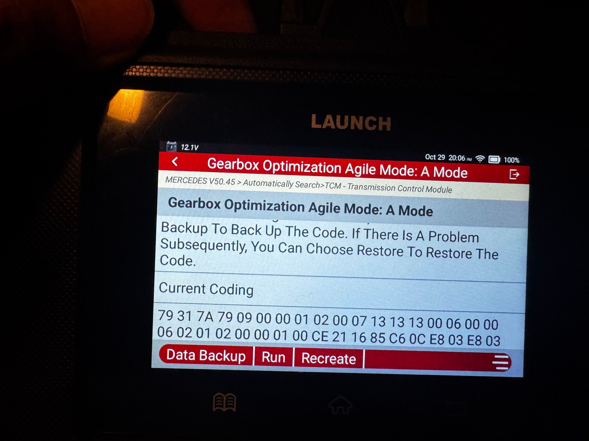

I played around with launch after a while. does this mean launch can enable agility mode? I did not dare to continue further lol

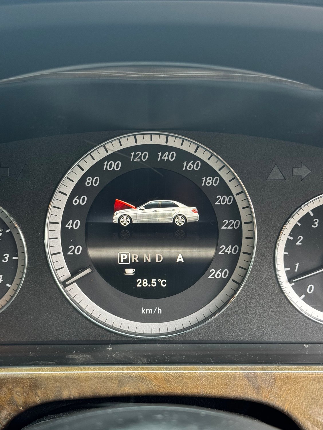

Finally I have the courage to do it. After saving up my original code to several places I just run it. Now I have agility mode 😄 what amazing little machine

Have you seen the remaining fuel level coding option? Perhaps in the cluster module?

I did not seen that option on the launch so I paid someone else to code it (when enabling amg menu)

Mas Tesna,
Share with us how Agility mode would behave in bad slow traffic of Jakarta, I assume it will be bad because its logic I gather is wanting high rev and no hesitation type of driving.
For open road, I am sure it will be good.
For my car the immediate difference between E or S is that S does not go to highest gear like E when coasting, its providing a tiny bit higher RPM.
As for WOT, both will do 6,500 RPM.
As for how fast tranny will change/drop gear, I recall slightly faster, but very slight due to S mode keeping itself in less highest gear.
But S mode in Jakarta creeping traffic I don't like, too agressive.
S mode for me is best for non-highway ( 40-50KMH typical ) but interstate road where when coasting waiting to overtake, E mode would be at highest gear, but S will be at least 1 gear lower.
Paid highway when crowded or empty I actually like E mode, less RPM at coasting means less noise and the tranny is fast enough to modulate for semi agressive or very agressive overtaking.

Pak Surya,
Sure I will share my findings later on. But from what I read from quick google search A is between C/E and S. I rarely uses S as I think it uses too much fuel lmao. Rarely goes to 7th gear on the highway. Lets see this afternoon driving from the office to home.
https://mbworld.org/forums/sl-class-...lity-mode.html based om that I’m interested on enabling that mode.

Agility mode is not as aggressive as Sport. It will still start in 2nd gear but it will no longer use double up or down shifts, making the gearbox work a little more but with a more agile response. It's different but I rarely use it.

Well, over the weekend I tried Agility mode, to be honest I can’t really tell the difference between A and S lmao.
On mine, A still starts at 1st gear. On slow traffic it shifts at 2000rpm (the C shifts at 1500rpm ish). On the highway it sill go to 7th gear at 100kph (but so does S). C goes to 7th gear at 60-70kph I think.
However, I tried to launch it from 0 WOT on A mode, it shifts much quicker betweren the gear changes, much faster than C mode. I can feel the pull on every gear change, almost like dual clutch lol. On C mode feels dampened. I did not try to launch on the S mode yesterday so cannot compare to S. But I never feels the car shift this fast before.
and yes I did reset the transmission adaptation values also.
