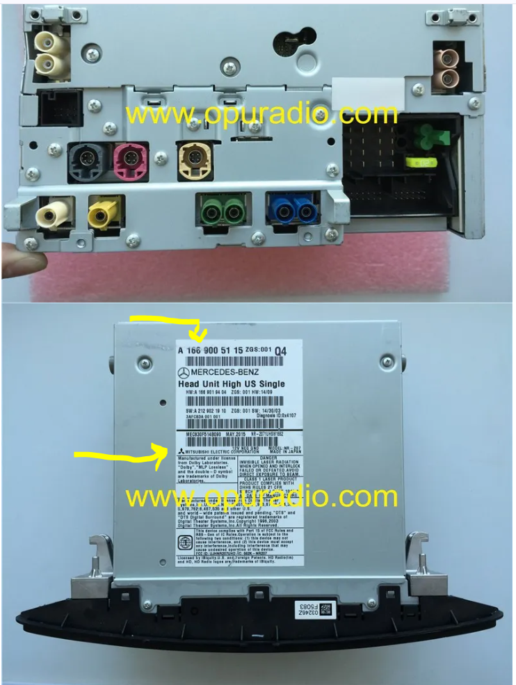

This is good karma! I am guessing your unit needed a sort of vacation... likely a marginal 16Volts capacitor gone bad in a hurry working under 14.9V + ripples.
This Mitsubishi head unit internals remains a mystery to me, safely hidden behind countless screws
Repairs between $2500 and $4000 are a good encouragement to spend a couple hours to fix the built-in defect.

right now, keep in mindthe failed power supply caps is is only an assumption (not proven solid).
There is an engineered failure in that Mitsubishi unit that materialize regularly. It's Not a random one in a million type of failure...
Based on what we've seen on this chassis we can make educated guesses until we find proofs.
It could be the amazin' 16V caps,
could be oxidized solderless pins,
could be poor painted GND,
could be failed boot enumerations,
Without any clue, a schematic or troubleshooting procedure, we are helplessly trying to repair this $4000 rat-trap.
I know very little about this mystery-box. Mine boots and plays sound surprisingly much faster since I have resoldered my CAN-B modules.
So I can confirm that CAN plays a role in NTG boot speed.
Perhaps there's a timeout that causes unit to boot-loop searching for peripherals. I have not dealt at all with the MOST fiber ring. I think MOST is fine even though we know there is an enumeration of fiber devices.
