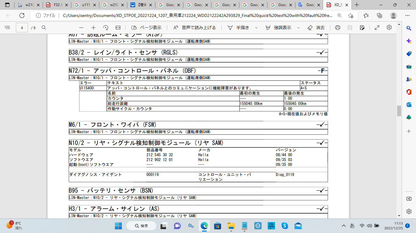

U115400上部コントロールパネルとの通信に誤動作があります

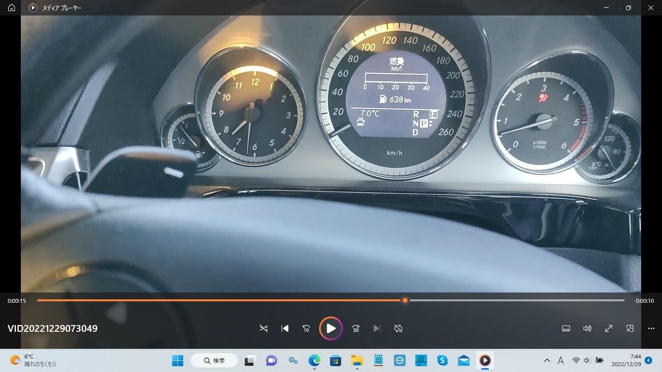

srsライトが点滅していて、オフにできません

Aha so that is how Japanese language Xentry looks like, cool.
You need to translate to English if you want to ask question.
It seems your 72/1 Upper Control Panel has communication issue U115400, that is what I assume based on non Japanese text
=============== Google translate==================
Line 1 : U115400上部コントロールパネルとの通信に誤動作があります
U115400 has a communication error on the upper control panel
Line 2 : srsライトが点滅していて、オフにできません
srs light cannot be turned off
Could be CAN BUS wiring issue, could be dead N72/1 power wise or defective component death
Xentry can do bidirectional test turning ON those N72/1 switches LED light if I recall correctly, try that.
Which module reports the SRS problem ?

You need to find a good workshop familiar with Mercedes.
SRS light can mean many things as it is linked to airbags, seat belt, weight sensing seat, and collision sensors and some cars has those pop-out hood when hitting a pedestrian.
Problem with CAN BUS wiring or can-bus chip on the module can also trigger weird trouble codes.
Xentry or proper scanner can tell you where to start, but true troubleshooting must be done by someone qualified.
Sorry, that is all I can advice you.
