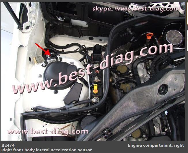

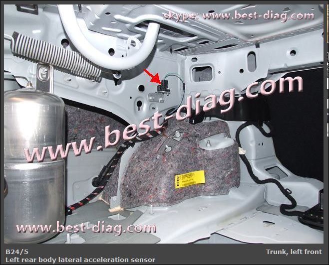

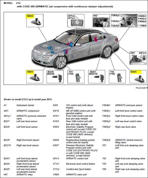

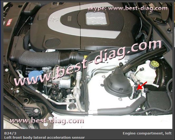

Best to have someone pull codes using Xentry (MB diagnostics) for definitive diagnose, check PM. Reluctant to do so, check condition/connections of acceleration sensors first if you want part #s provide VIN.

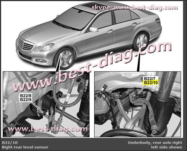

I forgot to mention that when the malfunction first came on I parked my car and there was a loud clicking noise coming from the rear. Seemed to be from the right side.

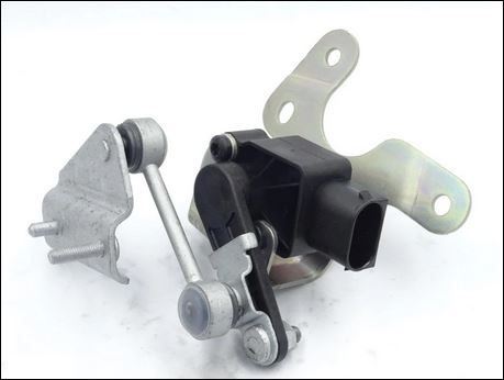

There are 4 level sensors, check right rear.

Thanks, I will check that one tonight.
