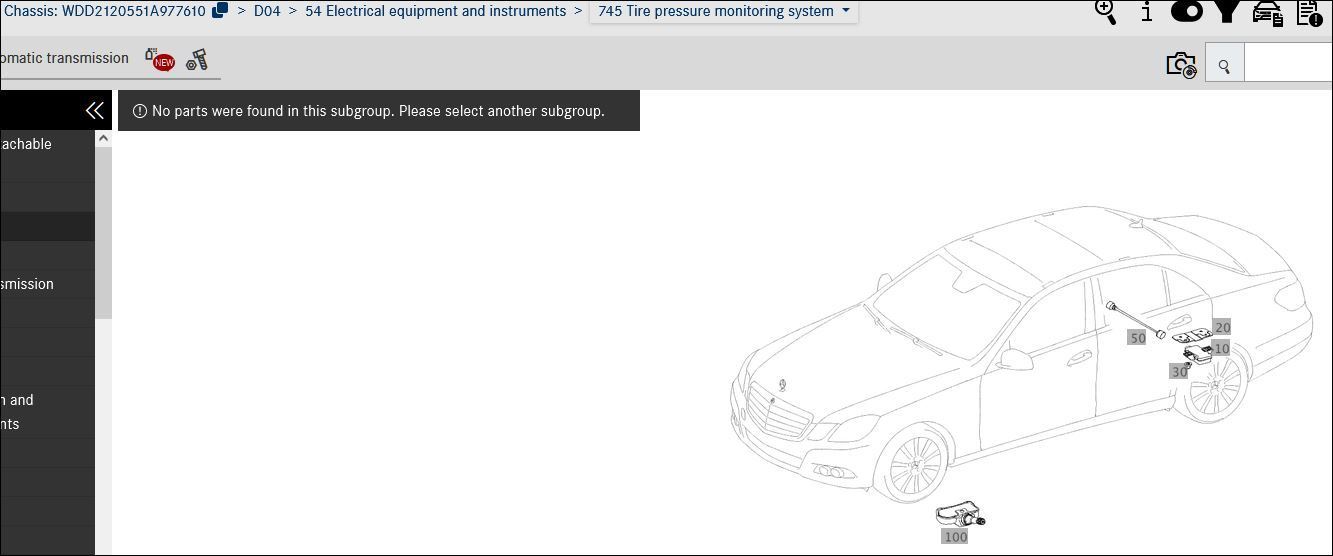

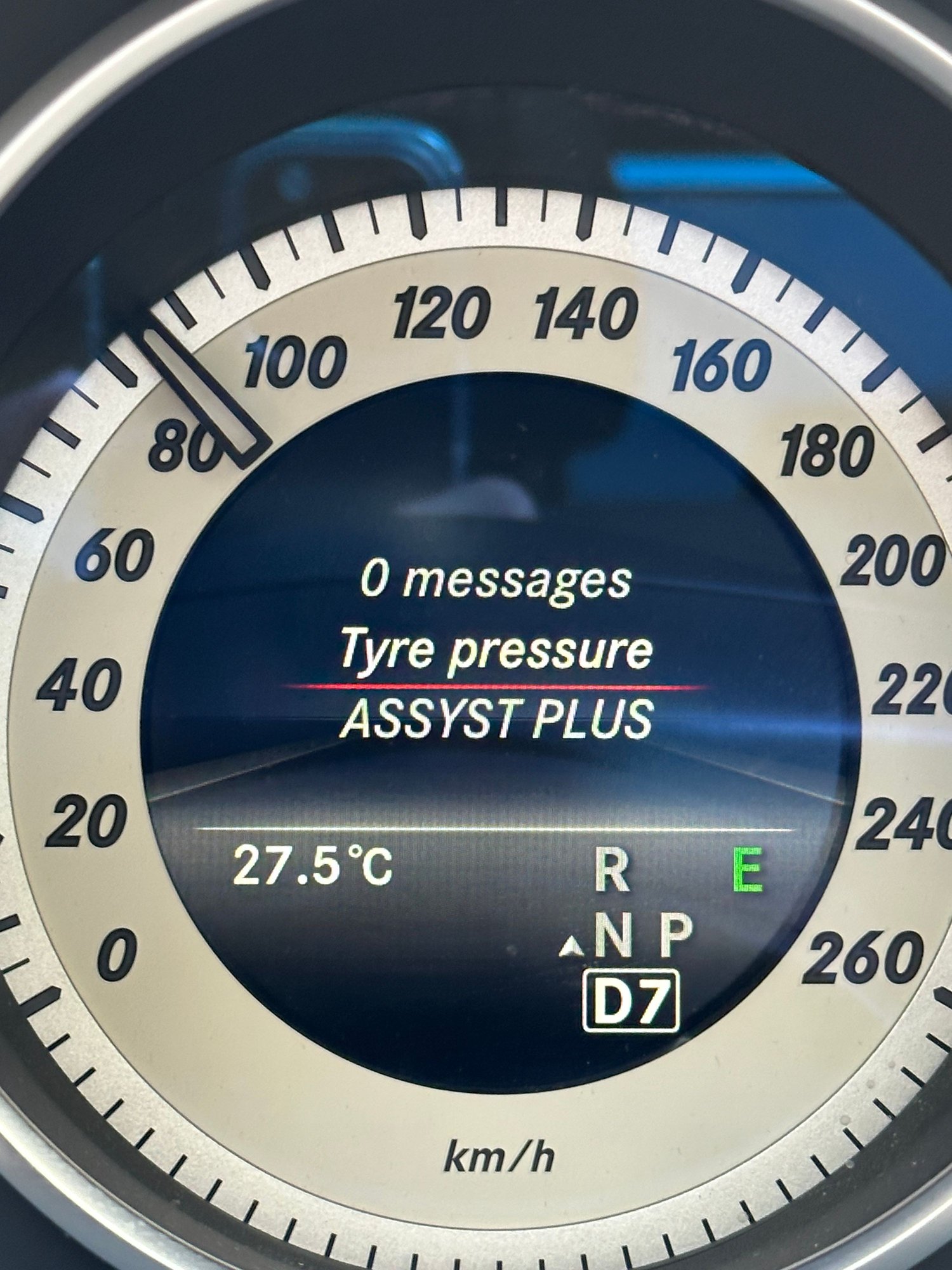

Hi
I have E300 ( 2014 ) ( VIN: WDD2120551A977610 ) Data Card is attached.
So I'm trying to Tyre Pressure indicator on my car dashboard , and I only find this option ( Tyre Pressure - First Image ), However when I click on that option , the run flat Indicator appears ( second image ) which is not the one which I'm Looking for ( which shows the kPa in each Tyre )
according to the data card I have (477 Tyre pressure loss warning system)
Please note that I replaced my run flat tires with non run flat, and so I prefer to always see the pressure of the tires.
Any Idea what's wrong ?

Your vehicle is equipped with low level monitor void of wheel sensors whereas ring at each wheel monitors rotation and if low tire pressure affects rotation warning lamp is displayed.
So basically my car dose not have this features which I'm looking for ?
can I install the tire pressure sensors and coded / programmed to appear on the dashboard ?

Other members may offer input on aftermarket solutions however, to retrofit MB you will need: 4 wheel sensors, control unit/harness adapter, and wiring harness together with (MB diagnostics) Xentry coding.
