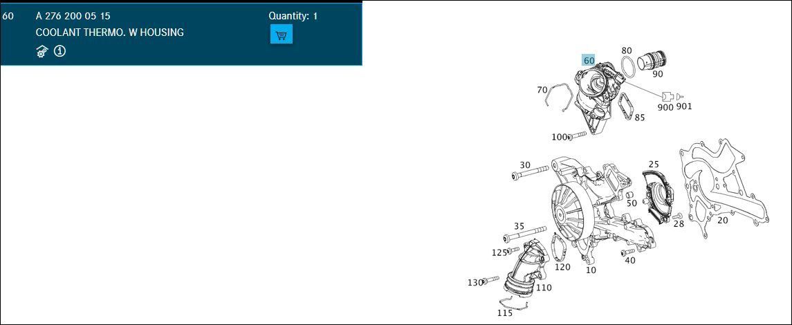

Hi there, I am confused. Do I need to remove any other parts to replace the old thermostat on my W212/E300/M276/2014?
Anyone share with me how to DIY?
Thank you!!
Reply 0
Apr 9, 2023 | 04:10 AM
See attachments.
Reply 0
Apr 9, 2023 | 04:29 AM
Quote: See attachments.
Thank you! Does this mean I need to remove intake manifold? That would be quite a job. Also Do I need to remove the drive belt?
