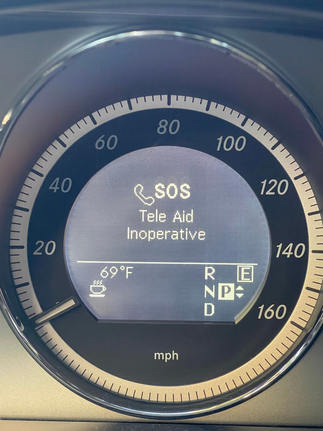

Need help !! How can I get rid of this?

try to unplug the module. Located at the front part of rear trunk!!
I say "try" because who knows what module is going to bug out without this box live on-line
else pull the fuse likely trunk SAM.

with gen3 cellular DOA now, will that SOS feature even work any more ? (at least in the USA)

Quote:
nop, of course not.... Originally Posted by Left Coast Geek
The mBrace module has no OTA connection to speak through. All these SOS Modules are reporting not being able to phone-home ie. no more automatic emergency report.
I will check for the fuses and hopefully will work Originally Posted by CaliBenzDriver
try to unplug the module. Located at the front part of rear trunk!!I say "try" because who knows what module is going to bug out without this box live on-line
thank you
