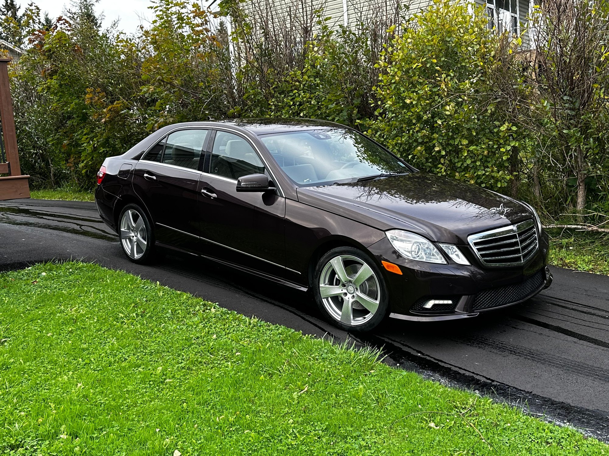

Hi everyone ! I’m new here! I was lucky enough to acquire a 2011 E350 4Matic with only 27,000km! It sat for a really long time so brakes were on the to-do list. I’ve replaced both the front and back with Bosch parts (including all ebrake hardware). After this was done I road tested and heard some drag in the rear and suspected the ebrake shoes needed more adjustment. I, for the life of me cannot get those rear tires/rotors to turn. I have the entire rear of the car up and transmission is in neutral but they simply won’t budge. Is there something I’m missing here ? Appreciate any help you can provide !
