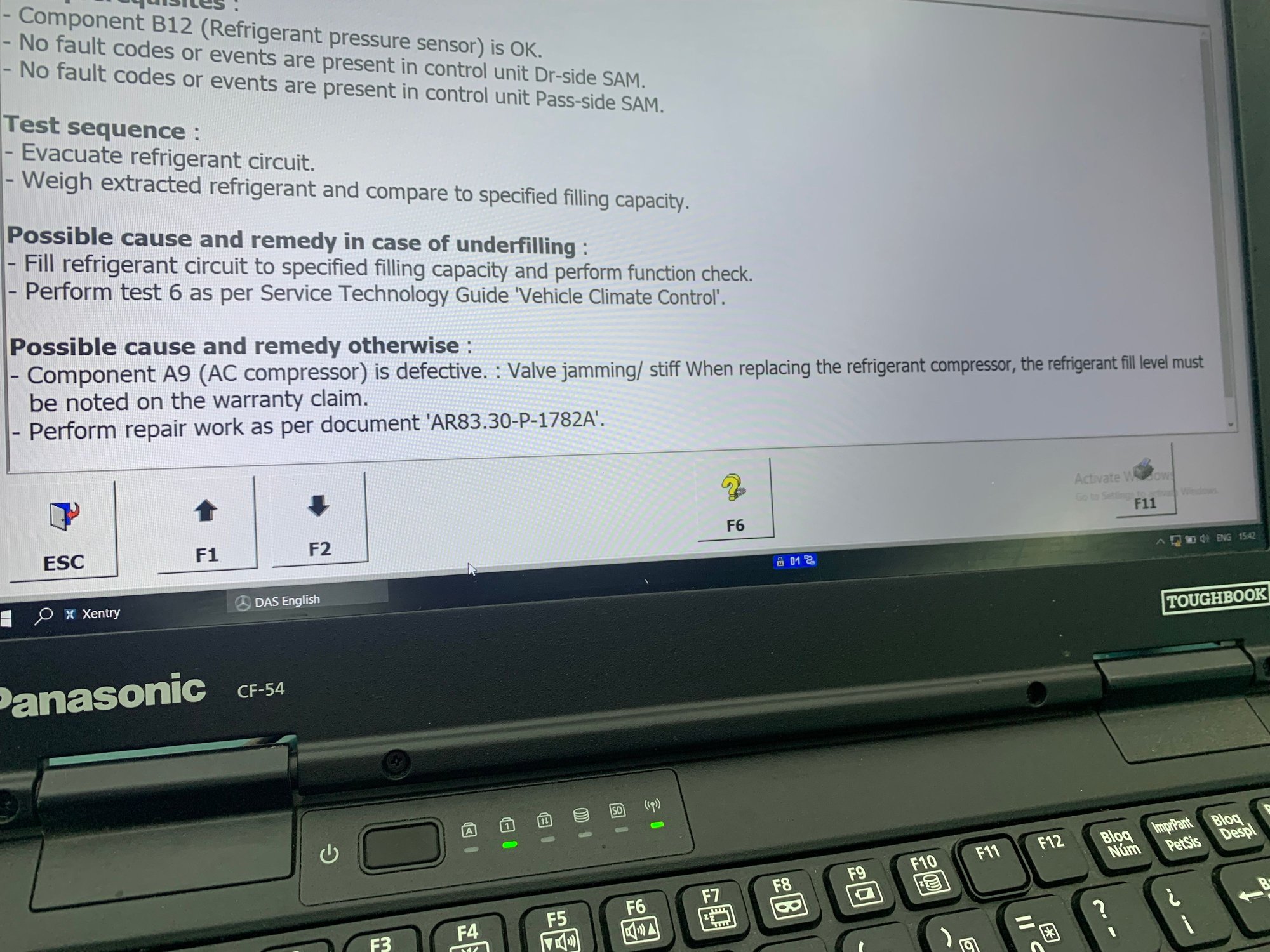

Also checked the car with STAR and there were not error codes but this message came on the picture.
We tried to change the valve on the compressor but it is still on constant pressure and freezes the system.
Does anyone knows what this bulletin is for, I can not find info on internet for it.
Could it be the clutch that is making the problems or is it the compressor itself.
Thanks!

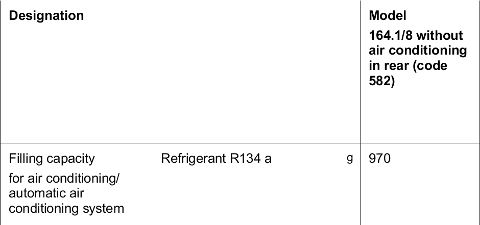

but we hooked the AC on the machine and the level of the refrigerant was nine hundred and something. When I look at the specs there should be 970g, so it is not the issue.
Thanks!

multiple failures...
I think the high side liquid is not controlled well !!!
Regardless of AAC Module, the TXV itself should never freeze the line... all the way back to compressor.
Perhaps the compressor is running on Max non-stop due to a control issue. AAC module use many temp sensors for feedback... yet keeps on building pressure... that's really odd!
We assume the compressor has both clutch + proportioning valve to control it... perhaps this one does not.
Can't go wrong with a full chassis scan then AAC data collection then a physical.

I don't know. There should be a label stating the amount to use +/- an adjustment amount. If the specs say 970g +/-25g (or whatever) and you have 910g, then you don't have enough. You need to be precise when it comes to this stuff.

Can you provide your VIN or full model number (212XXX)? I need to enter it into WIS to make sure I am looking at the correct data, but from what I see the amount of refrigerant to be from 590g to 690g based on the model.
Assuming I am looking at the correct data, you are WAY overfilled at 970g. There is usually a pressure switch that will disable the compressor if you are that overfilled.
The VIN is 4JGBB8GB8BA689464

Thanks. I had the wrong model, etc. You are correct; the fill capacity is 970g. But we still want to be exact in how much was measured. BTW, your model number is 164.186, which is your ML350. I missed that in your first post, so I was looking at an E-Class model. The attached doc might help.
