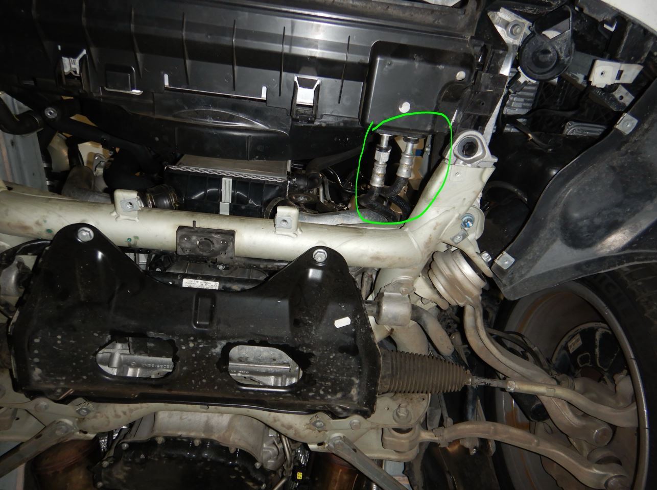

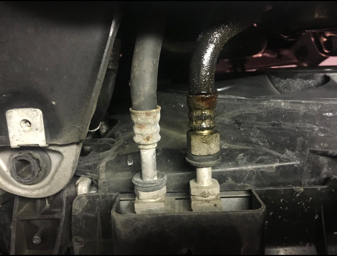

I had a leak that started a few days ago and while it’s not bad, it’s progressively worse.

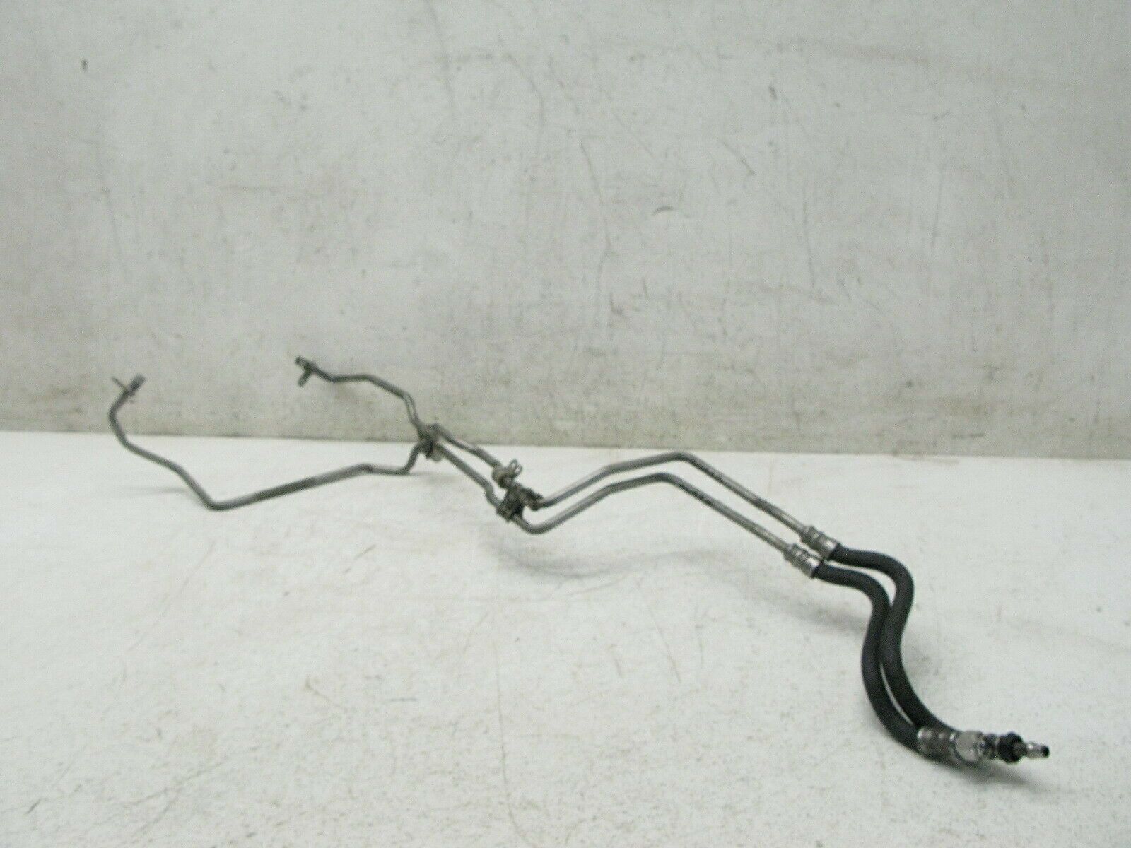

located the source or what seems to be the source. Wondering if anyone can identify these two hoses or if anyone had to replace them before. I’ve not dug in deeper and the photo attached is one I took from online.

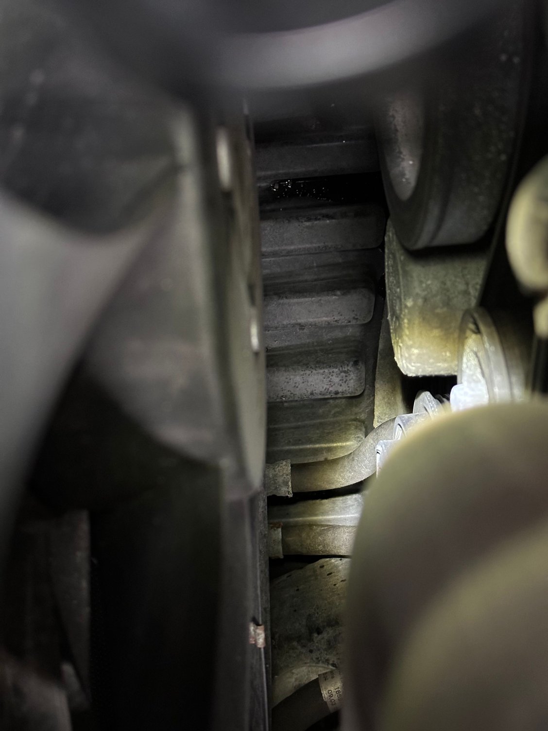

this happened as I was leaving to go out of town, so I didn’t get to investigate. The second photo is actually a photo of mine looking down from the top.

Looks like the rubber of transmission cooler lines are starting to soften.
You may want to take the opportunity to replace your $200 radiator while replacing hoses. Hose leaking is not a bad warning... I have seen aluminum lines in F150 brake off clean... dry tranny ✌️
The rad internal heat exchanger can kill transmission with mayo mix. The only chance we get to fix this is before .... afterwards tranny/car is RIP.
(Honda uses a proven-grade external heat exchanger: when radiator goes, tranny stays).

yes that’s what I was thinking it was the trans cooler lines. The first photo isn’t mine. I used that because it was showing the hoses quite well. The lines on mine are pretty solid, it looks to be the connection where mine is dripping from.
but I will likely replace the rad and lines at the same time.

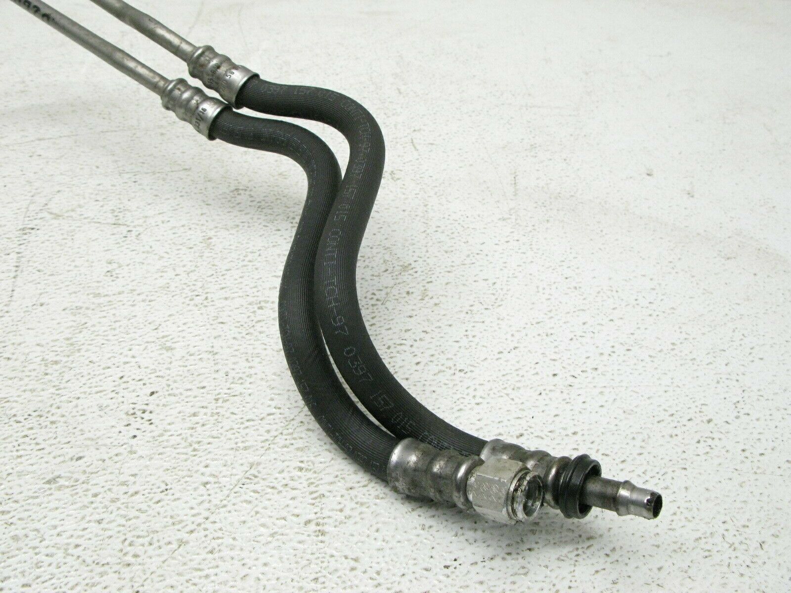

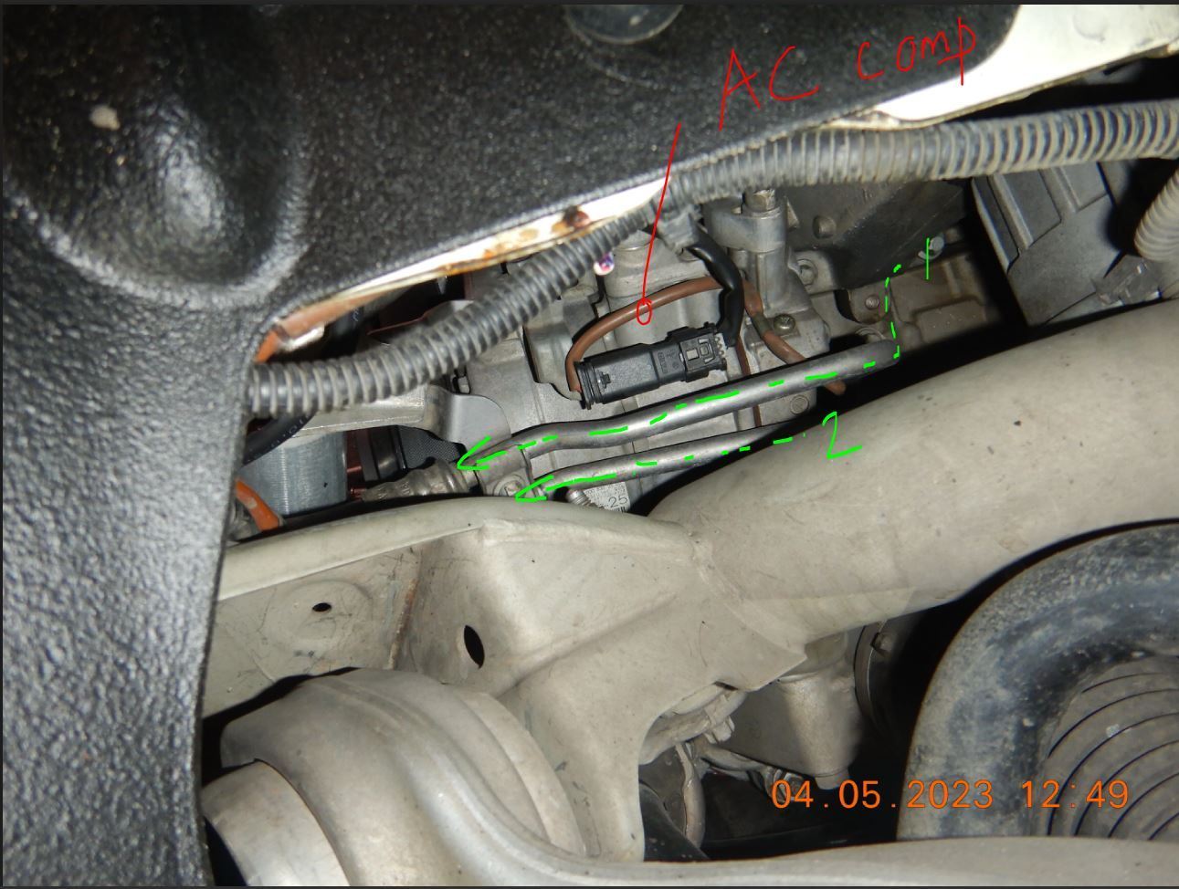

Here is a better view. This rubber hose + ALU pipe set on my 10th year replacement program too.
Each has its own part number. Make sure your P/N is correct for your engine version. Above EPC is based on my E400 as seen on the EPC

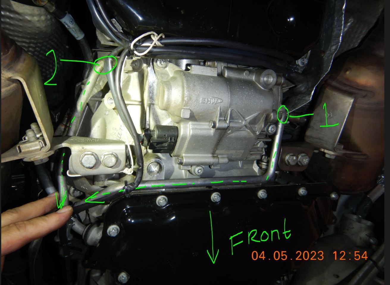

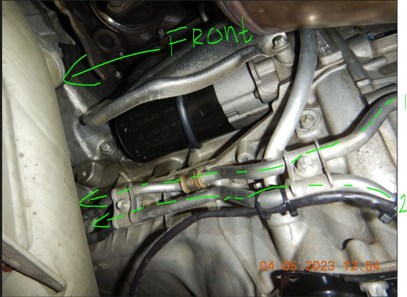

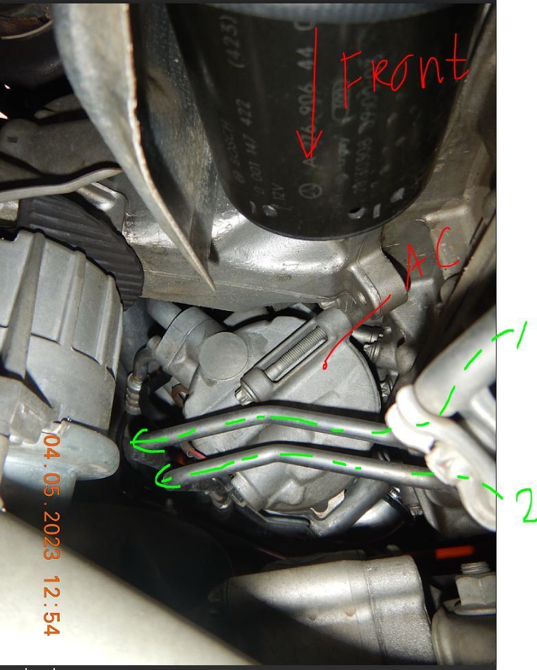

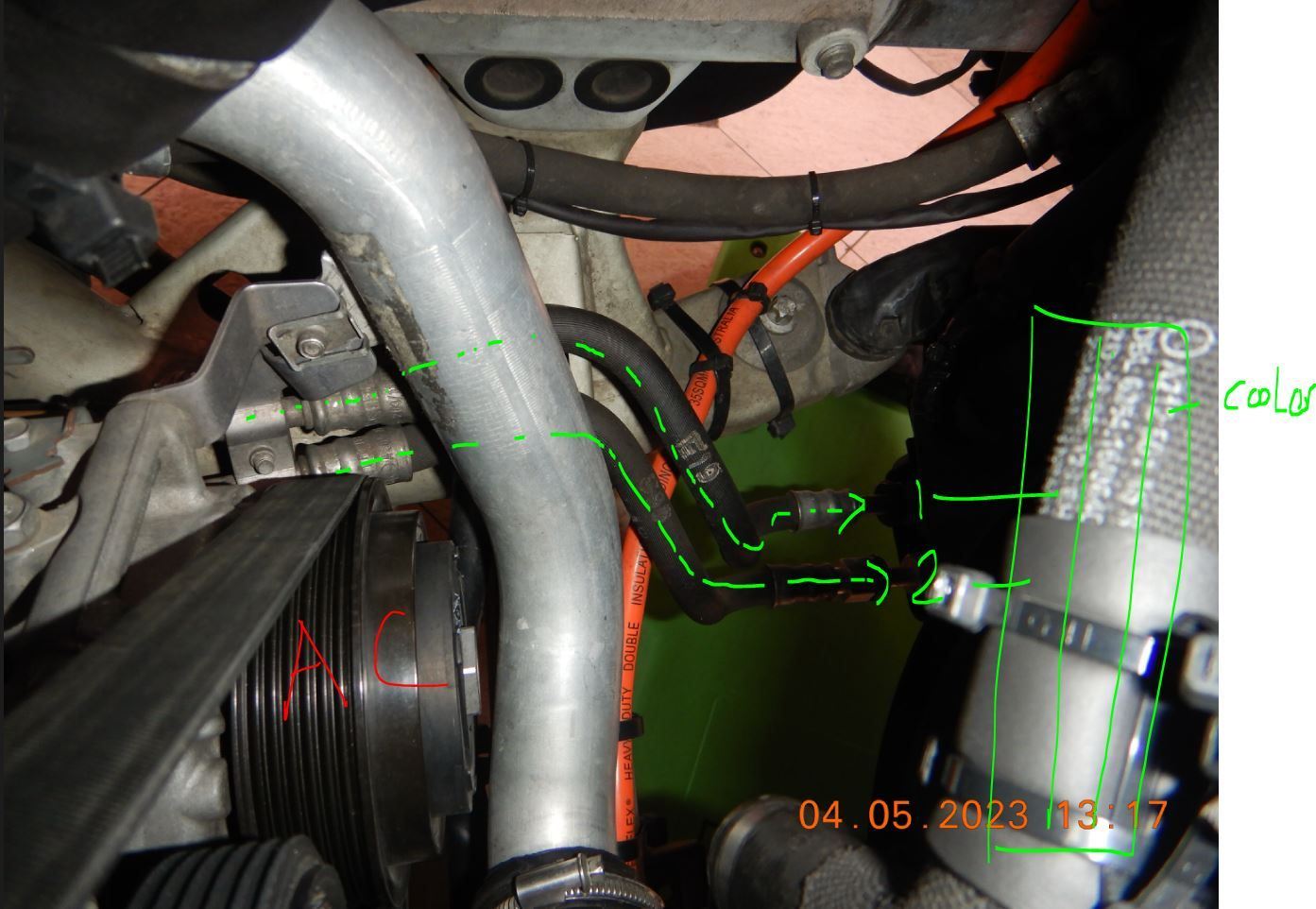

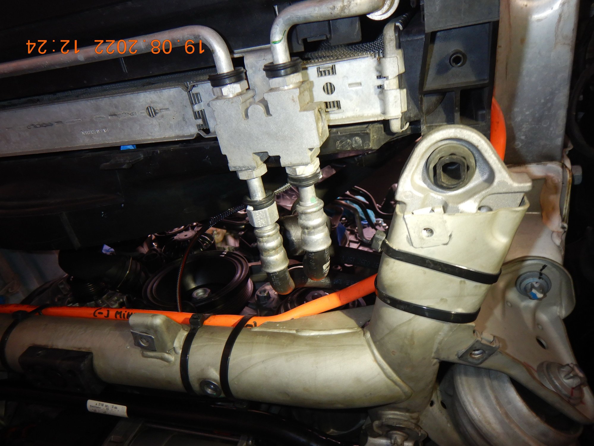

Here is some photos archive when I tried document the tranny oil hose routing for my engine, but hopefully it may give you some idea where the tranny oil pipes+hose routes are for your car, would be similar.
Starting from the tranny to the oil cooler, via AC compressor side :
ADD more photos.
The tranny oil cooler manifold , a better view.
