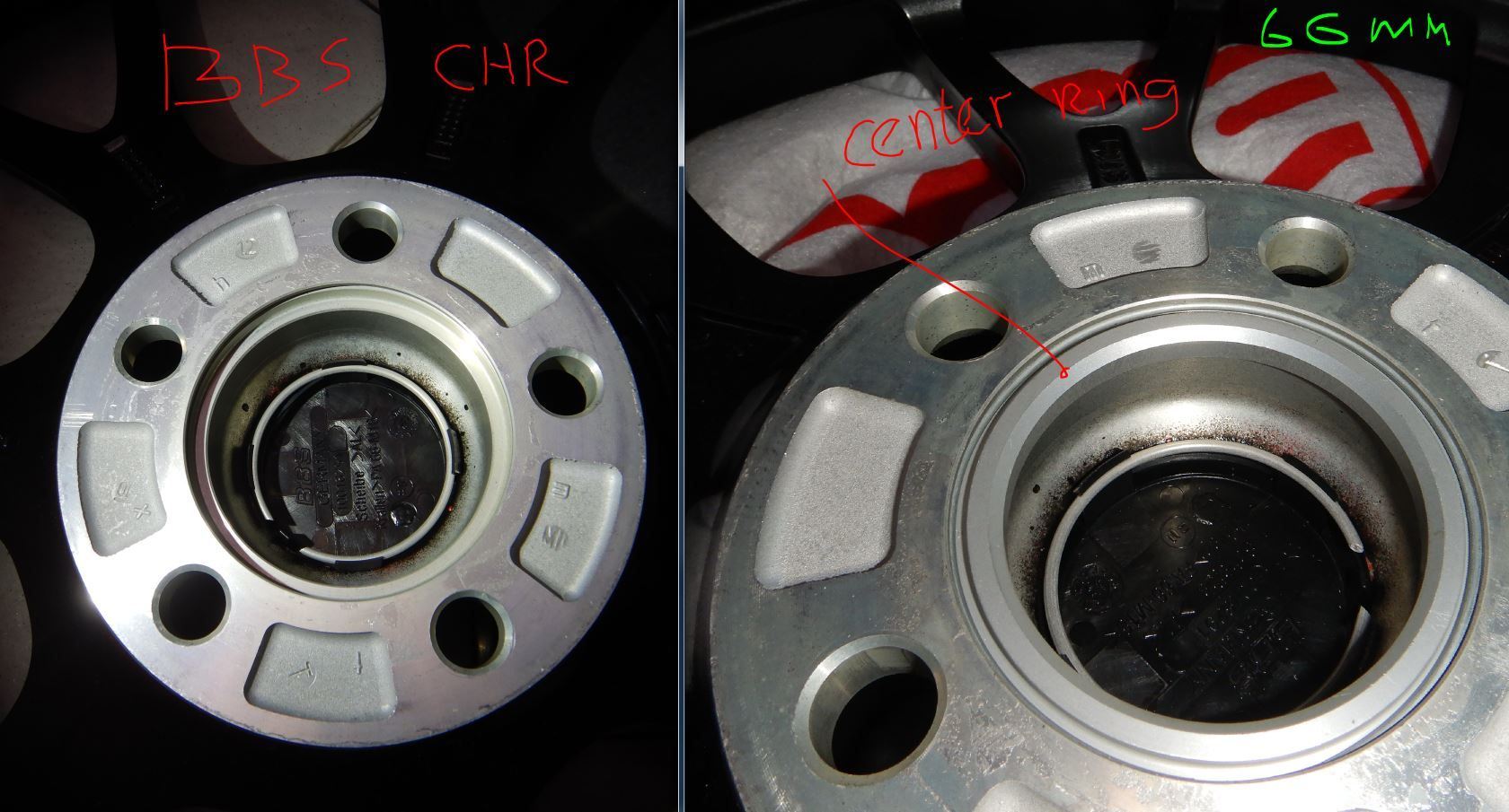

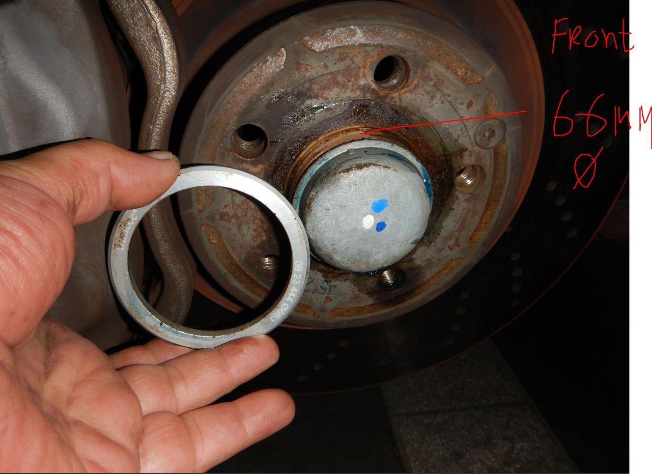

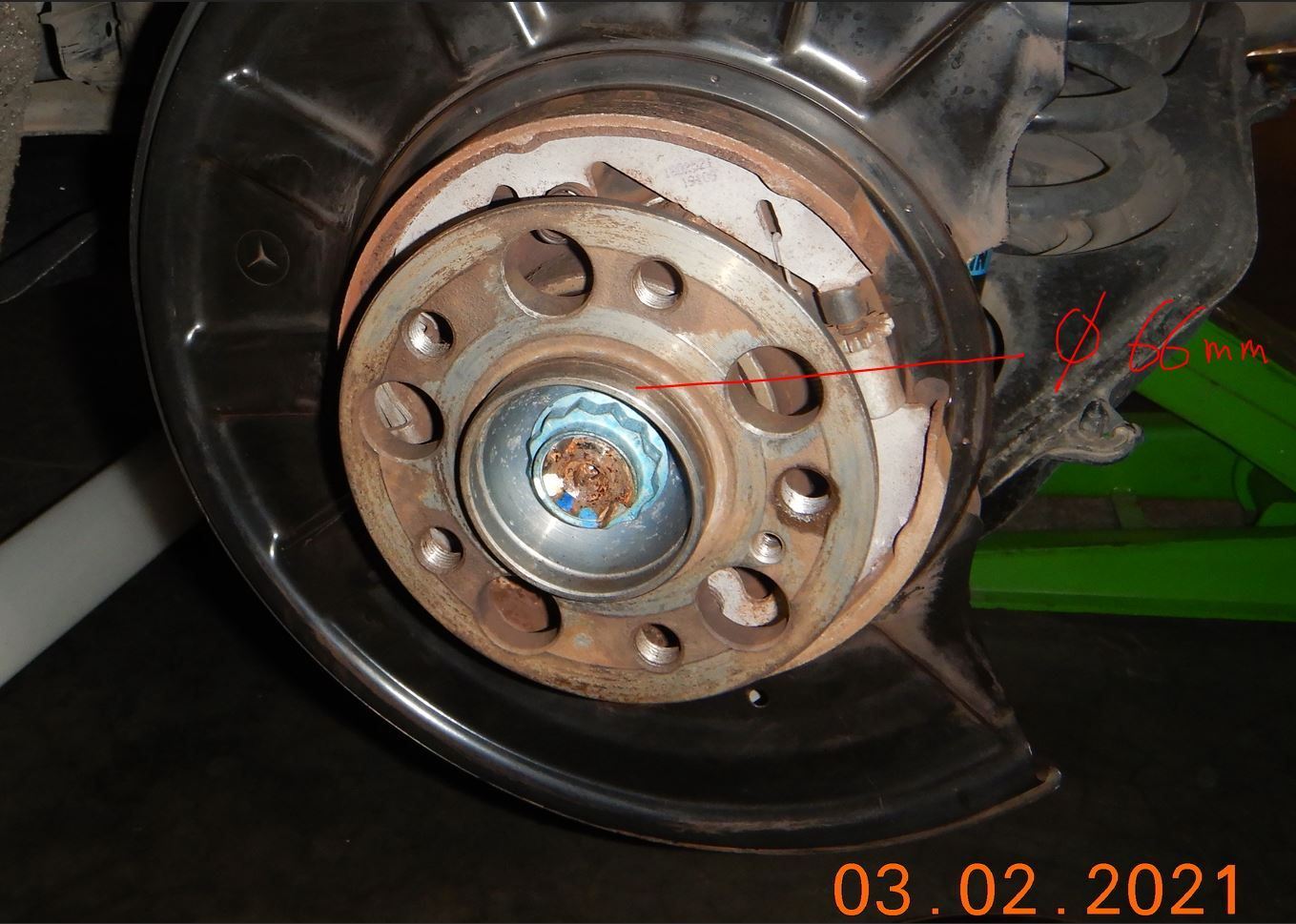

If your car side wheel hub (centering ring) is clean and no damage, it would be a 66mm OD. This value will not change, as it is made and installed on millions of Mercedes.
REAR, brake rotor removed.
If your wheel is made for a few cars model, it will have a bigger center bore then 66mm OD and a suitable center ring of ID 66mm will be provided, machined well, nice fit to accuracy of 0.3mm there about.
So, you may have got the wrong centering ring supplied by wheel seller.
