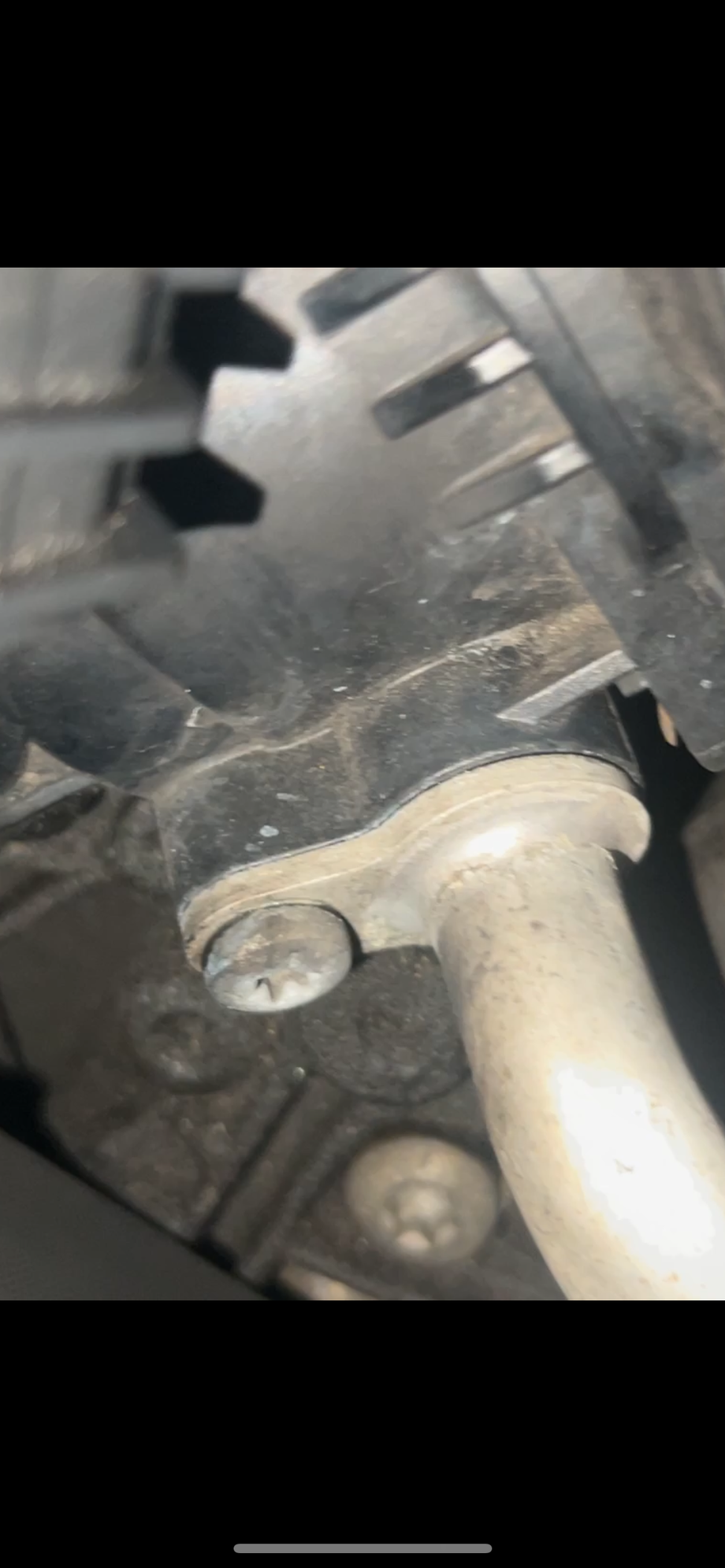

Hello everyone,
I rounded off this bolt that connects a coolant line to the thermostat. Does anyone have a part number or the size of this bolt? It fits a T25 torx bit.
This picture was taken before I rounded it off

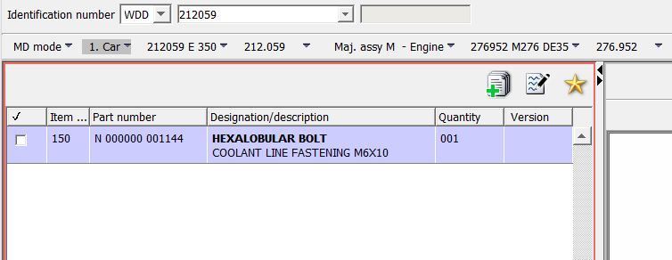

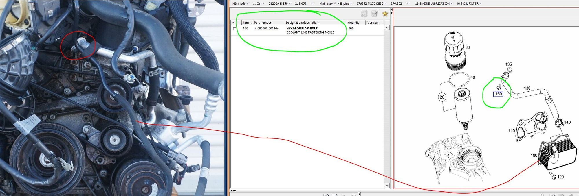

Ohhh that is how M276 oil cooler pipe/hose is like
P/N is
N000 000 001 144 M6x10mm

Yes, EPC sometime is whacky for where it "park" the components.
