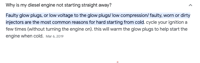

OK, that's crazy. Is your car an automatic or manual transmission? I noticed your feet did not move. You should have to apply the brake or clutch to start the car. The car starting "on its own" like that seems to be a hazard. I'd hate to be checking under the hood when that happens.
I found this: https://www.quora.com/Why-does-my-di...%20when%20cold.
But in your case, the engine doesn't even turn over until nearly a minute has passed. Therefore, something in the electronics is keeping the engine from starting. I'm beginning to think that there is a bad temperature sensor somewhere. Or, since this is your first winter with the car, it may have always acted this way when cold. Definitely get yourself a Mercedes-specific scanner. I recommend the LAUNCH Creader Elite BENZ 2.0. About $150 USD on Amazon in the United States. You need to see if there are any codes.
EDIT: I see you (or someone) has a LAUNCH scanner. Your codes can easily be associated with a weak battery or faulty grounding. However, the video is showing a different problem. Do ALL the codes come back, or only some codes?
You may actually need to scan your car with XENTRY since even LAUNCH is not 100% accurate with Mercedes, but neither are any third party scanners as good as XENTRY. You may want to go to an actual Mercedes dealer or reach out to @BenzNinja to diagnose your problem.
