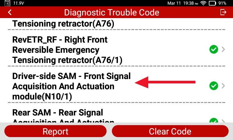

First topic of business is to update all the software, including the MB/Maybach software to REQUIRED version v50.26. This reader has onboard WIFI, so the update is easy while sitting on the couch.
Once updated, connect the provided OBDII cord to the OBDII slot under the dash in your car to the left of the steering wheel. If auto search VIN is enabled (recommended), the Launch Creader will ID your VIN and then run a full diagnostic of your W212’s system. I recommend clearing all DTC codes identified (prompted) before proceeding.
The diagnostics results page (above) will list all the systems available (scroll down to see them). Look for the “Driver-side SAM – Front Signal…” Touch the RIGHT arrow on this line to reveal the next page… Caution: The Front SAM contains dozens of programmable features. Be very careful in navigating the options to prevent unintended changes.

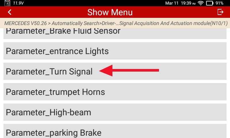

Scroll down and touch “Parameter_Turn Signal” then…

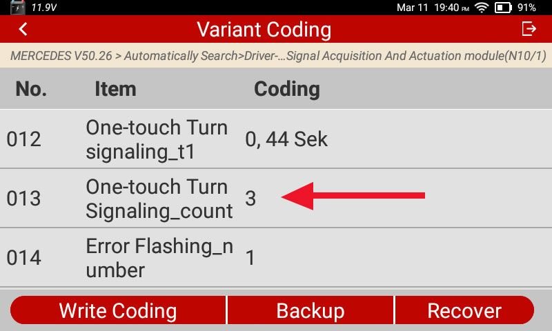

Scroll down to “One-touch Turn Signaling_count” In my car. It’s line 013, but may be numbered differently for yours. Notice the default value of “3” on this line. Touch this line to reveal a drop-down screen to select optional values.

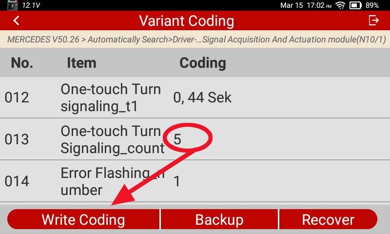

Find and select the desired count “5” then after the value updates to “5”,
on this screen, verify that "5" is selected, touch on “Write Coding” in the lower left.
Test that your one-touch results in 5 blinks. You're done!

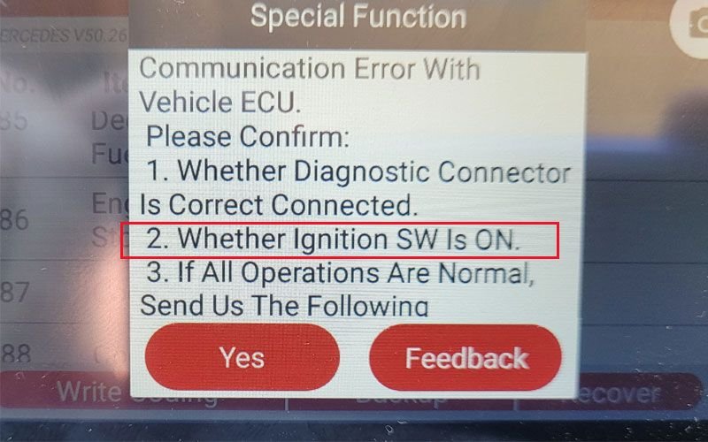

Good comments. So, when I encounter this screen trying to write (for the ECO Start/Stop) what specifically does this boxed comment mean? Please clarify...
1)That the ignition should be in Pos. one only (engine not running), or
2)That the ignition is On and Engine Running only (pos.2)?
I mean I understand you are not asking me but I believe it means Position 2 but do not step on the brake when you put it there, you should see all the lights turn on and engine stayed off.

Correct. Usually, if the engine needs to be running, the instructions will state so. Otherwise, ignition ON means position 2 without starting the engine.

I see, ya that youtube video should help out but it is correct the LAUNCH V2 is able to reset the service reminder/interval (ASSYST PLUS)
