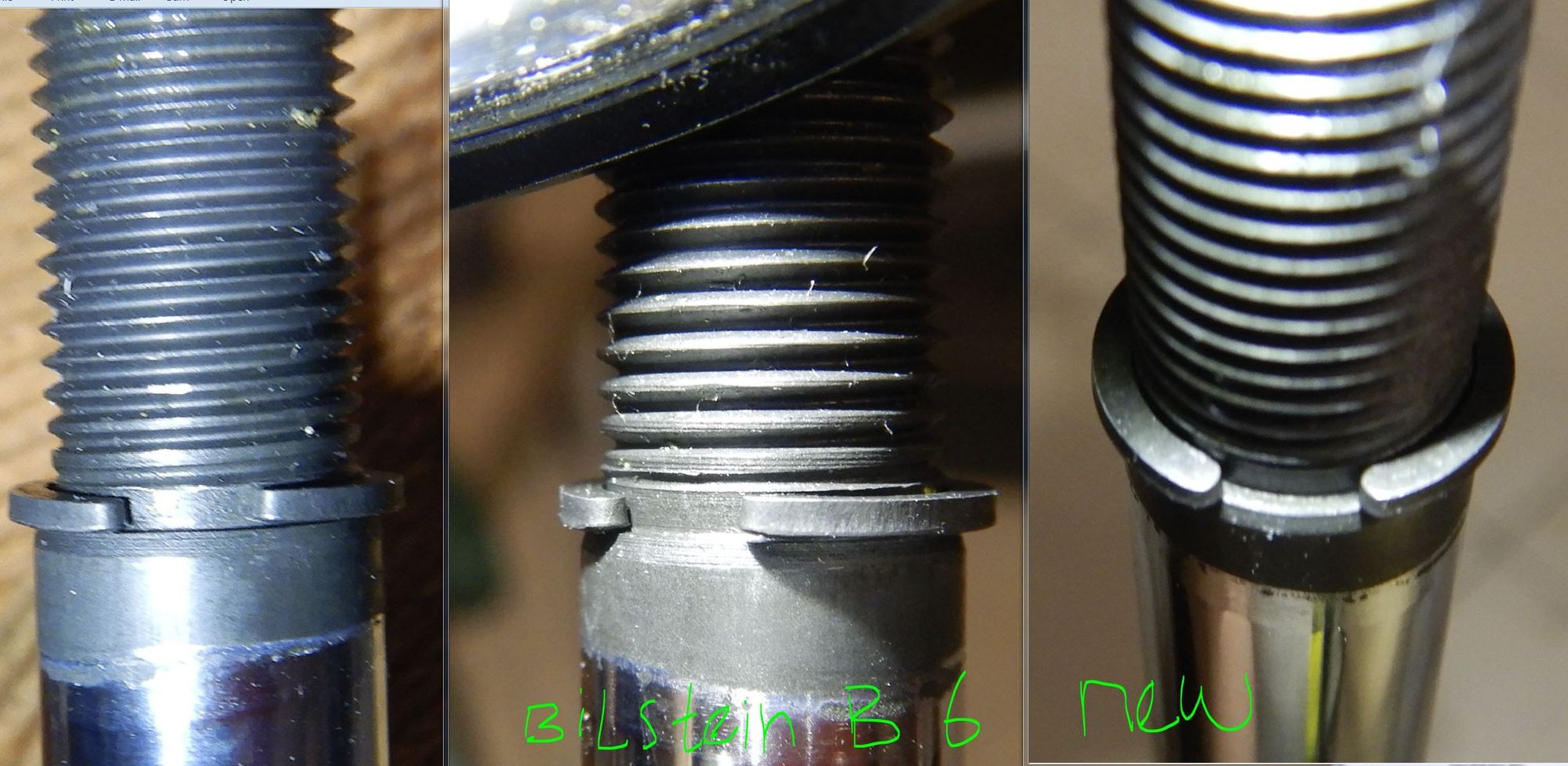

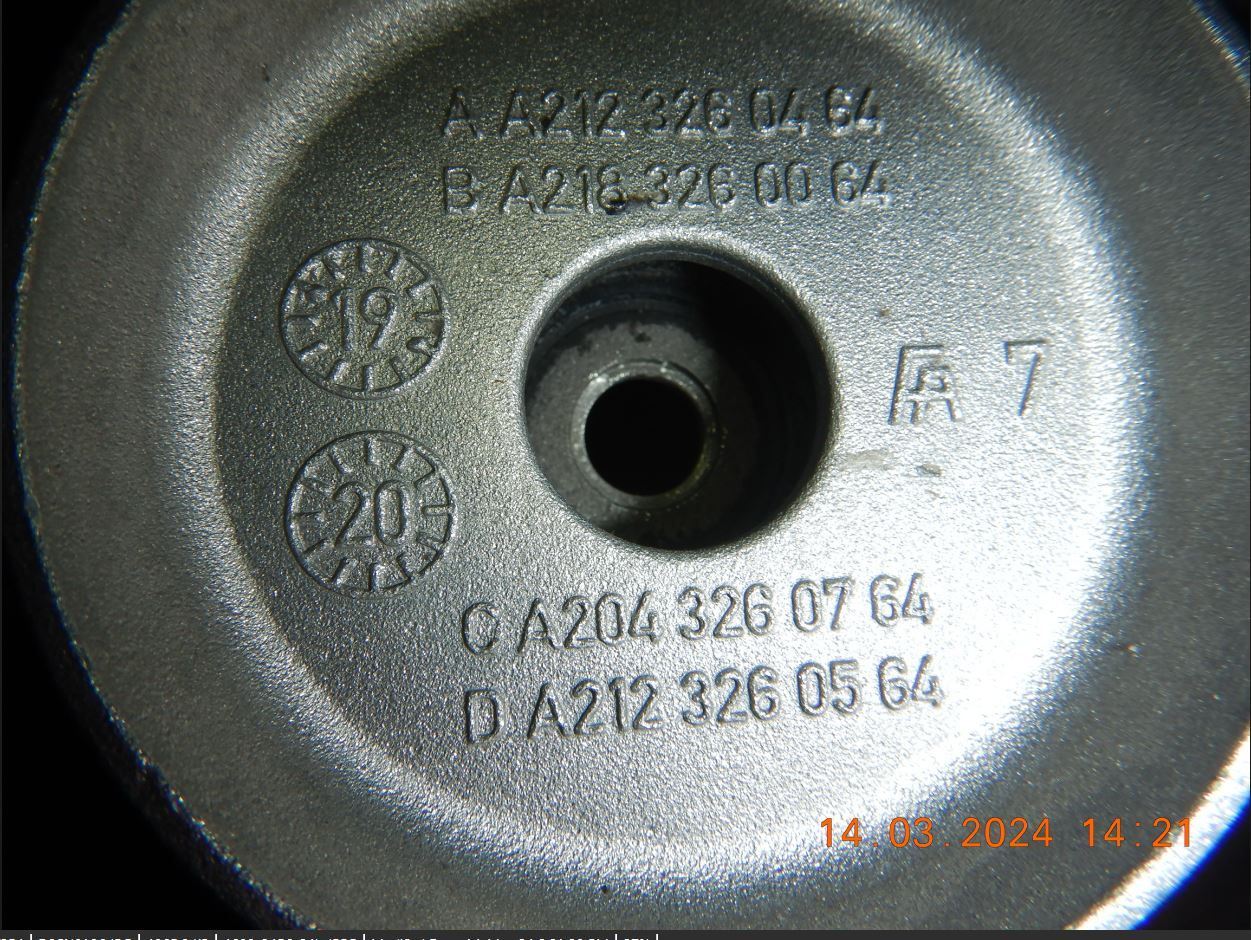

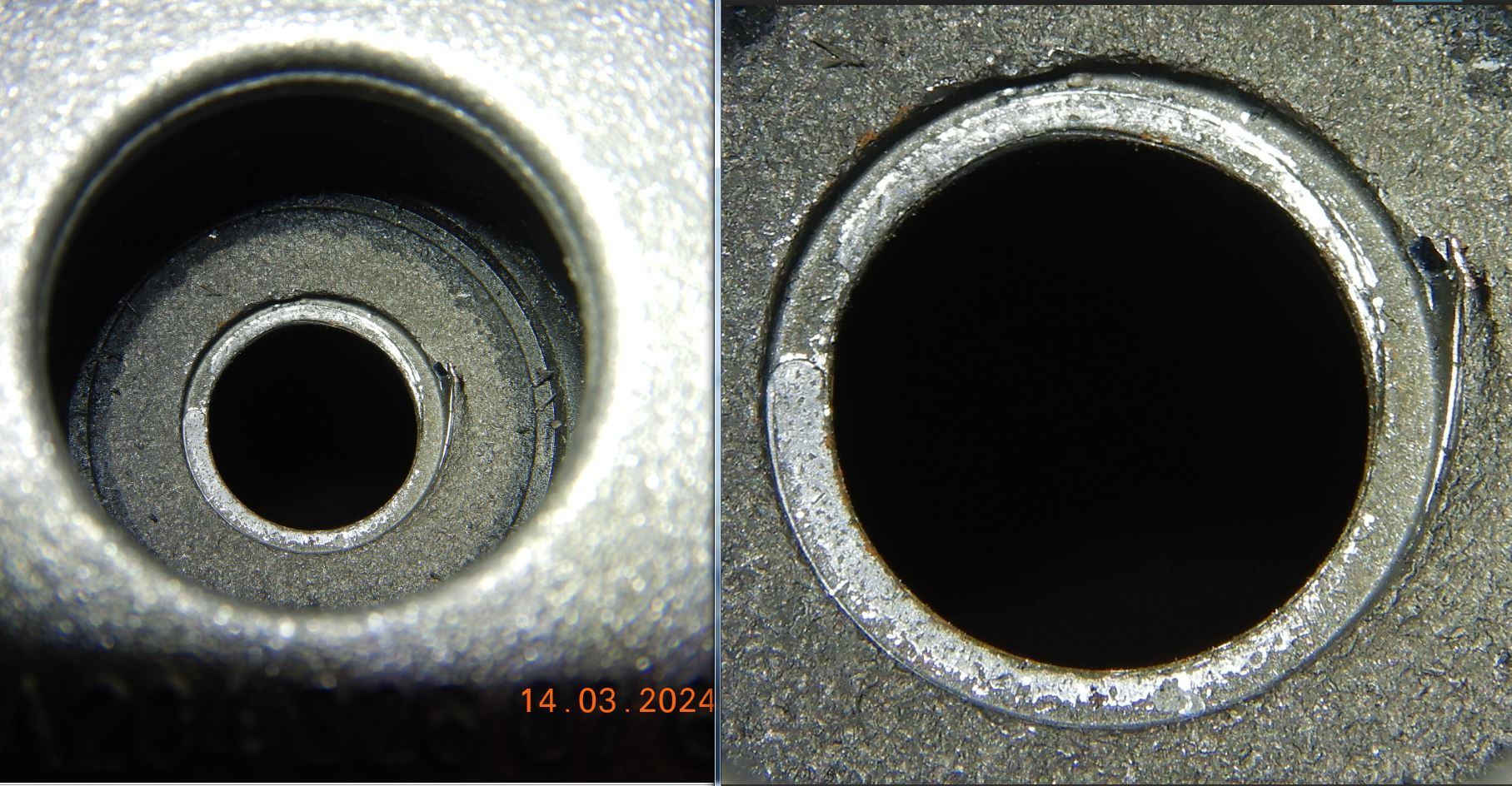

I think GRB can answer for us, when he used the boring bit to remove 0.5mm metal of the C-clip recess, he would be able to tell if the Lemforder recess is as square and as flat as MB ones or not,
I mean from the machining marks slowly the cutter eating into the recess....which part of the recess got cut first.
I can't even measure it with my caliper, too deep.
I do not like that funny grey-ish coating Lemforder uses and so happened it also got "sprayed" into the C-clip recess.
I measured the C-clip contact surface area vs the damper piston. The C-clip is only 2mm bigger at 12mm compared to the piston shaft OD at 10mm.
So only 1mm area the C-clip circumference can contact the recess at the damper top mount. It so small an area for a working force or resistance of approx 22-25KG ( I pushed down damper ) of load.
That is why I do not like how Lemforder C-clip recess looks like. Poor dimensional accuracy and surface finish, is what I can describe it.
GRB being a pro machinist , he can explain better.
It will take at least 1,000 miles to see the damage of the C-clip and the damper's piston area which holds the C-clip.

So what I did was just barely touch the OD of the recess (.002 thousands of an inch) and remove the radius in the corner and . 002 off the face where the clip sits in the recess.. I used a boring bar with a nose radius of . 005 so the clip sits perfectly flush.. Like 10 minute job to do both mounts... quite simple actually.. Last time I removed shocks clips were still in perfect shape
I also made new clip (washer basically . 02 wider and out of stainless steel
