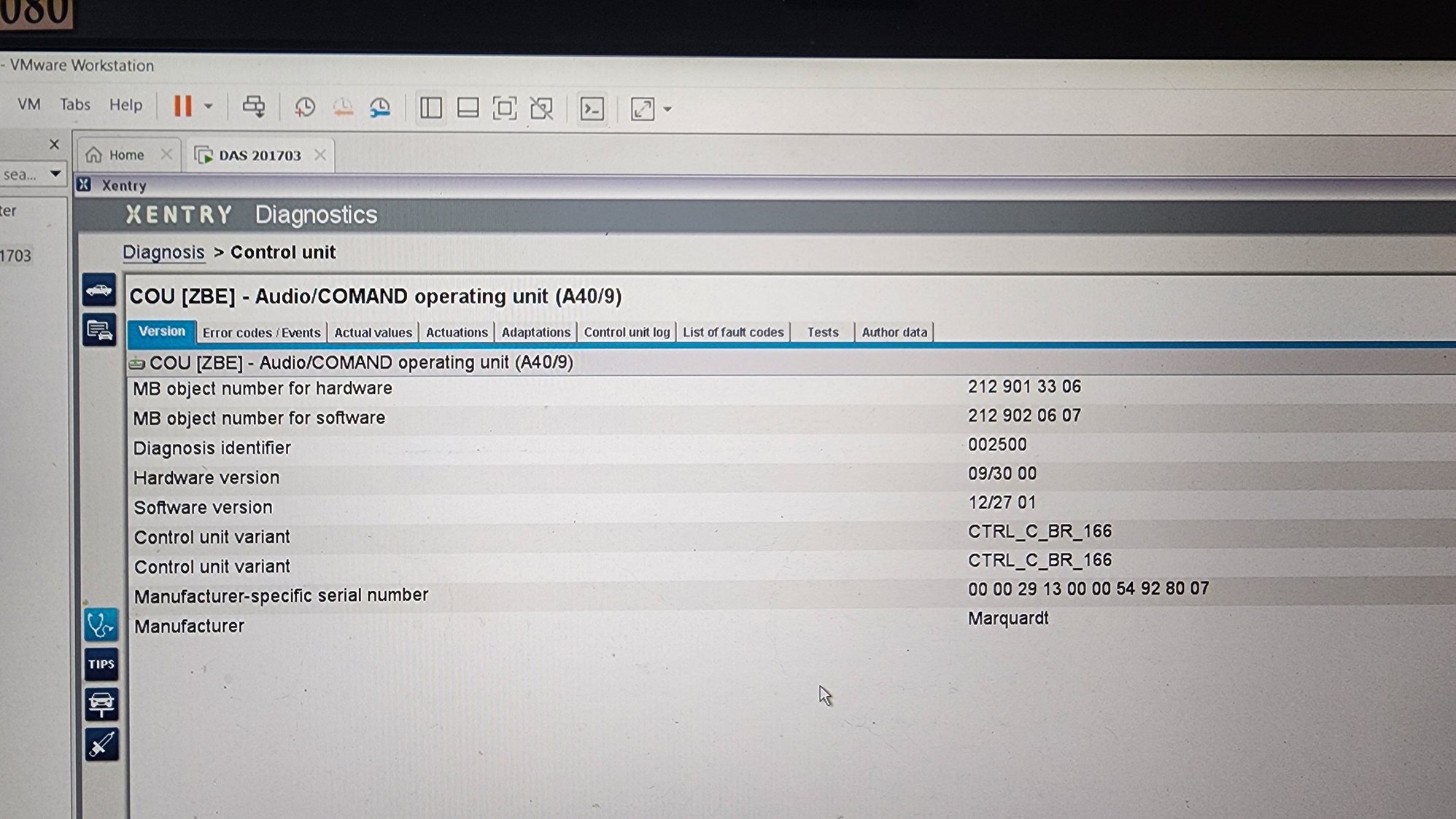

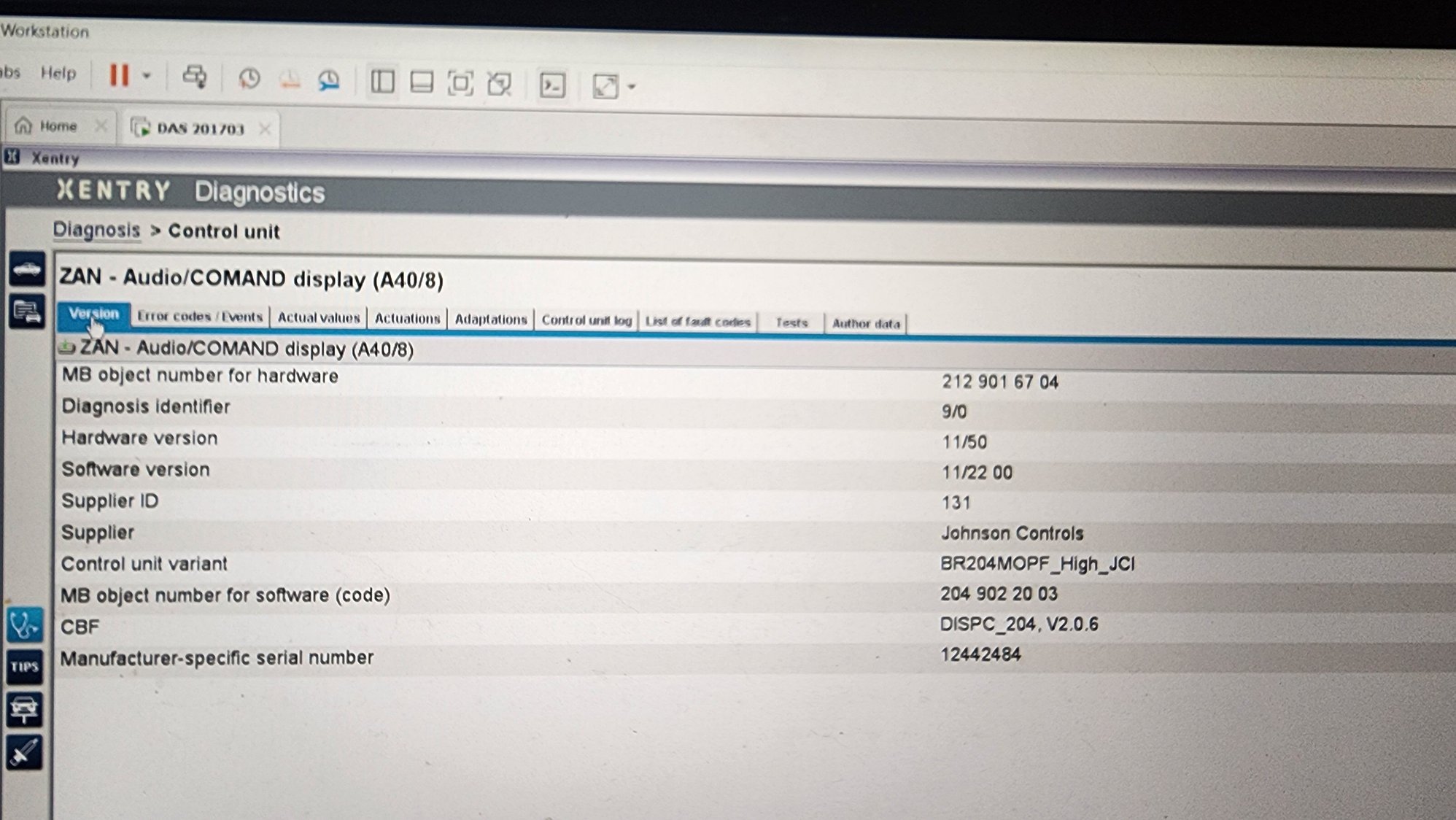

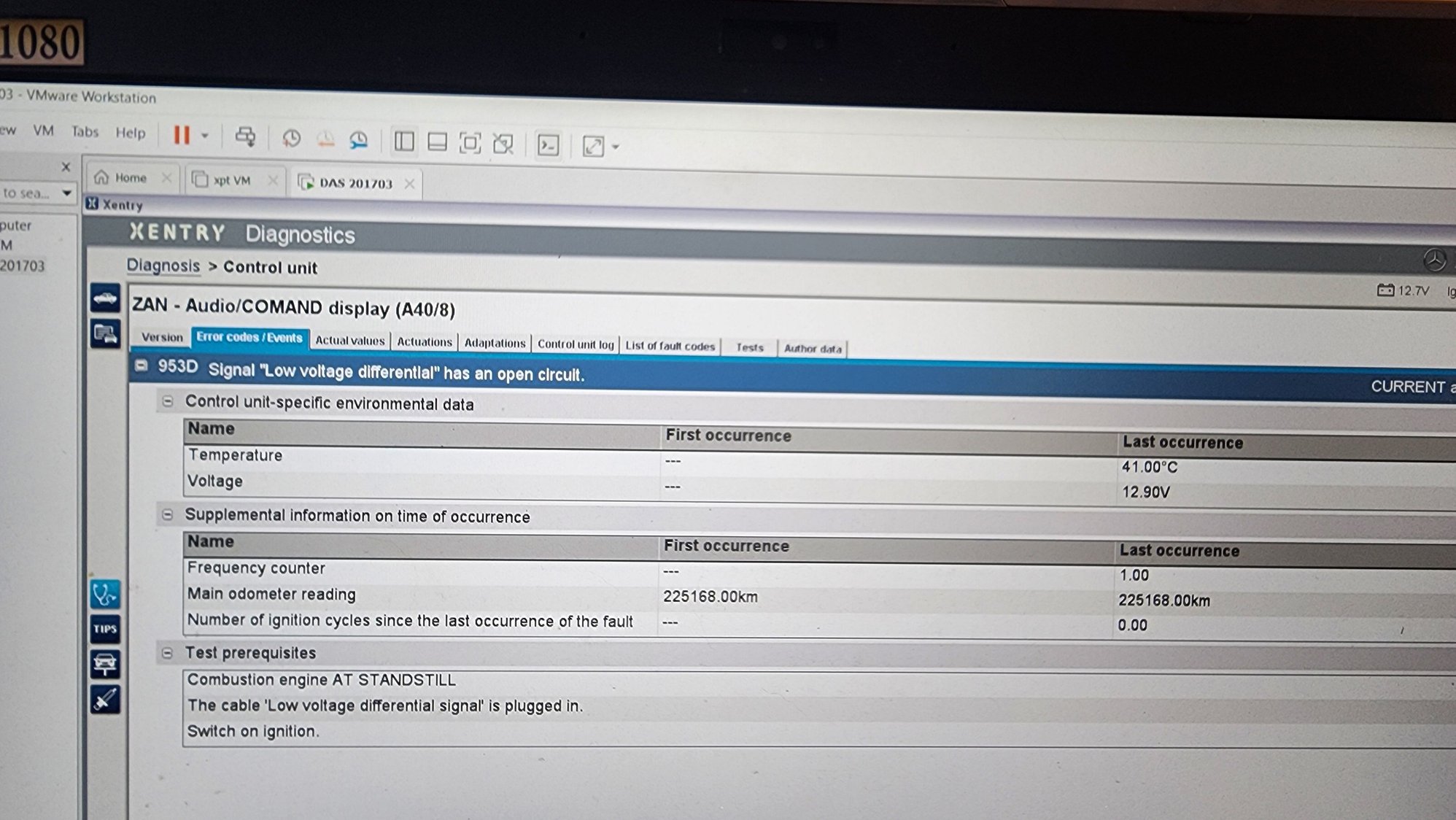

Our 2014 E550 is having a similar issue. I'm able to connect to both the head unit and display, even though neither is functioning (no audio or image on screen). I see all of the OEM headunits are listed as backordered, and a remanufactured unit is available at our local dealer for $3500. I'm not sure if anyone has experience with these faults, but the intermittent nature seems like a hardware fault/solder connection.
Last edited by Turboaction; Jul 29, 2025 at 09:10 PM. Reason: Added diagnostic info and photo

these Xentry screens make it seem more of a DISPLAY fault than COMAND itself, right?
Now you can fund what's involved with a diagram.
Both Display + Comand modules are normally soldered to stay reliable.
Has Comand been moved around lately to cause a bad connection?

It's a strange issue for sure. It started happening two days ago. There hasn't been anything otherwise unusual with the car. Both batteries are about 2 years old, and the alternator is charging normally (max voltage of ~14.4V). Maybe this is the time to try installing one of the Android displays?

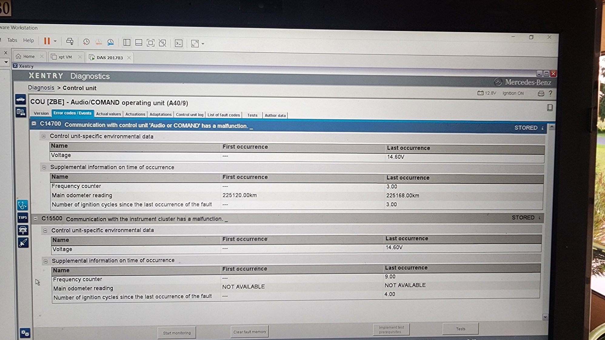

Oh boy, has it been a day. I spent some time on Xentry and can't get the head unit to turn on (flashing ON button). Only the display has a fault (953D Signal Low voltage differential has an open circuit), aside from the mbrace module having a fault for the audio cable for muting having a short circuit to ground. I'm not even sure where the audio can be muted on the car besides the steering wheel and head unit. Is there another location that has mute wiring? I plan to check wiring diagrams next to try to see where the display wires are actually routed.
I tried starting the COMAND with the display removed, but the display in the dash doesn't show the nav/audio system as active. I'm not sure what's required to get the COMAND system to start. Next I'll check the fuses in the rear fuse box/SAM, but I wouldn't think any of those would affect the audio. The COMAND is reporting good voltage, and all of the connections are securely attached. I also said HI to the mechanical hard drive attached to the bottom of the COMAND unit.
