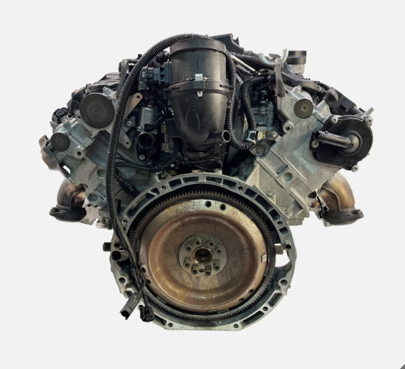

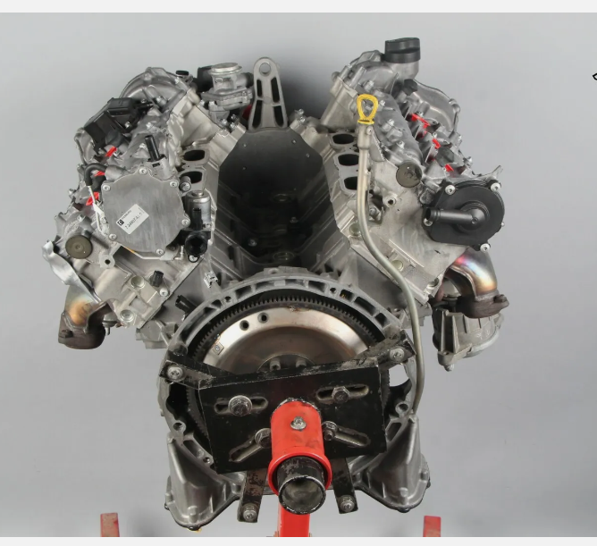

Not all M272 are the same
Here is the rear view of which I think yours looks like -> M272.977
and this is the one you seem to be expecting - > M272.972
Welcome to the MB LEGO game,
Ah thank you very much. Now I understand!

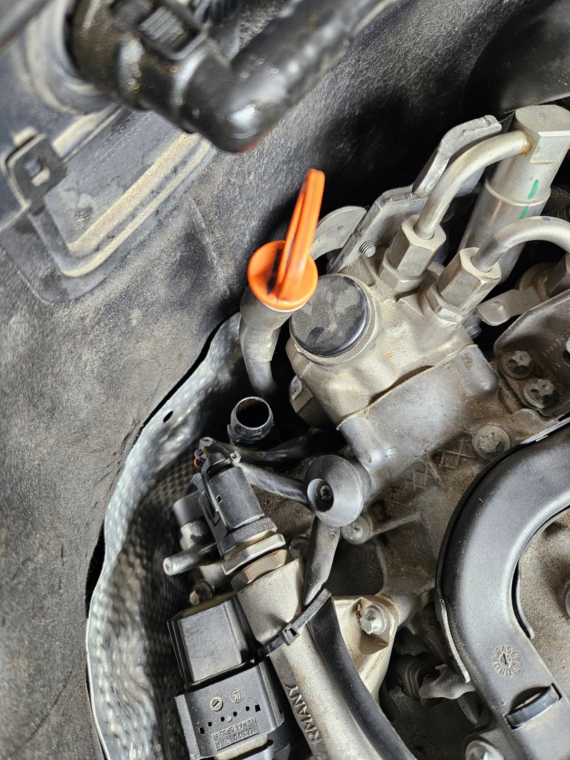

Was trying to change the PCV, and it looks like a piece of cake on the videos I have seen of others doing it on the M272, however the space around my PCV is too freaking thight to work on even with the smallest tools. I hate the fact that I can"t do a simple job like this myself because of the design on my particular M272. I tried to upload a video, but it did not work.
Totally agree this simple service qualifies as a PITA... besides HPFP must also come out
A possible help is to lift out the fake double-firewall to gain better working access.
Replace new HPFP + Roller is recommended but not mandatory... at least roller bearing is cheap and good insurance to preserve camshaft from grinding flat.
