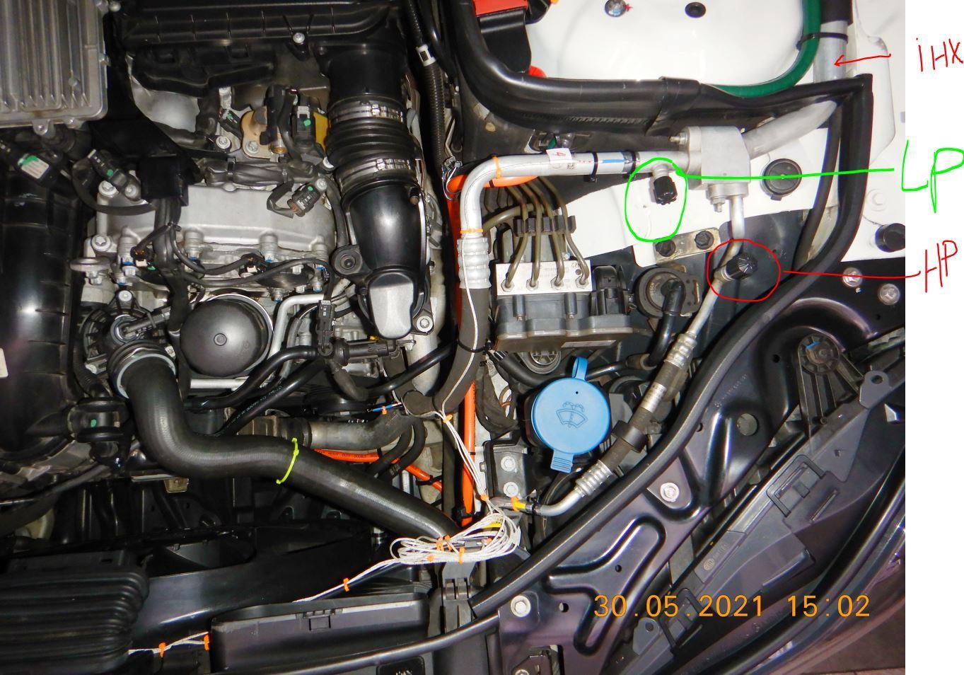

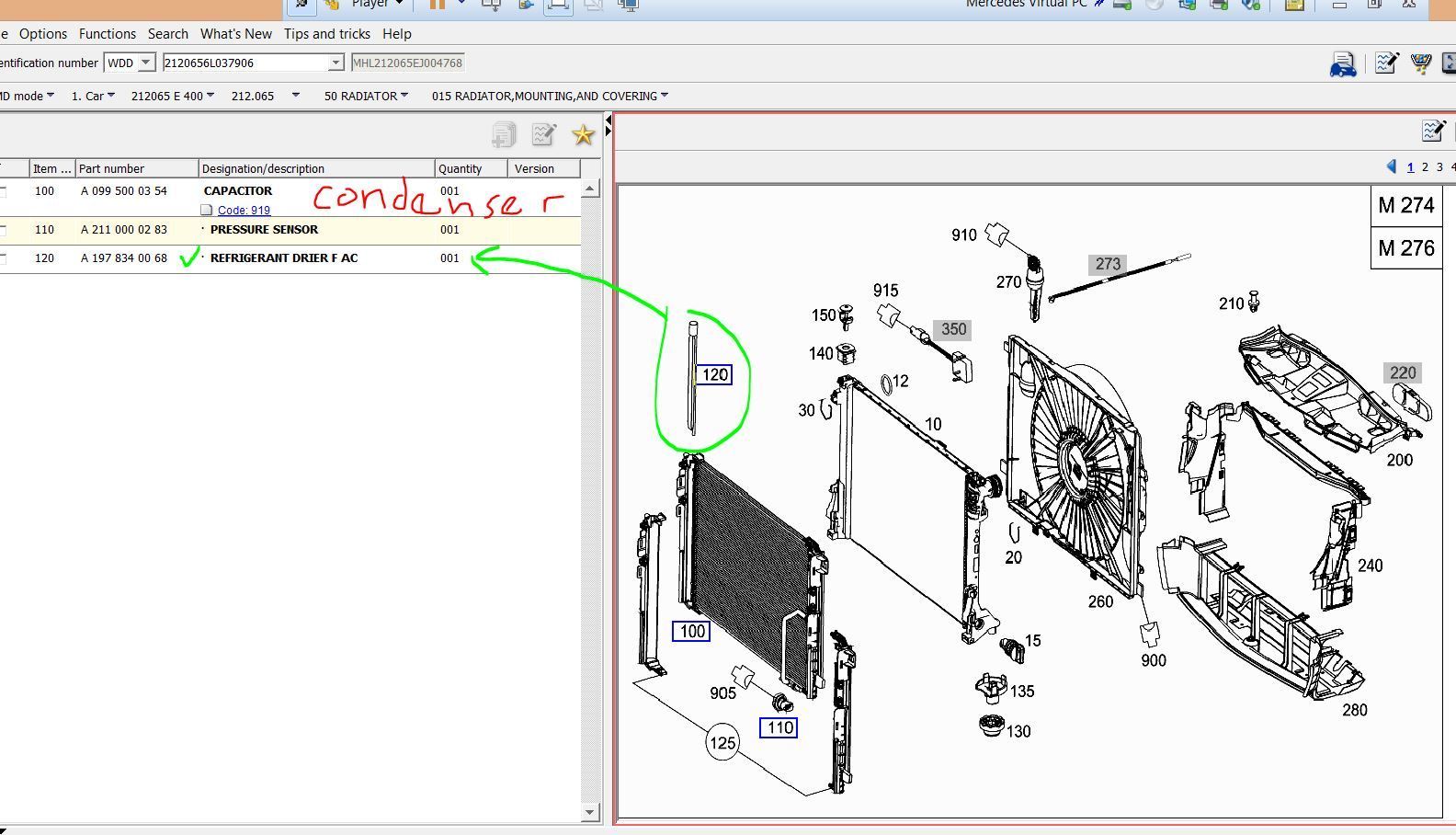

Where can Leak points be :
AA. Compressor has input and output port. Both uses O-ring at its hose ends. 2 locations.
See all o-rings in blue circle in image below.
BB. Condenser has input and output port. Both also uses O-ring. 2 locations.
CC. Depending on model year, your HVAC may have the IHX, Internal Heat Exchanger pipe system, that means another leak point from extra o-rings. 2 o-rings

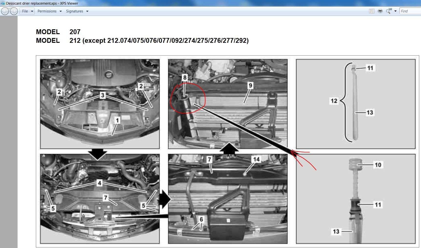

DD. Suction or Low pressure hose and High pressure hose has schrader valve each, they do leak when they aged . 2 locations.
Item 5 in green in below parts image
EE. Refrigerant pressure sensor, its o-ring can fail and leak. Item 6 in green in below parts image

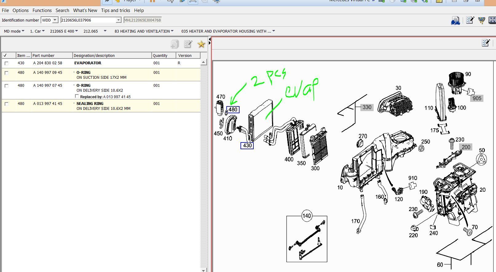

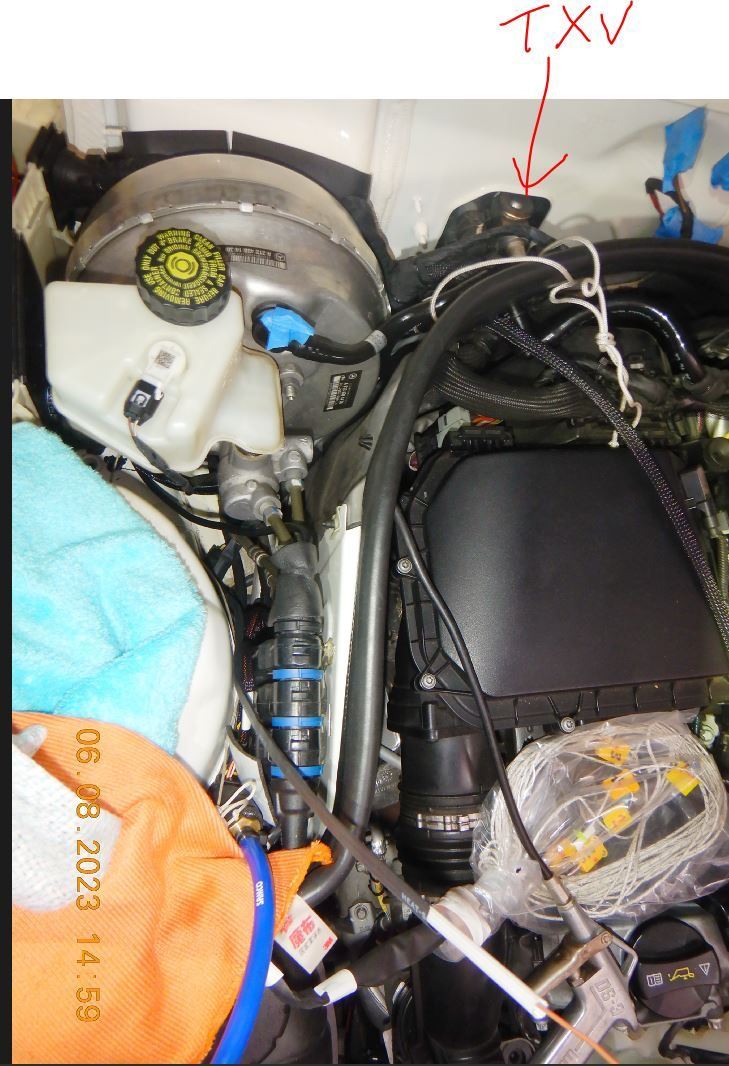

FF. The TXV valve attached to the evaporator can leak from its hoses o-rings. The TXV itself uses 2 o-rings to mate the EVAP alu pipes.
I am using my car as example, yours maybe different a bit :
GG. Condenser aluminum metal ( core ) can leak from stone impact, as condenser is the very first layer in a car radiator system.
HH. EVAP aluminum metal ( core ) can leak too from corrossion, if your EVAP is never cleaned properly and harbor dirt and whatnot and you live near the sea aka salty air. Evap exterior is always wet you see.
Seek a true HVAC professional shop please.
This is not a DIY job.
Pray the leak is not at your EVAP, because I will cry too when dashboard complete tear down must be done.
PREVENTION-MAINTENANCE can go a long way.
Speaking of PREVENTION-MAINTENANCE, that is a long topic for some other days.
Good luck.....

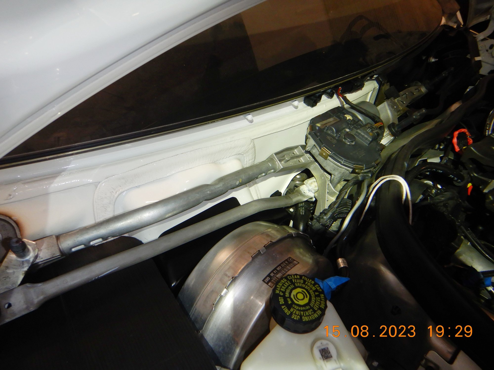

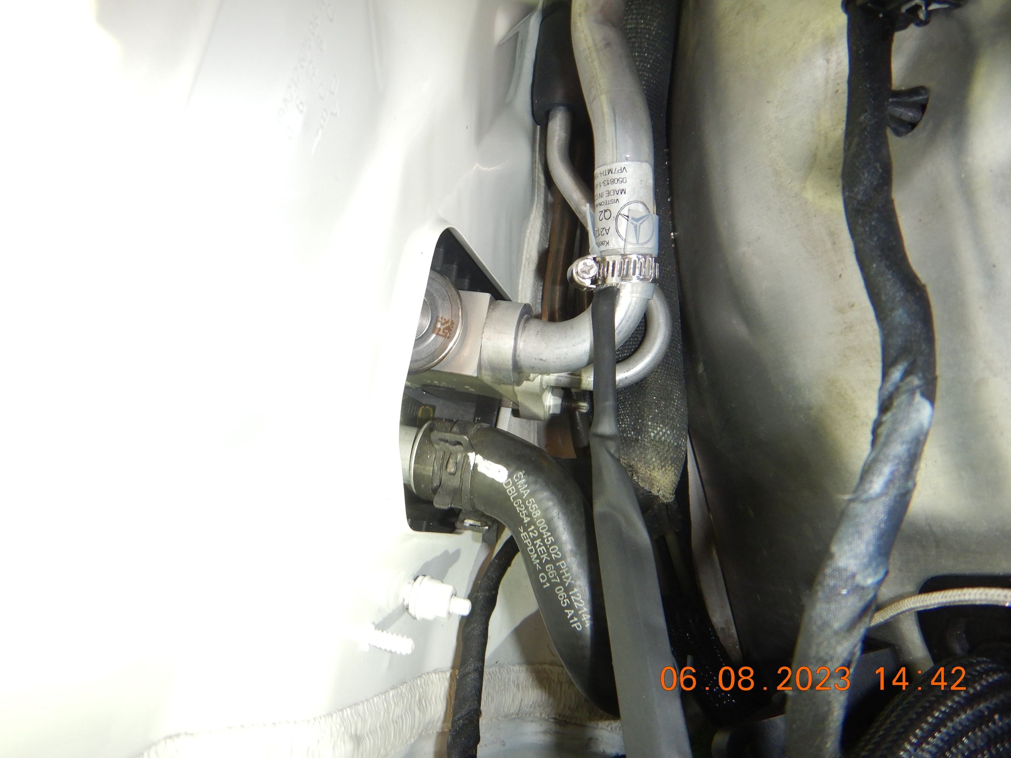

I assumed TXV O-Rings can be checked without removing the dash
YES
Here is a sample
My car is RHD, yours is Left-Hand-Drive.

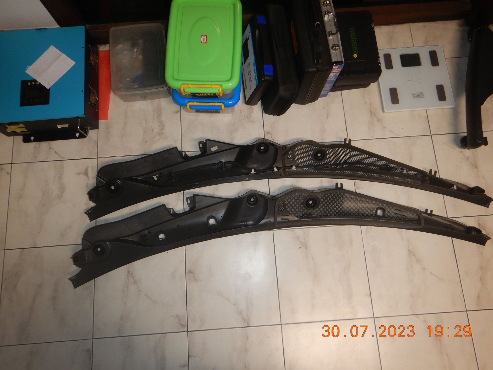

Remove the plastic tray/cowling of wiper and remove complete wiper system. You can then access the TXV
Wiper tray or plastic cowling.......
How to remove wiper plastic cowling/tray

2- he has checked the condenser unit near the radiator as well and has found no leaks or issues, is there any other part here that could affect the leak
It is not easy to find a leak if by visual only on condenser. The leak could be at the engine (rear) facing side and not bumper (front ) facing side.
There is a filter drier cavity where it has o-ring too. So it can leak from there too. Anything using o-ring, will eventually leak.
Yes funny name CAPACITOR for Condenser.
3- Apart from the cost I am not keen on getting the dash removed and my mechanic has said he can service the compressor motor, refill the gas refrigerant etc and it will work fine for another 3 months… so does it make sense to this every 3 months?
Your R134A fill would be approx 590 grams for a sedan. Must check MB WIS or the sticker at the engine bay.
If you loose more than 25%, that is dangerous for the compressor oil to not be able to tag along the refrigerant to circulate back into the compressor.
There is nothing to service for the compressor, not if it is not DEAD/DAMAGED yet. When damaged, your replaced more than just the compressor if the debris has circulated.
The EVAP need to be clean, hence the paper filter must be replaced maximum per 2 years, depending if you like using OUTSIDE air or
CIRCULATED air. If car is clean inside, and like me always using CIRCULATED air, the filter wont be dirty even in 3 years, but the activated charcoal inside it will be "wet" saturated and cant capture smell well.
In a proper sealed system and very dry to begin with, the compressor oil will last easy 15-20 years, but the shaft seal of a compressor will leak annually 8-12 grams of R134A, more if the engine is not run often.
The compressor oil ( when running ) helps the shaft seal to be wet/lubricated and more gas tight.
Condenser need to be clean at its fins ( exterior ), otherwise the compressor will overheat.
He estimated 3 months it will be OK when charged up again with R134A to proper fill, is simply an estimated guess. 3 months from now he will know how many grams you will loose the R134A and he can make adjustment.
But this is only true if the leak is not getting any bigger and at area where the leak will not make your compressor oil also depleted.
Take a paper towel, access the High Pressure (HP) port, the thin pipe ( liquid pipe ), press a bit on the valve and let it stain your paper towel with compressor oil and R134A. Smell it, that is the smell of R134A and the oil.
If you smell the same in the car interior with HVAC running using CIRCULATED air, you very much likely have EVAP leaking at its core/metal and the R134A smell will be strong.
It smell like a hospital clean room, ether kind of smell.
Use a boroscope and see how dirty is your EVAP.
Sometime leaky EVAP can be seen, as dirt spot....dirt like to stick to the leaky part due to it surely having compressor oil trace.
I hope your mechanic HVAC RRR machine is well maintained and has refrigerant identifier and he has a stand alone micron gauge ( ultra high performance vacuum gauge ) and use it PROPERLY at a proper LOCATION.
Poorly maintained RRR machine and without refrigerant identifier can be a disaster for you, as the same machine collects all the cars refrigerant the workshop work on and
charge back to your car. So if the previous car has contaminated refrigerant, you too get the bad luck.
If his machine is capable of yf1234 new refrigerant and a dual system R134A / yf1234 and is SAE J2843certified, it will come with refrigerant identifier.

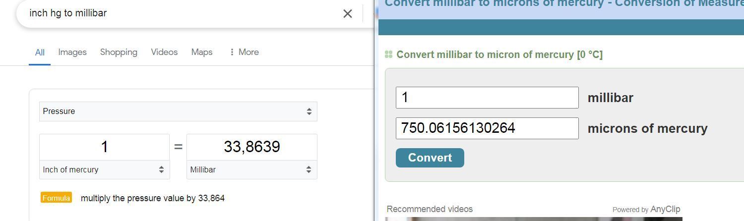

Just so you know, all these RRR machine, the vacuuming power is bad, usually 3CFM or at best 6CFM for newer ones. Often single stage vacuum pump.
Hose too long at 6 feet at least, using the same "wet" refrigerant hose for vacuuming and is a small hose.
Their vacuum reading is at the RRR machine, at its manifold, close to the vacuum pump = BULL-Shiet reading and it is not micron gauge but a simple inchHg vacuum gauge at best,
which is useless for true HVAC work.
See, even 1 millibar is too wet, because it is 750 microns.
Even 0.1 inchHg is too wet.
The car HVAC workshop is a joke. Unless the guy does also commercial units.
See what is the industry/commercial average dryness ( microns ) when doing vacuuming, see Daikin below :
Have fun..............
