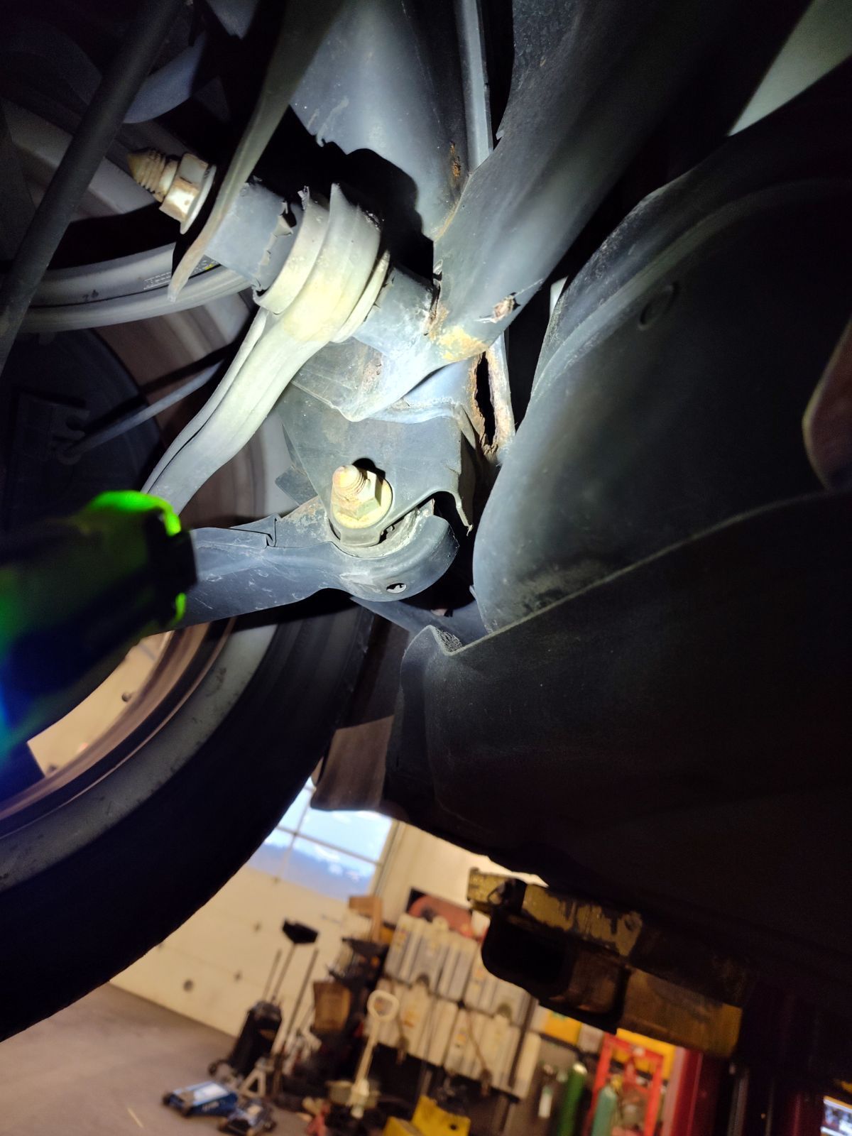

All, I had my 2010 E 350 4 matic with 150 K on the odometer for an oil change. They told me the frame is rusted. I’m looking for the extended warranty that covers subframes.

Thanks for the update. I called MB of Lancaster Pa. they have me scheduled for January 27th with a loaner. The service manager also stated it would only take a couple of days if the part is in inventory. If not maybe a week.
