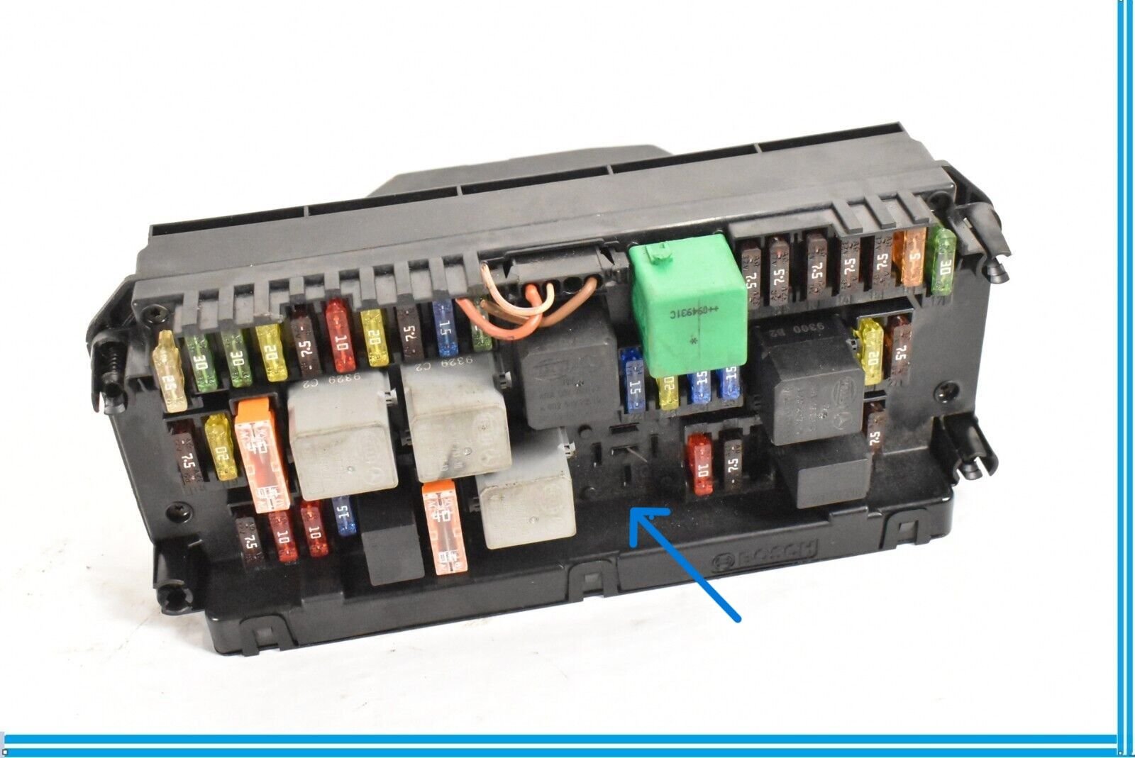

Hello from Toronto, Canada,
I have a 2010 E550 4Matic and was having a problem with the fan. After checking some postings, I checked the front SAM to check relays and noticed that the slot for Q relay is empty. Is it normal? The only time I can think of when someone else worked on the car is when I took my car to a shop for the transmission oil and the starter replacement, and the mechanic might have forgotten to put it back. That was almost a year ago. I am wondering if it is normal to have the slot empty or should I put the relay there since a couple of weeks ago my car went to "P" when the speed was around 25KM/hour (it was also bit hot that day). However, since then the car is running as expected.
Any responses would be greatly appreciated. Thanks.

The big cooling fan for W212 radiator does not use a relay.
It is PWM speed control and uses the big fuse at F32 prefuse block.
Find attached F32 information
