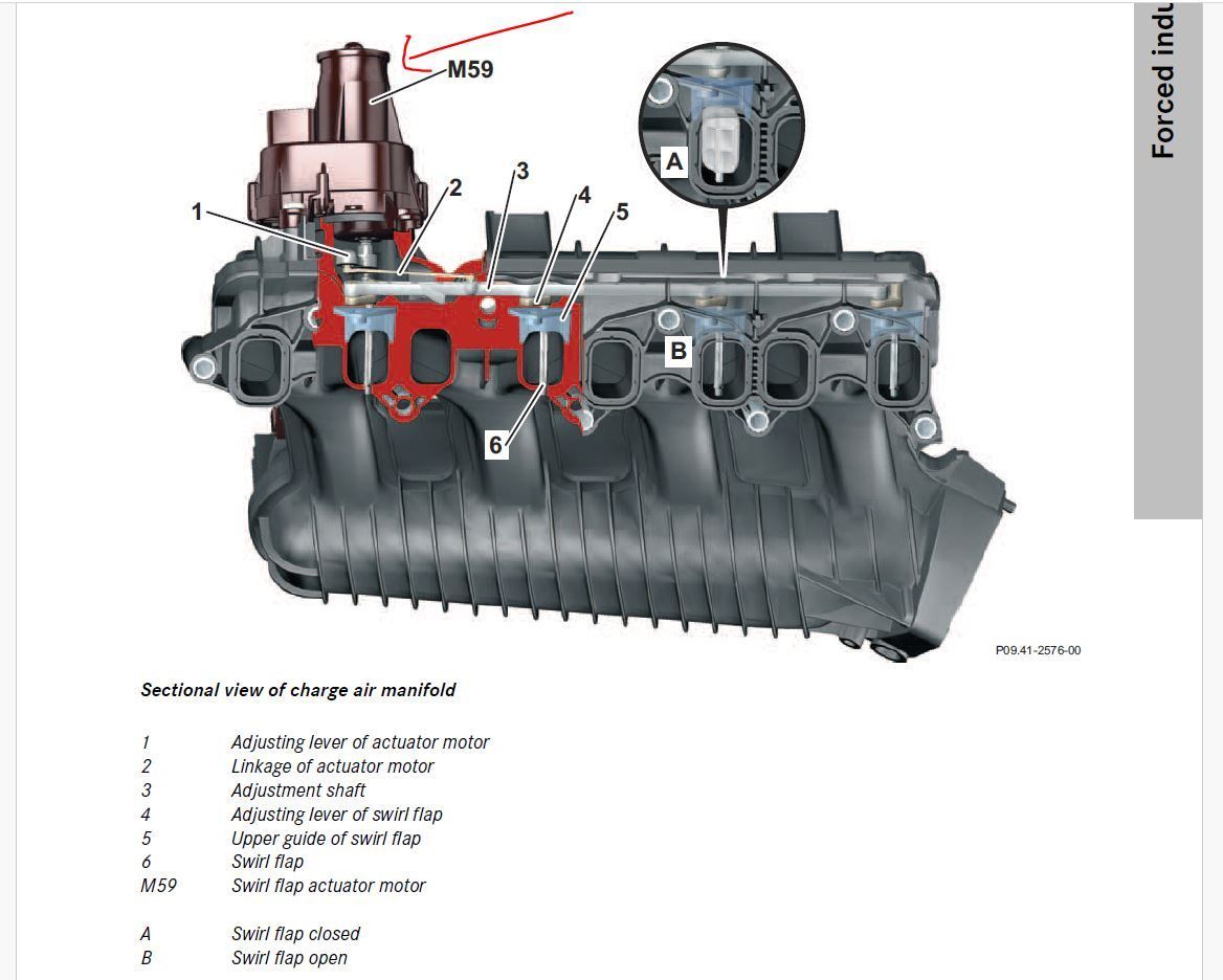

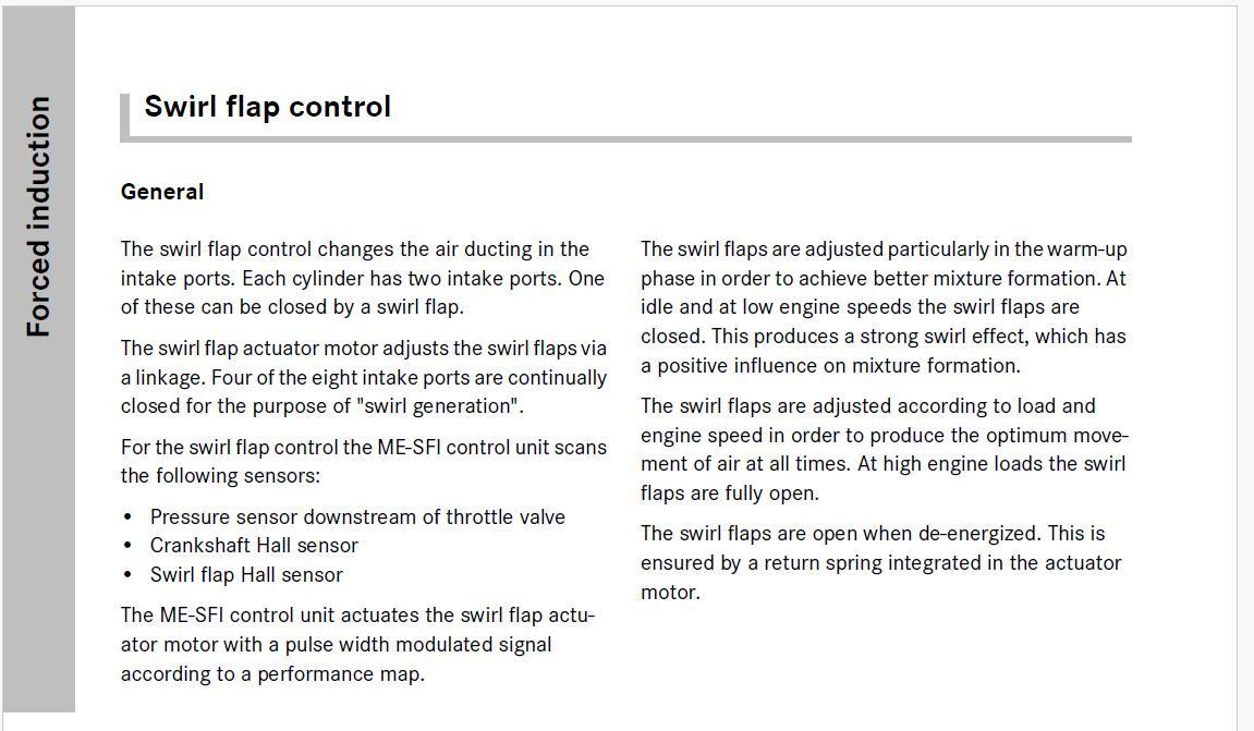

Do a pull to 6,000 RPM, you can hear the roar better.
There is an active intake flap ( swirl flap ) for higher RPM at the intake manifold, thus the sound changes.
