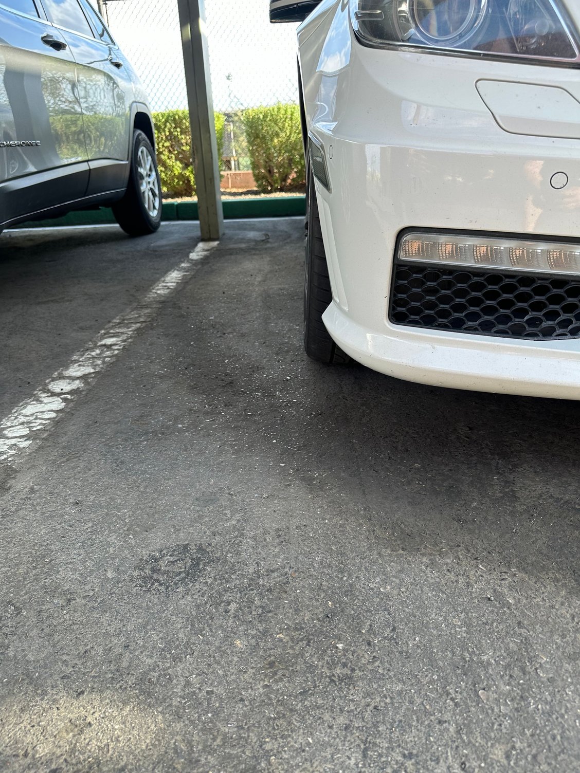

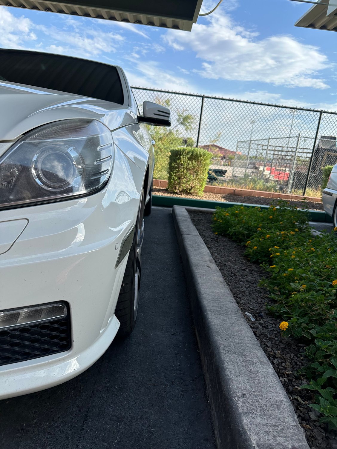

Has anyone had any luck or experience adjusting front camber on a 2010-2011 E63. It is different than all w211 and all other w212's. I have searched this forum and cant find anything specific to this. The control arms everyone raves about are for 2012-ups and the adjustable bolts are for 09 and older. It seems like there is no adjustment possible unless i do something totally custom. I have negative camber on the right front that is so bad its noticable to the naked eye not just the alignment machine. I have already tried a new strut with no change.

Way negative
In spec

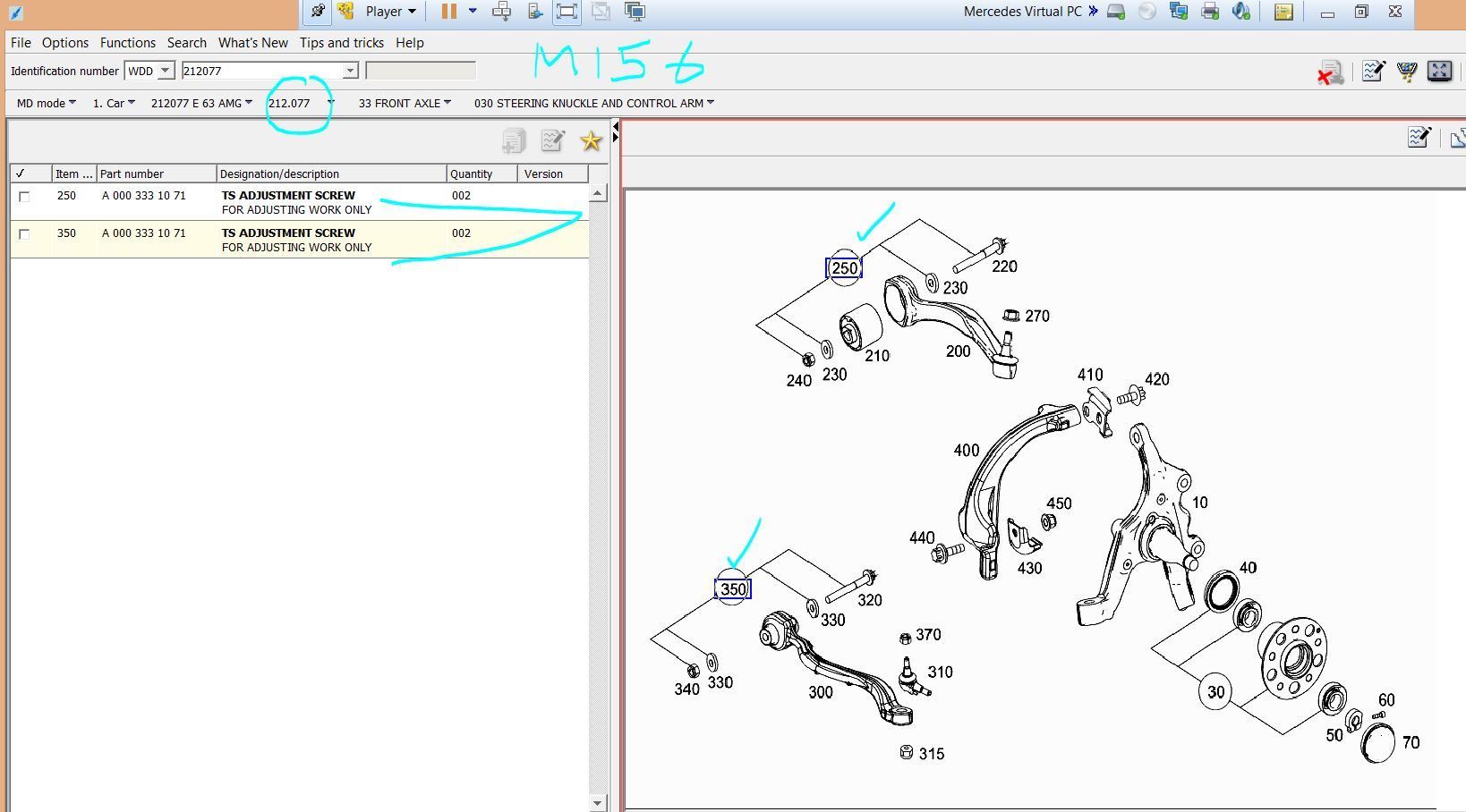

Is your chassis W212.077 4-matic with M156 engine ?
If so, all you need is either new arms or the correction bolts.
Show me your alignment report

It is not a 4matic, there are no m156 4matic w212 e63’s, these control arms do not use or fit the adjustment bolts.
I will print up the alignment report next time I bring it to work.
I did check out the KMAC site and that will probably be the way to go.

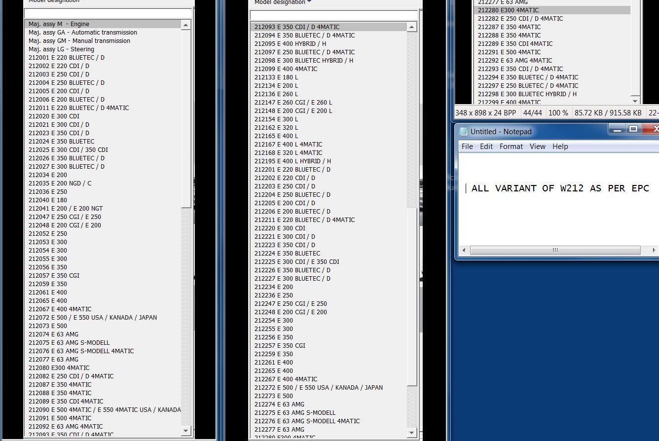

oops sorry, W212.077 it is not 4-matic indeed.
You did not confirm yours being a W212.077, if it is, read below : Correction bolt is available as per EPC.
