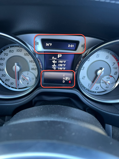

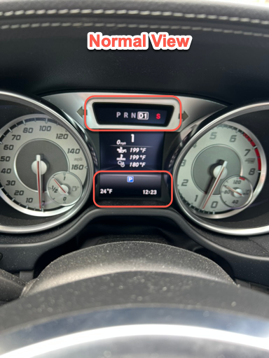

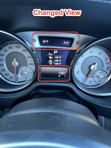

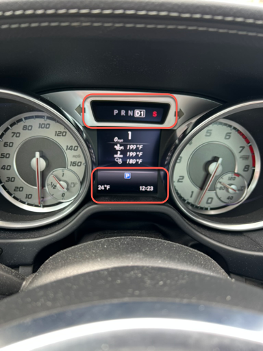

I did the reboot today and, contrary to what I was expecting, I could tell a difference. Responsiveness was good and shifts were nice and consistent. I know something changed because my instrument cluster changed the main view. The normal view is to have the gears up top and the temp and time on the bottom. Immediately after reconnecting everything and starting the car, there was a view with the gear selection on the bottom and the temp and time on the top. But upon restarting the car, the view returned to "normal". Weird!
Nothing else seemed to have changed. My tranny had been shifting fine before, but it was just different after the chassis reboot.
Normal view.  Temp and time on the bottom. Changed (temperary) view.  Temp and time up top.
Normal view. Temp and time on the bottom. Changed (temporary) view. Temp and time up top.

Old Feb 22, 2025 | 12:07 AM

sanity is restored
IC pics
JR: your chassis is at the point where you can tell what makes it work better: you deserve it!
This is testimony that ECU/TCU timings are related to CAN. Rebooting partner modules makes the powertrain run noticeably better. 👏
Conversely *not* rebooting accrues CAN latencies that F*'s up ECU/TCU courtesy of Bosch state of the art [ECU - ESP - CGW] modules.
That quick reboot is well worth it in addition to an AGM Float.
This is incentives to keep improving CAN networking...

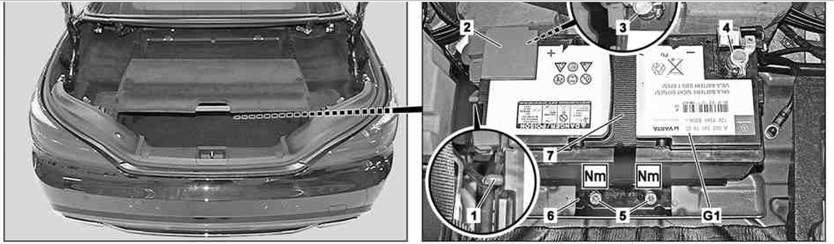

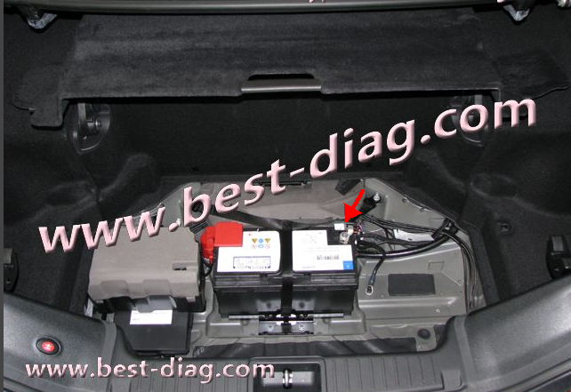

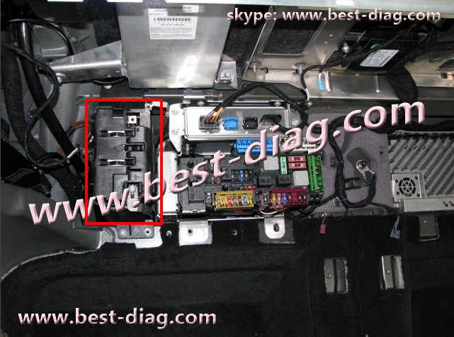

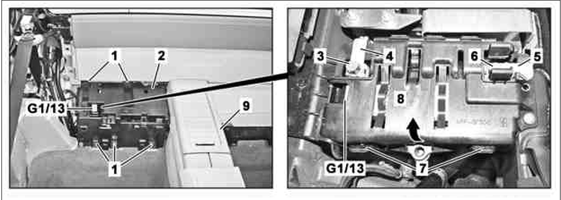

The Main Battery is in the trunk in the center of the car.
Main battery
Main Battery
The Auxiliary Battery is behind the passenger seat.
Additional (Auxiliary) Battery

i see, so you don't have as ours in w205 which seems the reboot in your case is doable, so i guess with w205 we have to stick only with float without reboot.. :/
Old Feb 23, 2025 | 09:17 AM
  #38
CaliBenzDriver's Avatar
Joined: Apr 2019
Posts: 11,994
Likes: 6,827
From: Silicon Valley
W212 MY'14 M276-3.5NA @75kMi
HOW TO DEAL WITH AUX-CAP ??
Kristiyan... you over simplified the reboot step because of your AUX-CAP.
Reboot is a worthy step that you should execute to help sanitize CAN-Bus timings.
-- You need to find out what is the AUX-CAP replacement procedure... you don't want to surge that module dead, right?
-- Find out how to deal with limiting its charge current.
