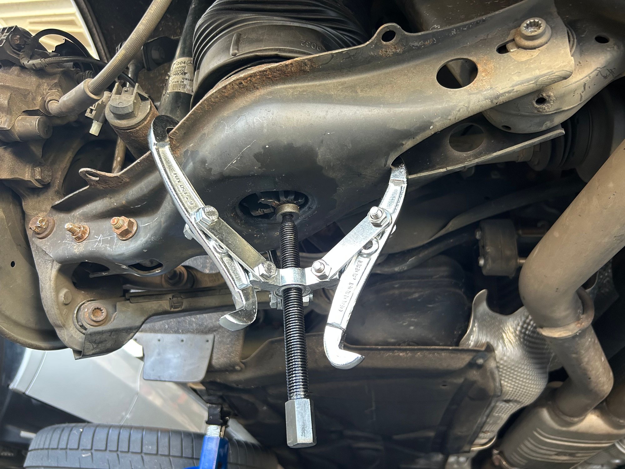

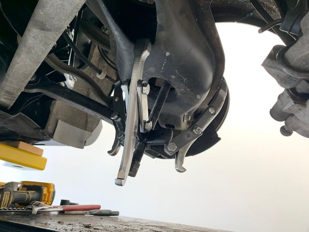

I just had a rear air spring start leaking on my 2013 S212. It was going down in less than an hour so I didn't really have much of an option. The google-foo and youtube-foo regarding separating the spring from its seat in the suspension arm is all about how hard to hit it from below and with what size hammer. I gave that a go, quickly got nowhere. So I came up with another method. I used a gear puller to push upwards on the spring seat. It worked very well, and didn't involve very much cursing at all!

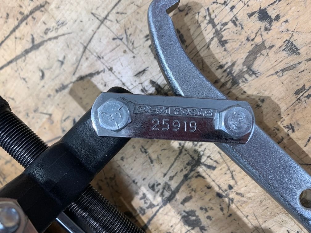

Here are some pics showing the orientation of the puller. (Obviously the spring is already out.) I put a 3/8 drive socket on top of the threaded rod to provide more surface area; it embedded itself in the plastic during the process but was fairly easy to remove after. Last pic shows the make/model of the puller I used, but there are plenty of manufacturers. If there was any trick to it it would be that the innermost arm was placed in its shorter configuration; again see pics.
I believe this is a pretty good method, for this reason: now that I have the springs out I can see that my suspension arms are very badly rusted in the area where the spring seats, so bad that I am replacing them. That's how tight these particular springs were. I hope this information helps the next poor soul who DIYs this job.

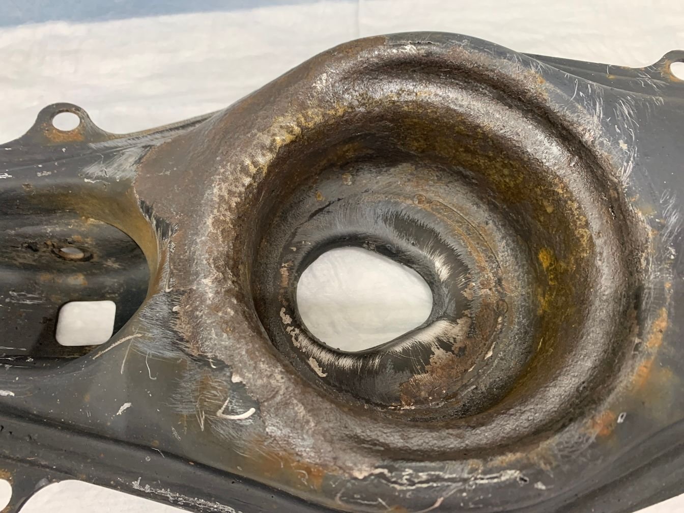

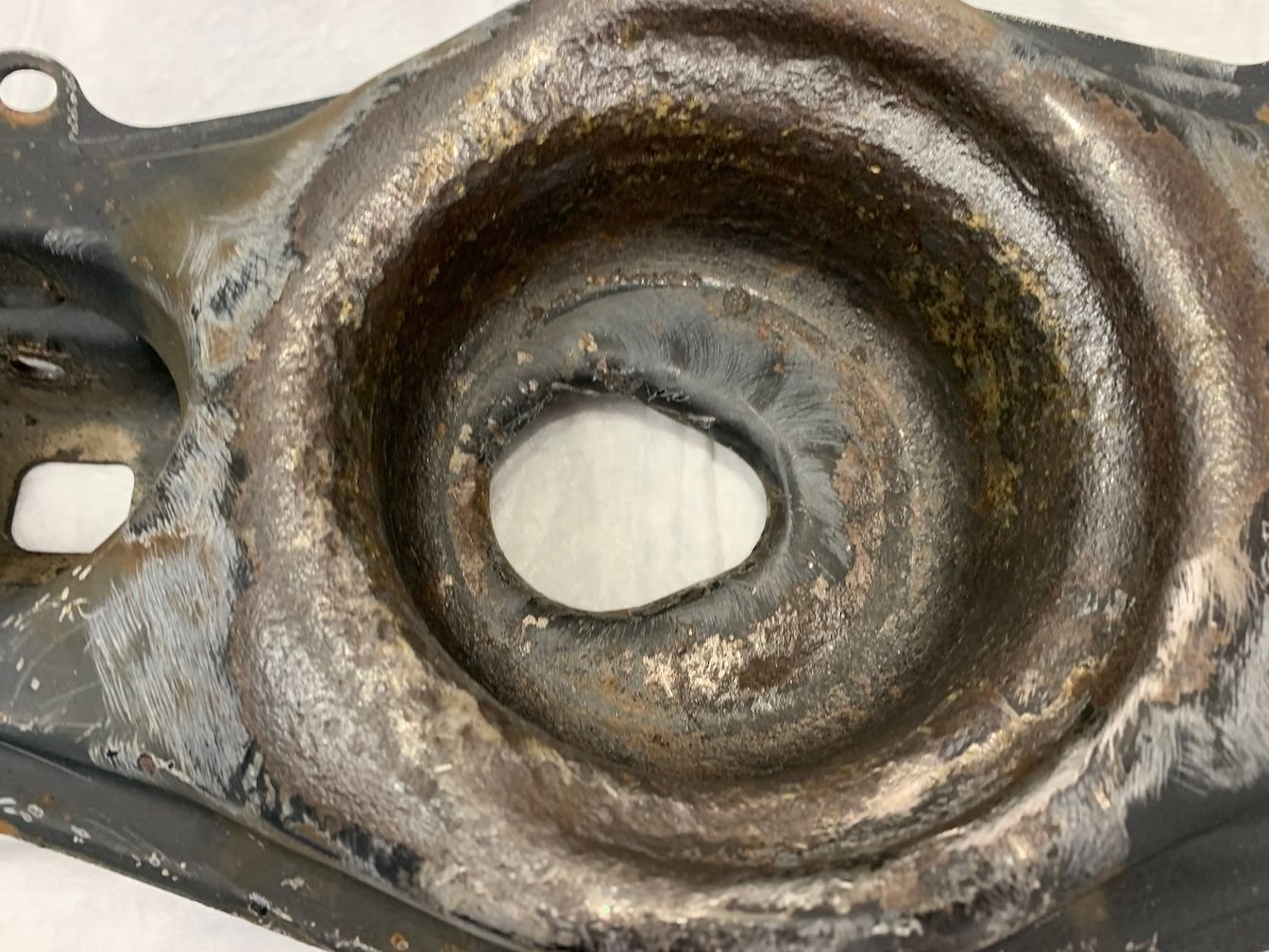

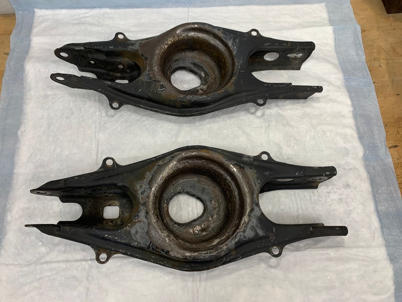

Oh boy. Rear spring arms are out of stock, with no ETA on when more will arrive. Reminds me of a certain battery I had some fun with not long ago. So, I dropped the pieces I have and descaled them to the best of my ability, tools, and patience. They're being coated with Eastwood Rust Encapsulator Plus as I write this; first coat is on, and I'll follow up with a second coat in a bit. Then back we go.
Adding a bit to the knowledge base portion of this thread: it looked to me as though the spring arm had a camber adjustment bolt at its inner mount point -- it doesn't. Go ahead and drop the spring arm off if you need to clean it up, rather than trying to do it on the car. I'm still going to have the alignment redone once the car is back together just for peace of mind. I'll update this forum with the results.
As I go through this process I've been collecting what appears to me to be sufficient evidence to write a scathing review of Tom Masano Mercedes of Reading, PA (USA), which I will do under separate cover. In the meantime here are my lovely, unobtanium spring arms. The steel is quite thick so I am not worried about these failing; I was going to replace them just to save the mess and effort of cleaning them. It was a bear.
