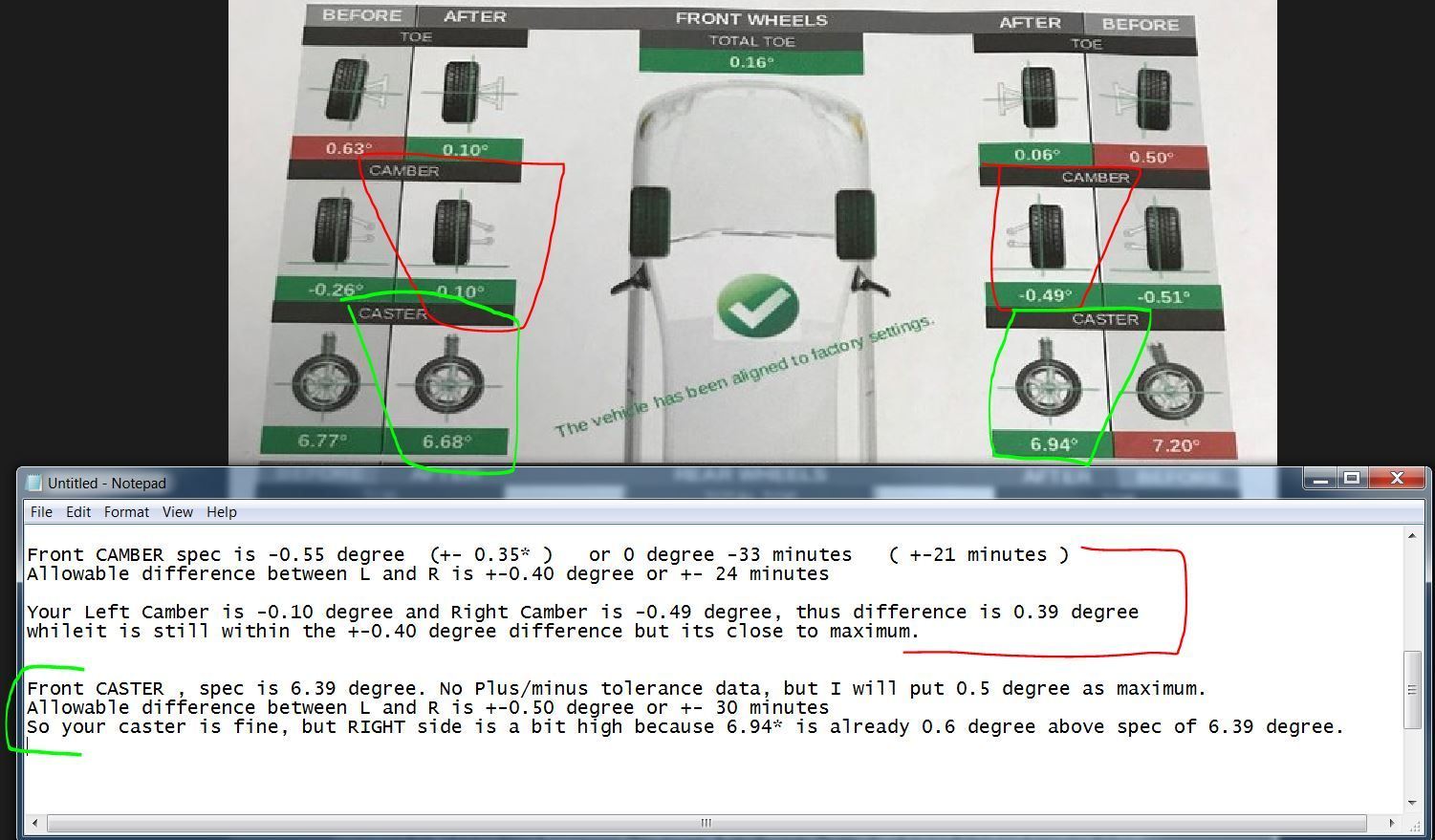

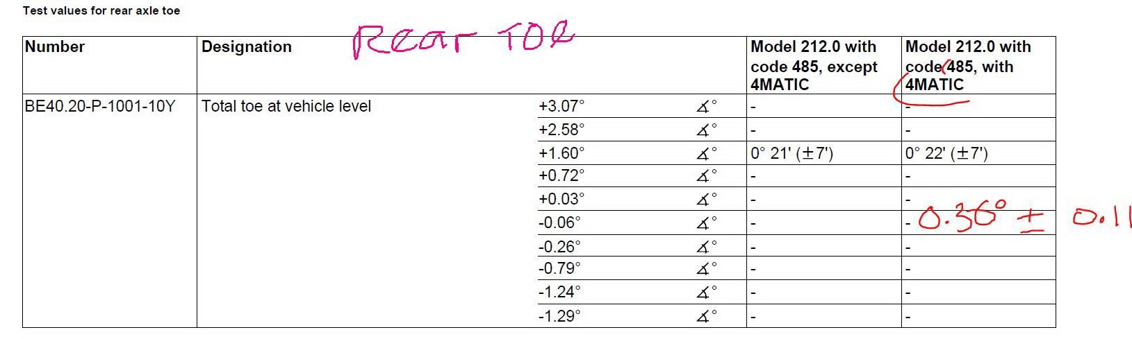

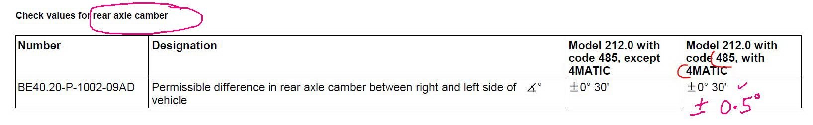

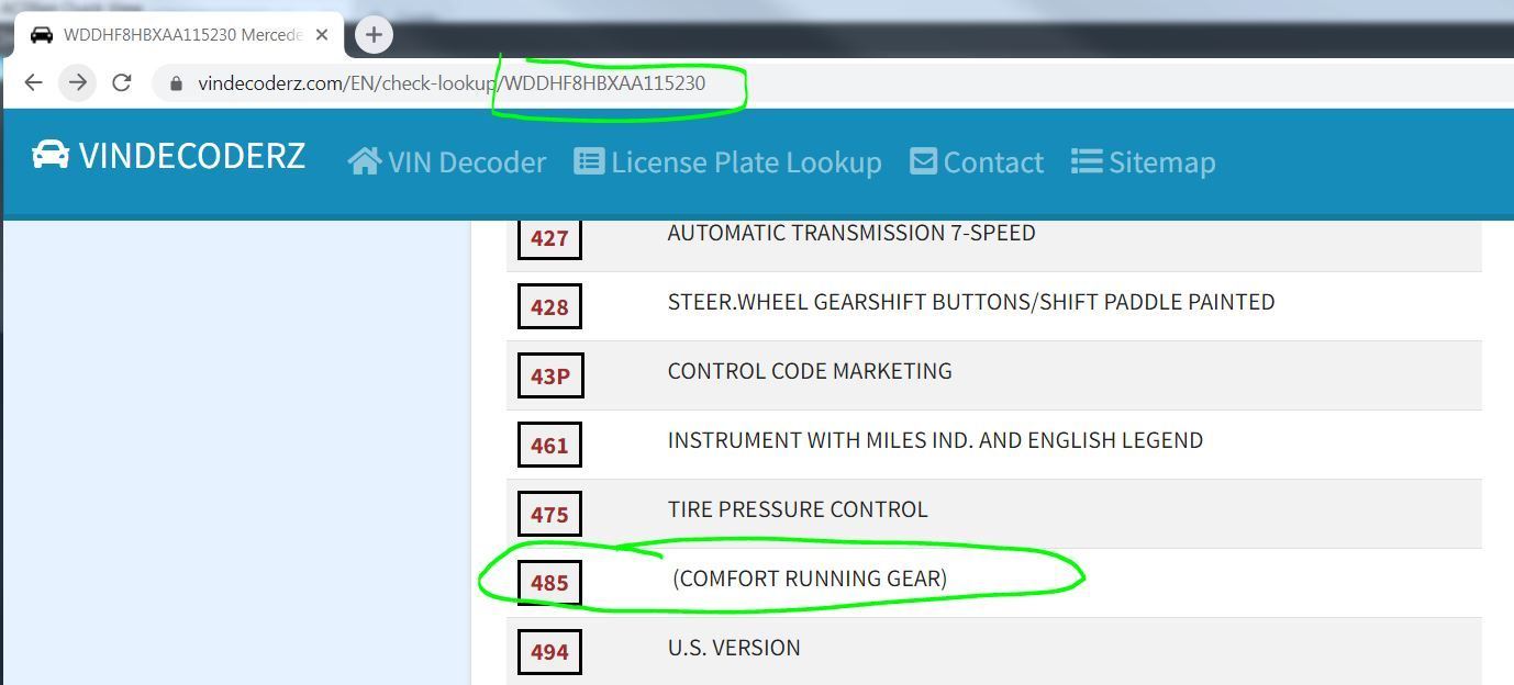

Your suspension code is 485 and a 4-Matic

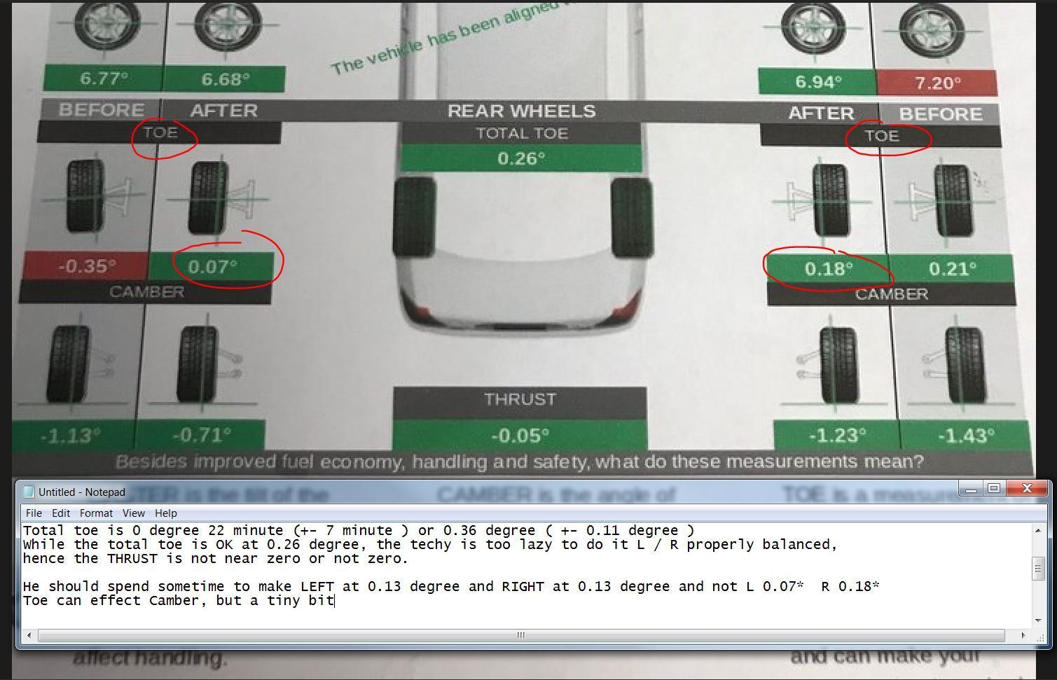

Next time set the REAR TOE to 0.36 degree total or 0.18 degree each side. Its nice for high speed

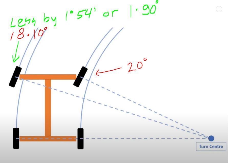

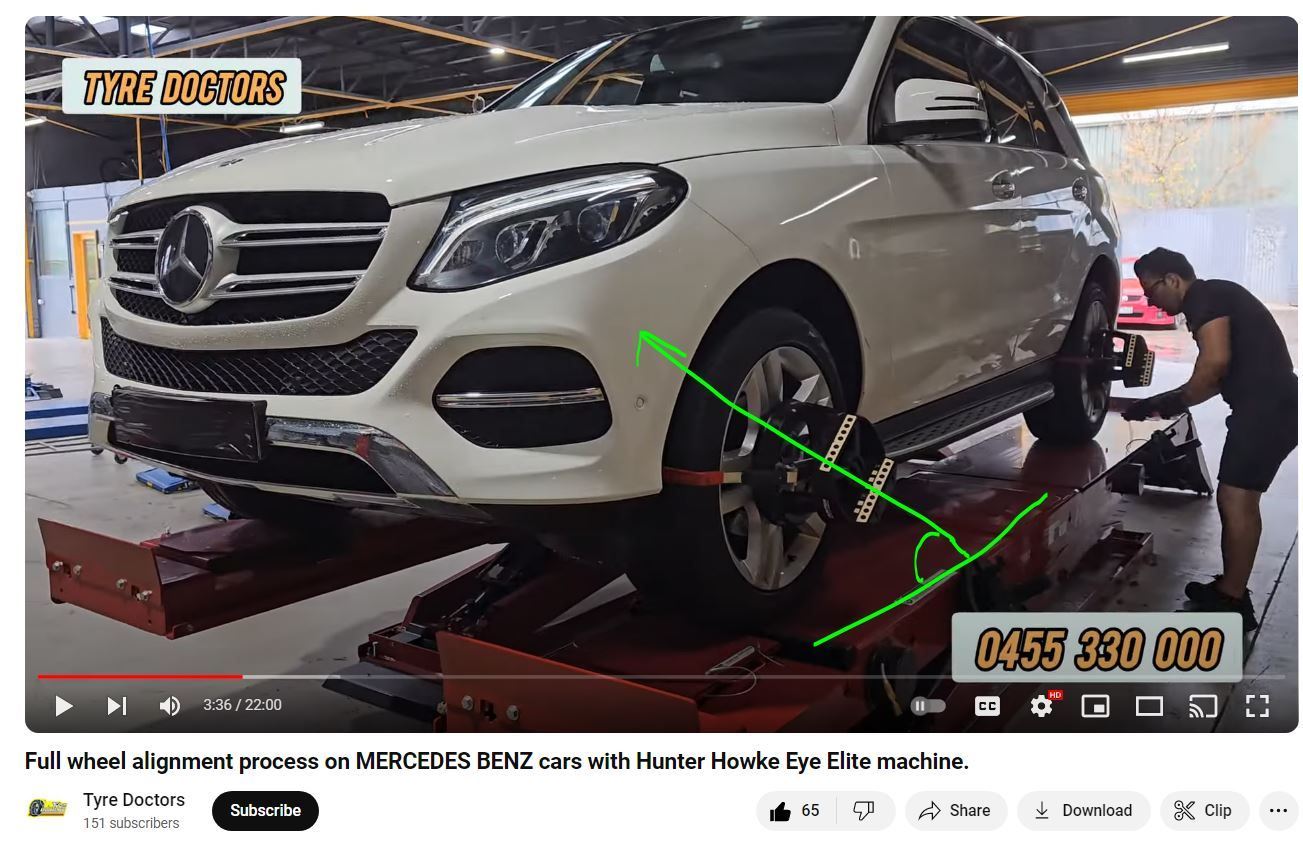

Your alignment shop did not do the ackermann angle verification. This is known as Toe-Out angle with inner wheel steered through 20 degrees.
During a turn, the inner wheel MUST angle more than outer wheel, as the corner radius is tighter at the inner side.
This one :
Some cars make those tire screeching sound during cornering which is not the wheel skidding yet..... that is bad toe out angle.

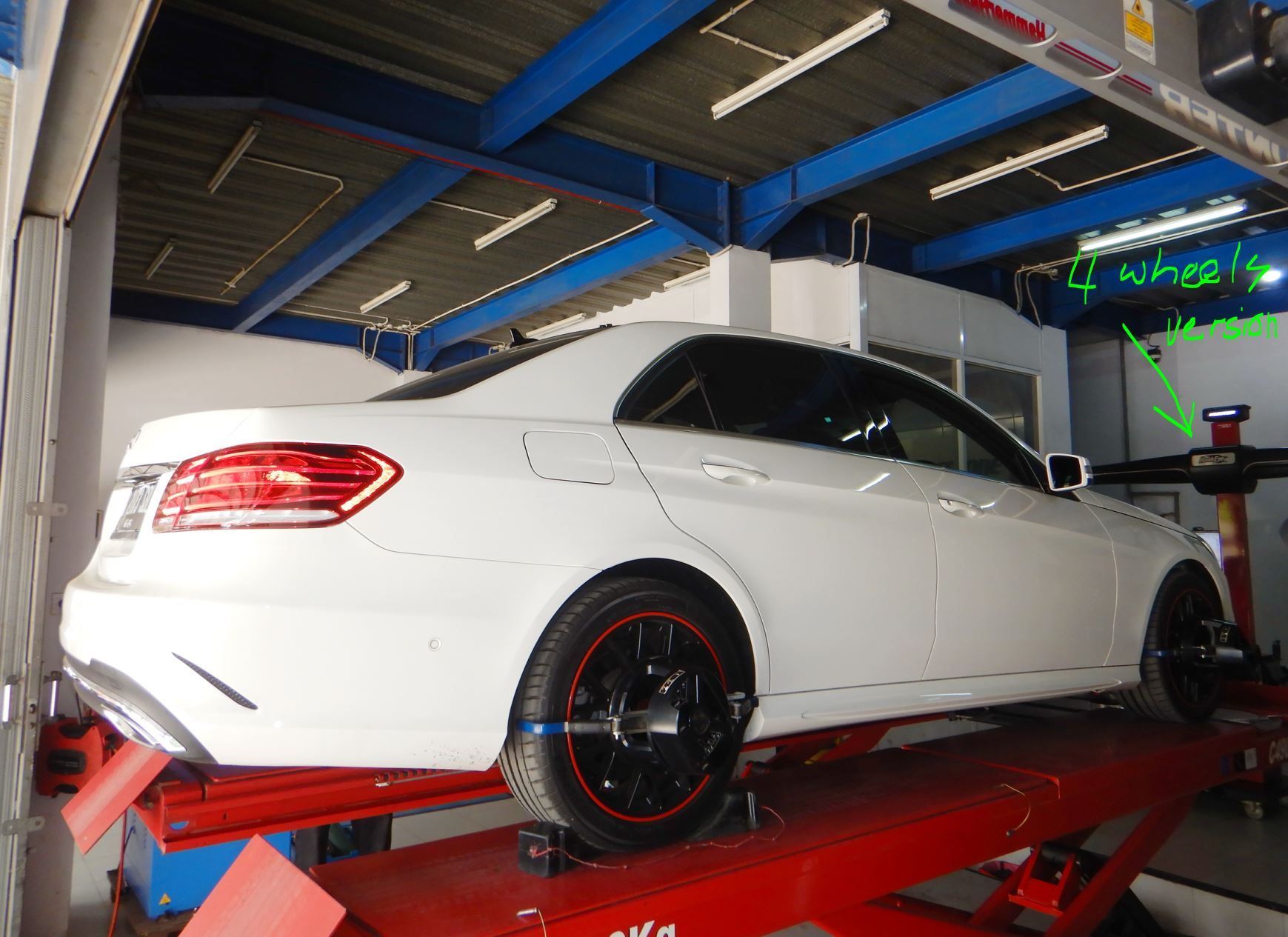

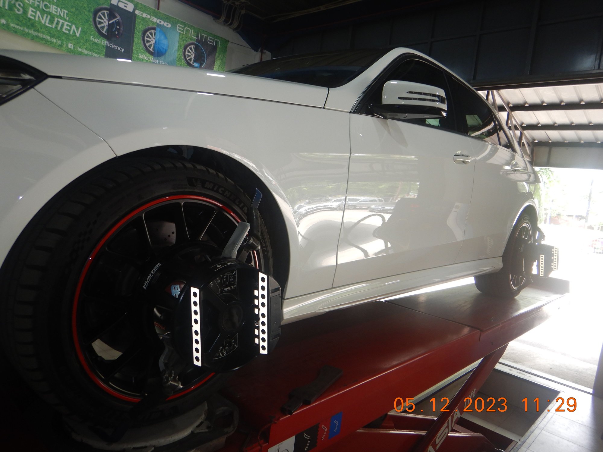

My wheel alignment shop has the same issue , I already tried and the sensor can not read that 20 degrees wheel steering requirement for this verification.
I think the camera sensor and the wheel alignment rack is too close together, as such the reflector at the wheel get tilted too much when at 20 degrees steering. I am guessing.
Or they should have installed specific for front sensor reflector is to be angled up and not straight.
This is not angled up reflector. It can read OK, but at 20 degree steering I think this could be the culprit. Next time I will tell techy to tilt it up.
Tilt up like this
I also have not seen a wheel alignment shop ( indie ) having a true Mercedes or BMW wheel adapter for the reflector.
They always use the generic reflector as you seen on my car.

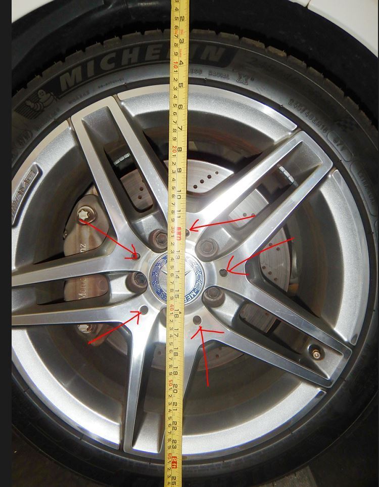

This is why MB and BMW original wheel, will have those 5 holes for the special alignment adapter for the reflector.

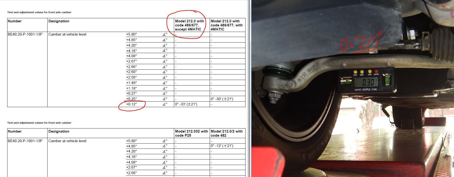

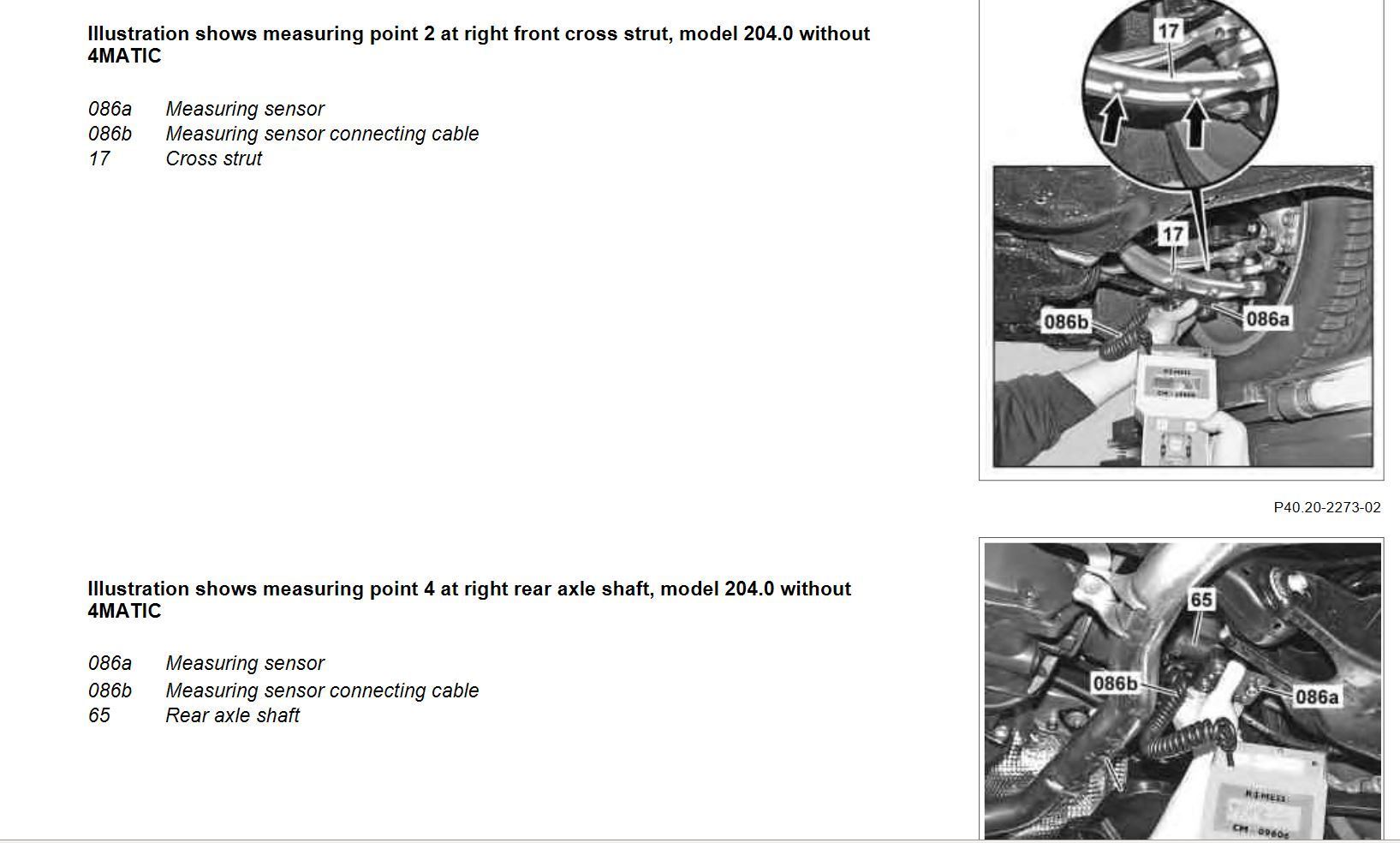

I am also kinda sad that my alignment shop does not own Romess Inclinometer and MB full software pack to use that inclinometer.
This inclinometer is not cheap and only for MB cars I think, but it is very important to have such device as it tells actual ride height by angle.
This is Romess inclinometer in use :
If we see MB Romess file, we would understand why ride height or romess use is important, because when we see Romess value off, that means something is wrong with our suspension system.

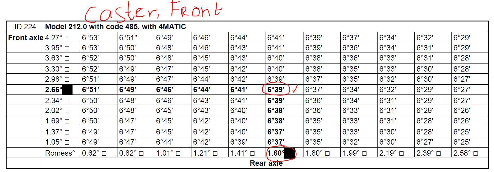

So a 485 suspension 4 matic Romess value at the front is to be at 2.67 degree....and thus the front camber is then at 22 minutes.
Front Caster also based on 2.67 degree Romess for front axle and 1.60 degrees Romess for rear axle.
I have tried using common inclinometer but I do not have the special touch pad as base.
I also do not know if my unit is a true zero when at true flat horizon. 0.5 degree accuracy is a tall order when the body of the unit is cheapo plastic...LOL.
