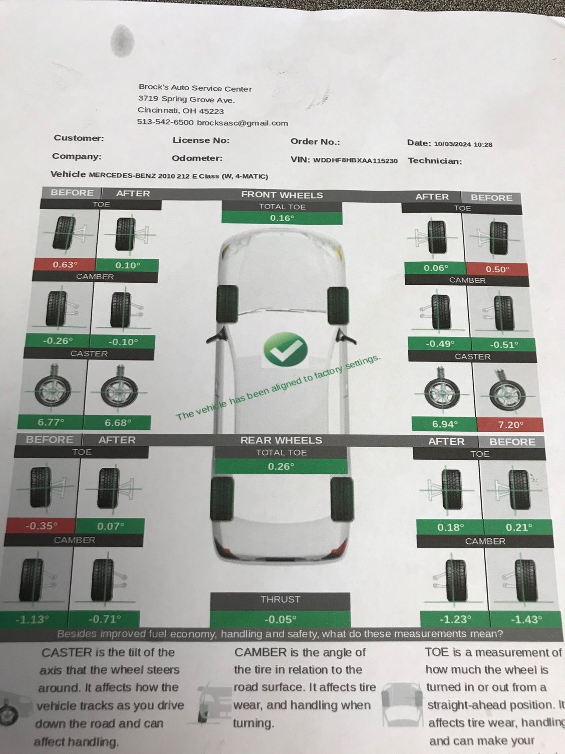

Old Sep 28, 2024 | 02:18 PM
MBNUT1's Avatar
Joined: Oct 2002
Posts: 4,975
Likes: 1,343

Thanks to all the valuable input I got here I got things back together with the new front struts sans getting the bushings torqued completely.
Took it to a local tire store for an alignment and they said they the camber was out and wanted an outrageous amount to put in the repair bolts. So I took it back. I have one of the repair bolts and ordered another. Have another alignment scheduled with a shop in the neighborhood. I am hoping that they will install the repair bolts in the camber arms and tighten the caster bolts for a reasonable amount along with the alignment.
I haven't replaced the rear shocks and based on the the difference in the front end ride quality and the rear I am guessing I am going to need to. Wanting to confirm that I do that after the alignment without requiring another alignment.

Do you have your alignment result / print-out ?
Thanks for the prompt reply!
He showed them to me but did not give them to me. He claimed the caster was in at .66? and .68?, He said the the camber was out but (+.33?) but might come in as the new struts broke in. And said the toe in was out a little. He said it probably drives straight. I have been afraid to drive it far because of the under torqued front bushings (110 nm + 20-30 deg). I need to go see my brother who is 300 miles away in the next week. It felt pretty good and was tempted to get it on the highway to see if it pulled but again concerned about the bushing torque.
What do you think about the rear shocks?

At 14 years old and I bet good mileage on your car, if the rear shocks is as old as the car, replace them.
Dang.... I was hoping they print out the wheel alignment result, otherwise its what he/techy said
Yeah I expect to replace them but was wondering if I can do that after I have the alignment done without needed to redo the alignment. I need to go out of town before I can get them in. Do you agree that will be ok?
So this is not the same as when the original shop looked at it because I believe the before in this case is after the second shop installed the camber repair kit bolts which looks like it brought the camber into specs.
The strange part is at the first shop the caster was in on both sides. Wonder if the bushing slipped after I drove it because it wasn't torqued sufficiently.
The other interesting thing is after I picked it up I noticed that it was riding a little stiff so I checked the air pressures and they had set them to the values on the door post rather than on the fuel door.
