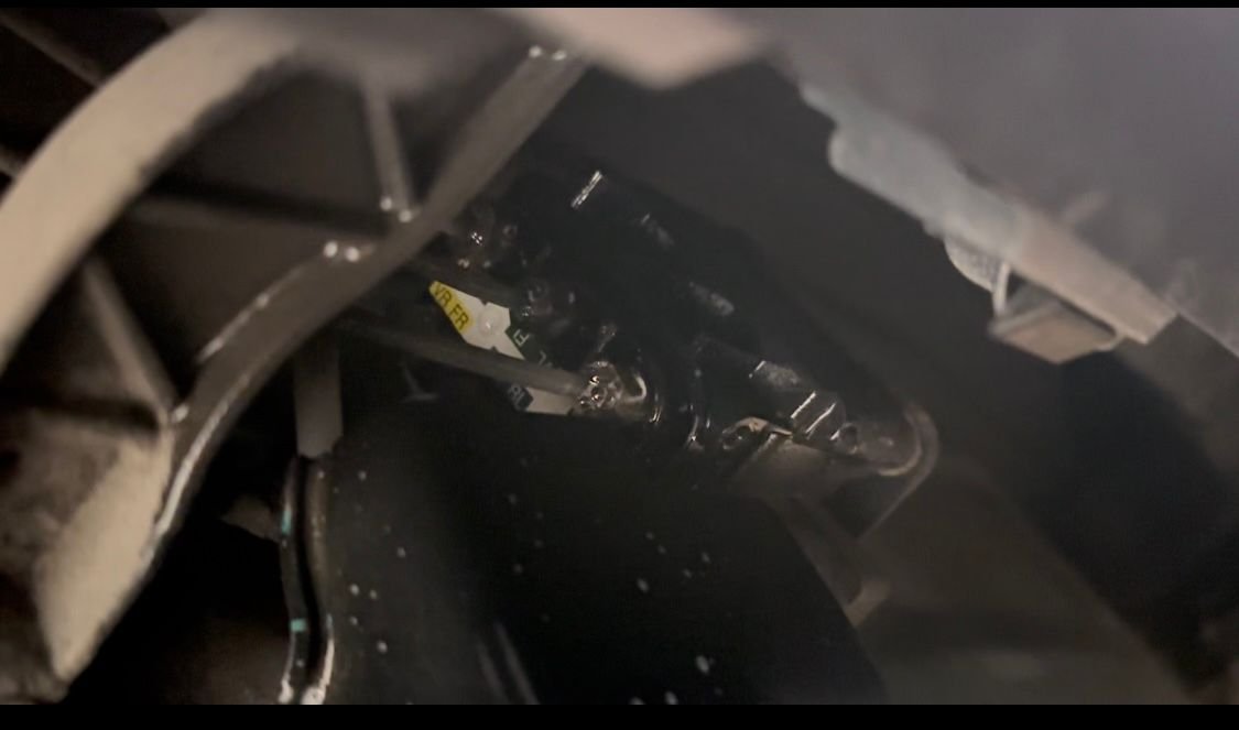

i have a 2011 E550 and the rear end of the car is completely bottoming out within an hour of parking the car.
when i start the car, it displays “vehicle rising”, and it comes up in about 60 seconds and the compressor turns off. I dont hear compressor turn on while driving. But the problem occurs after i park the car, where the rear completely bottoms out as mentioned above.

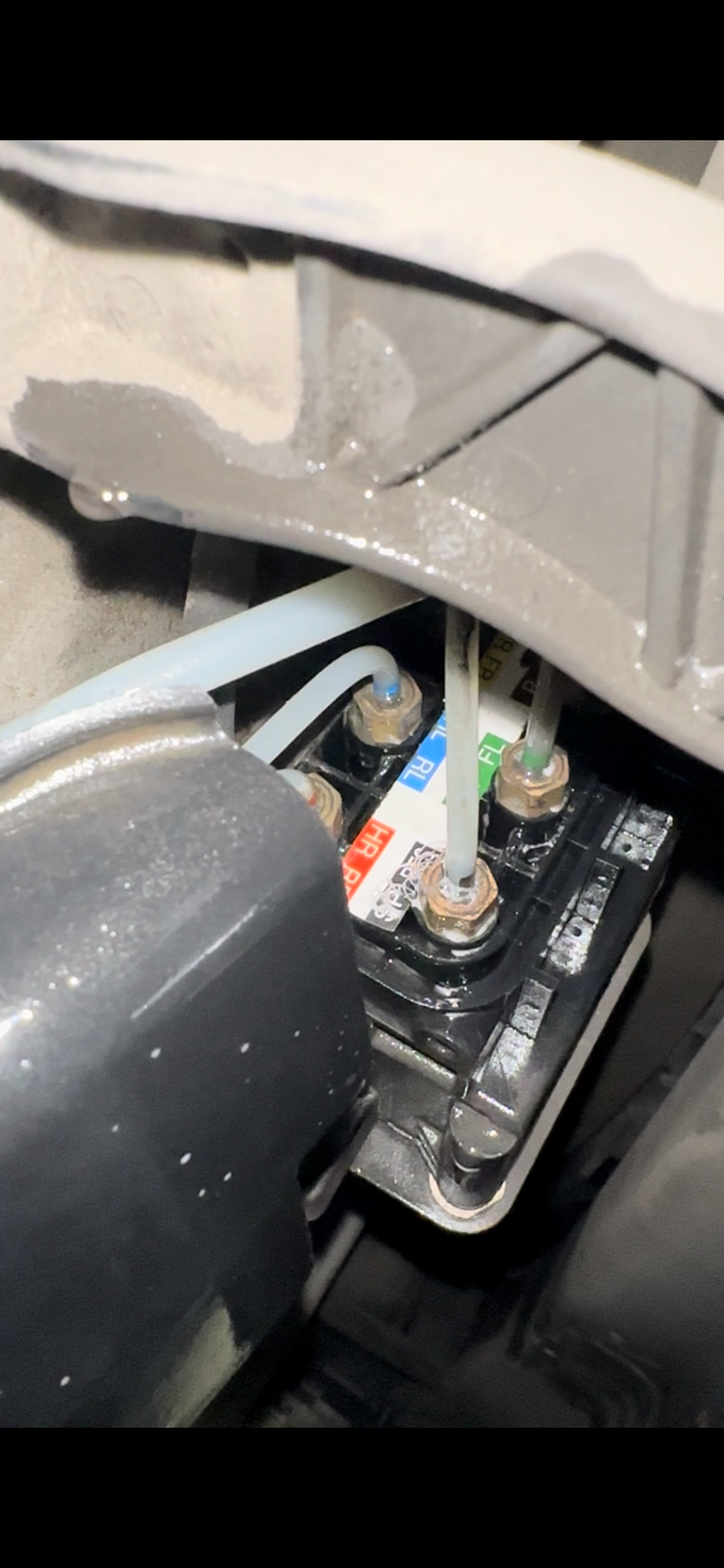

Just did a soap water test and one of the air line connections to valve block have bubbles (see attachment).
Does this require a air line to be changed or a new valve block?
Appreciate your inputs. Thanks

Right now it's the hoses but the valve block is known to rust internally with condensate so it won't be a waste of ressource to do both jobs at once before compressor overheats.
