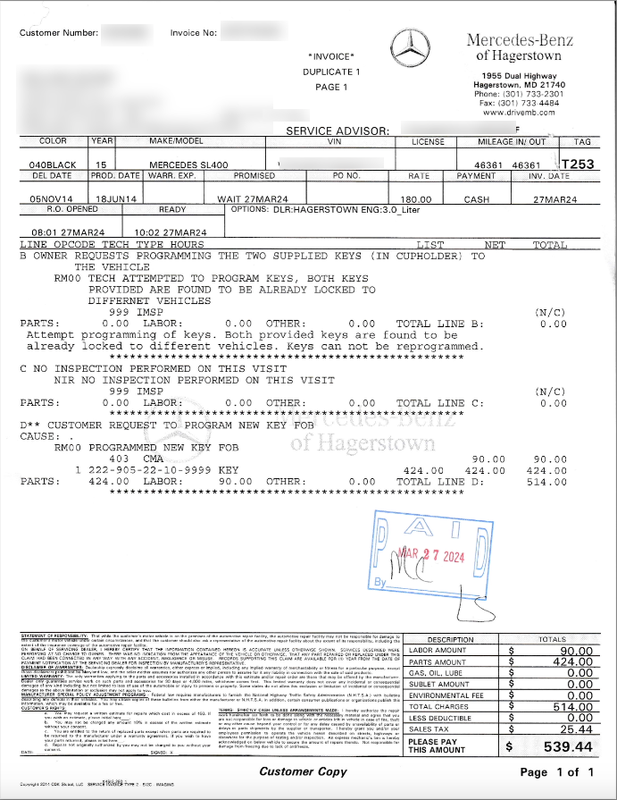

I was wrong before, the cost of my replacement was much less than $650 like I said. $650 probably included getting a cut key, which I did not. This was a little more than a year ago in March. Looks like they charged only ½ hour to program the new fob.
