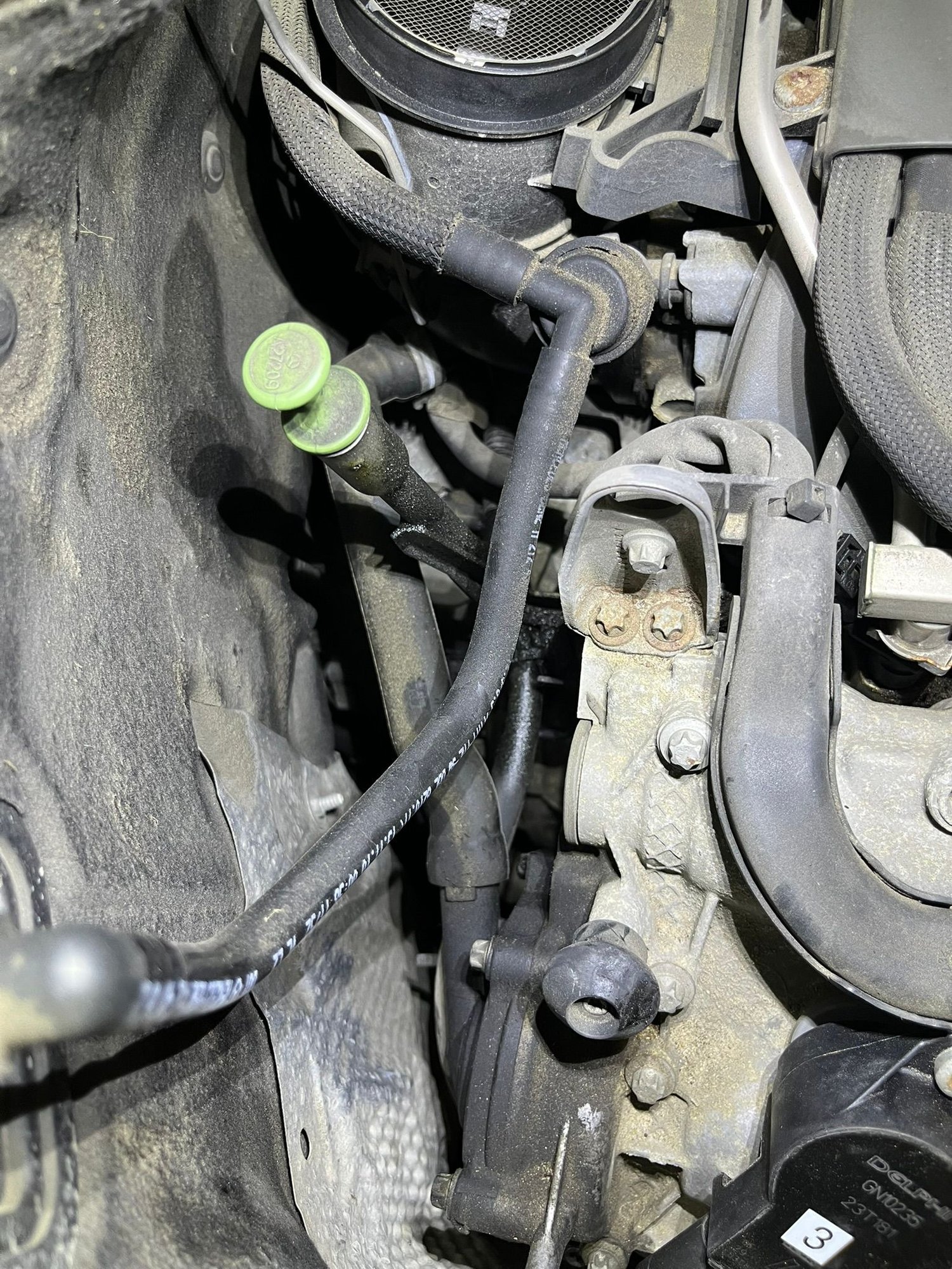

Please help me identify where this oil leak is coming from. Is it a common oil leak point? I have 2011 E350 with 140k miles. Thanks!

oil being forced out
PCV cover + camshaft rear plugs
​​​​​​hopefully it's not the engine rear main seal
Crankcase pressure must be either vented or prevented!
This may be traced to engine high blow-by... so sealing high pressure may prove to be uphill battle.

Ok thanks, I'm gonna replace the PCV cover, cam plugs and oil drip pan while I'm at it.
