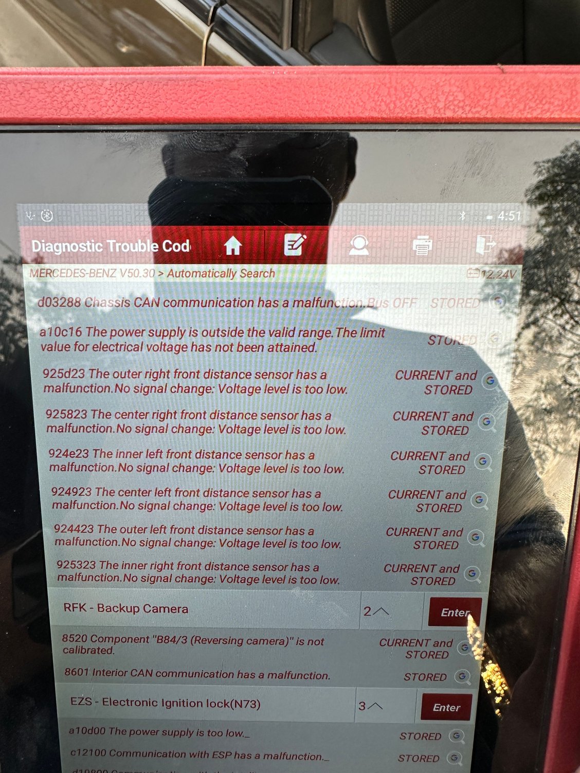

Gave my w212 e63(pre facelift but 5.5 biturbo) for wrap. The car had zero errors earlier. Naturally, bumpers etc have to come off for the wrap job. Upon collecting the car, I got 2 errors:
1. Distronic inoperable
2. Blind spot assist inoperable
Can’t engage cruise control either. I seem to have lost auto window up/down function on driver side too.
Ideally don’t wanna open up the car panels again. Any suggestions for remedy?

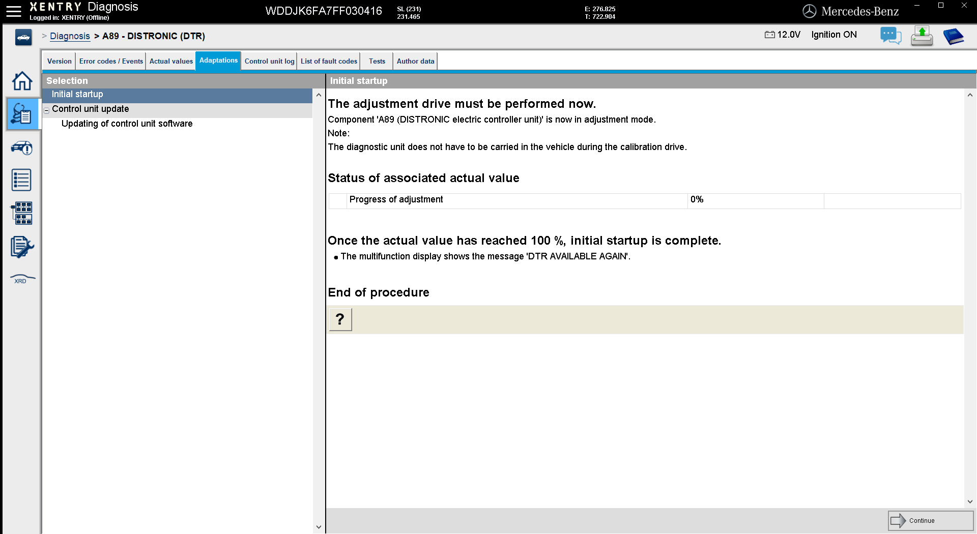

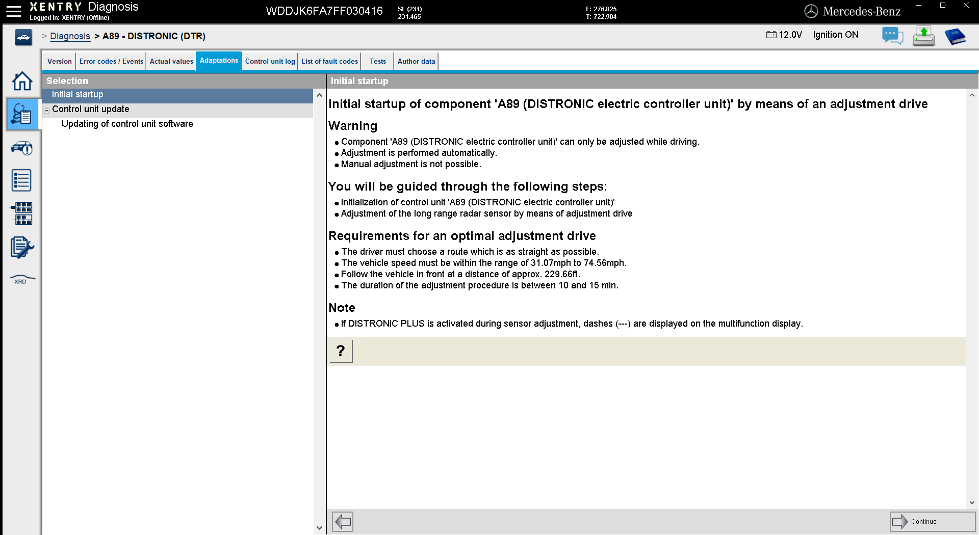

Using XENTRY, select the A89 - DISTRONIC module. Select the Adaptations tab and Initial startup. Select Initial startup without control unit replacement under Initial startup with adjustment drive (the third item down).
Read the instructions and then select Continue.
Once you select Continue, you will need to take a drive of 10-15 minutes until you get the message, DTR AVAILABLE AGAIN. If you leave XENTRY connected, it will display your progress during recalibration. Having XENTRY with you is NOT necessary.

Thankfully it was just a disconnected grip which caused the entire front bumper sensors raising errors. Per my understanding, this open circuit was also slowly draining the battery.
Connected the grip and cleared the DTCs from a normal scanner. Good to go now, phew!

MB connectors don't get disconnected by themselves... there may have been a good reason for these modules to be disconnected out of network.
See what sort of disruption pans out.
This car has experienced a low voltage
The car went for a complete wrap job and hence the bumpers, grill etc were taken off. Most likely the guys putting the parts back together forgot to connect the sensors
That would make sense since the codes are both STORED and CURRENT.
