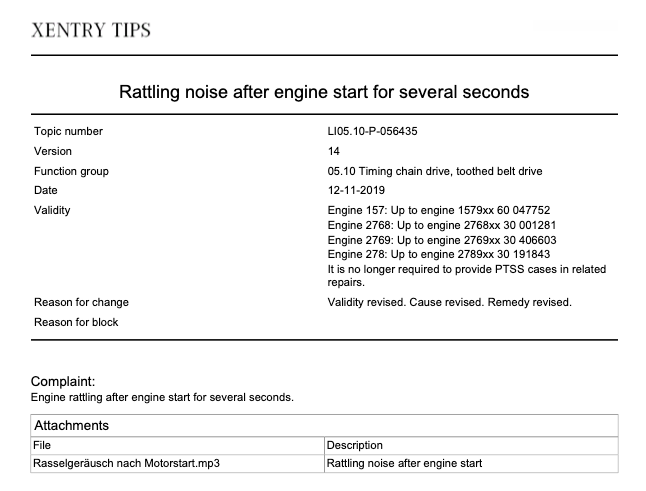

There is a momentary rattle when starting the engine cold. This is attributed to insufficient oil pressure on cold start because the engine oil has drain back into the oil pan overnight. Chain tensioners are hydraulic, and the lack of oil pressure on startup allows the timing chains to be loose for a few seconds during which time the chains slap against the tensioning rails. Over time, the chains cause premature wear of the rails to the point of possible chain skip.
Mercedes has addressed this by using a one-way check valve with updated tensioners to reduce or eliminate the drain-down of oil. The fix can be retrofitted to older engines, but many times the damage of excess wear has already occurred.

Here's more info. Check to see if your engine is affected (document attached). You can find your engine number at www.lastvin.com. The TIPS report states:
"The secondary chain tensioners produce a rattling noise until the engine oil pressure has built up. No consequential
damage is to be expected. Other causes not related to secondary chain tensioners are also possible and not described in this LI.."
Though it states no consequential damage is to be expected, clearly there has been. The attached document is version 14 (12-11-2019); there may be newer versions. Original (version 1) was published 07-16-2013. So, you can see it is continually updated. I don't have direct access to TIPS.
