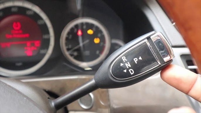

Can I change the Mercedes Shift style from the normal look to the AMG one?
Hey everyone,
I'm planning to purchase a Mercedes W212 E220 CDI(2012) and have some modifications in mind:
  • Install an AMG-style body kit (prefacelift)
  • Upgrade to an AMG-style steering wheel (newer model)
  • Replace the instrument cluster with a digital version and install a larger infotainment screen
I have a couple of questions regarding the center console modifications:
  1. Can I replace the center console to fit the AMG-style shifter? If so, what specific components or modifications should I consider to ensure proper fitment?
  2. Instead of the standard drive mode dial and buttons, I plan to install custom-made gauges to display temperature and other parameters Can this be done?

I don't think the issue is the engine being 350 or 250.... the issue is coding modules to work with chassis and 722.9 tranny.
The features are activated in the chassis gateway... it's next to impossible to enable modules the gateway ignores.
To go around that limitation... you need to flash basic gateway to become an AMG Gateway... specialist who do that line of work are a rare breed.
If you're going to invest mounds of cash... get a worthy engine to propel your chassis.

The difference in shifters is NOT insignificant. The existing shifter is mechanically operated with physical shift linkages (shift rod). The AMG style (along with the stalk-mounted controls) is electronically activated (Electronic Selector Module -- ESM). There is a lot more than just the center console cover. You would probably need the dealer to code everything for you since the transmission is considered a high-theft part. That also may be difficult since dealers don't like doing anything outside of their authority to operate.
