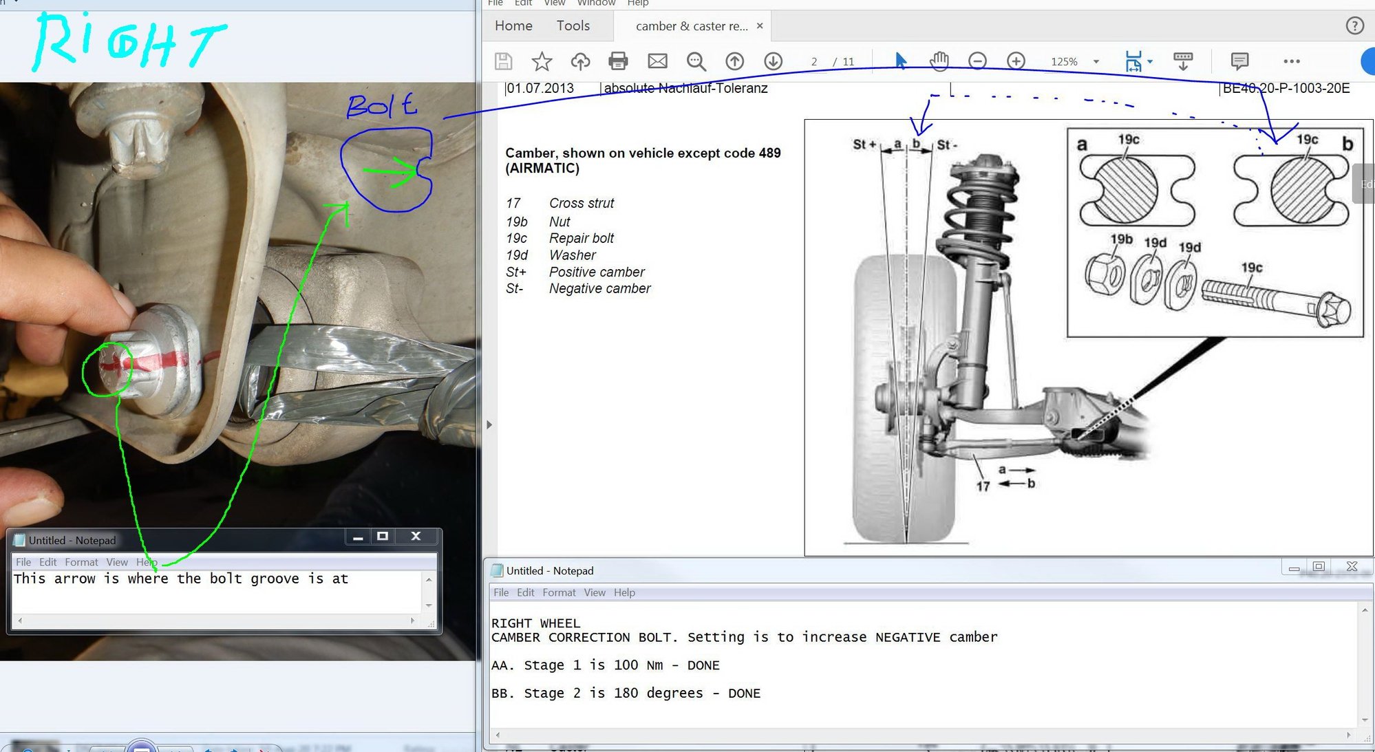

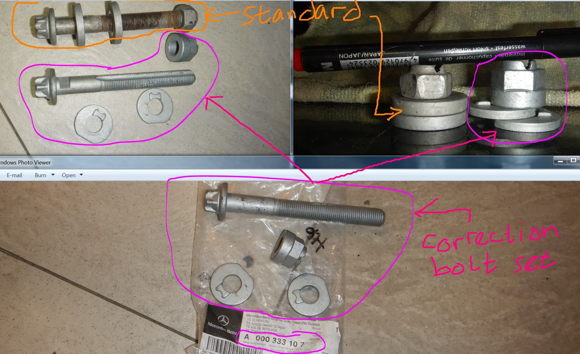

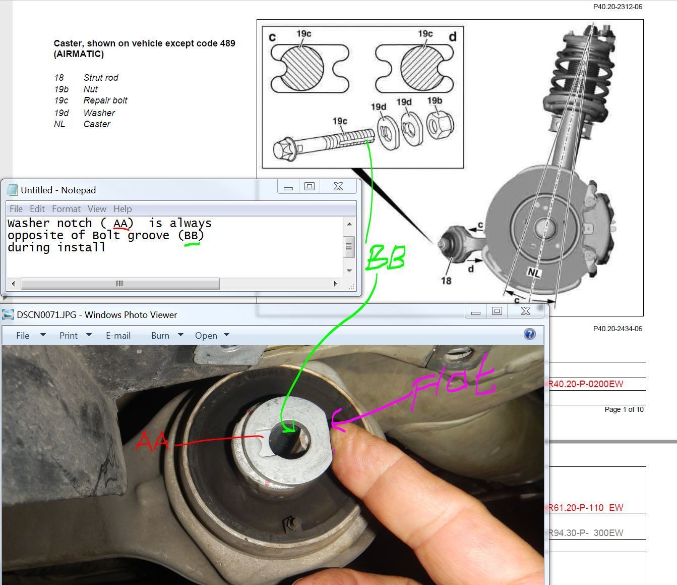

New front suspension arms SHOULD NOT EVER use bolt with the slot/groove, which is a CORRECTION BOLT for Caster or Camber, depends on which arm get that correction bolt.
If by accident the suspension arm is using CORRECTION BOLT, that is what you are seeing now on the steering not being centered.
Also you must tightened the suspension arm at proper ride height ( pre-loaded ), or else the bushings will be short lived.
Its not a joke to tightened the suspension arm unless on a tall 4 post lift. 110-120NM and 180 degrees, the 180* is the bi-tch if working with only less than 2 feet clearance from the ground.
CAMBER, when using correction bolt.
CASTER, when using correction bolt.

I just used the bolts that came with the set/kit. 🫣
I went and checked the arms again today and noticed a small imprint from the washer on the steel where the bolt is, then i realised that i had turned the bolt in the wrong way, the groove on the bolt turned to outside the car but should have turned inside the car. I changed the direction of the groove and and the steering wheel is centered again.
but now the right side has the correction bolts on both camber and caster. Caster had the normal bolt.
