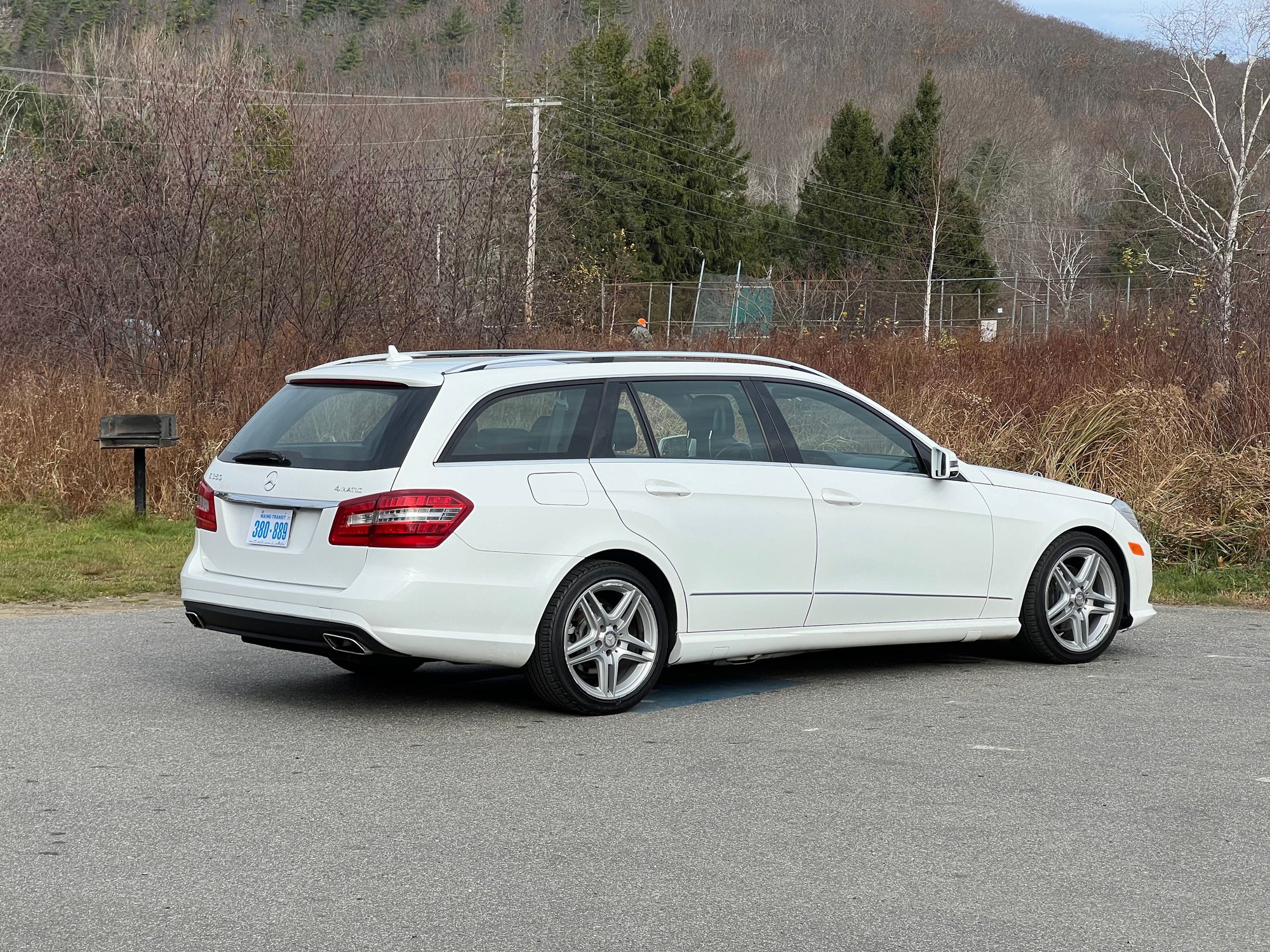

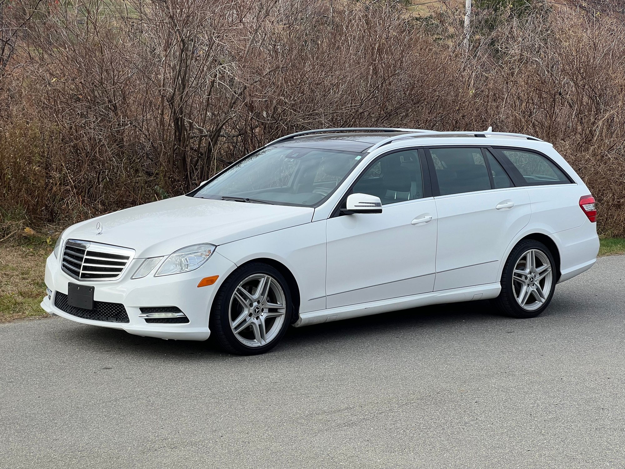

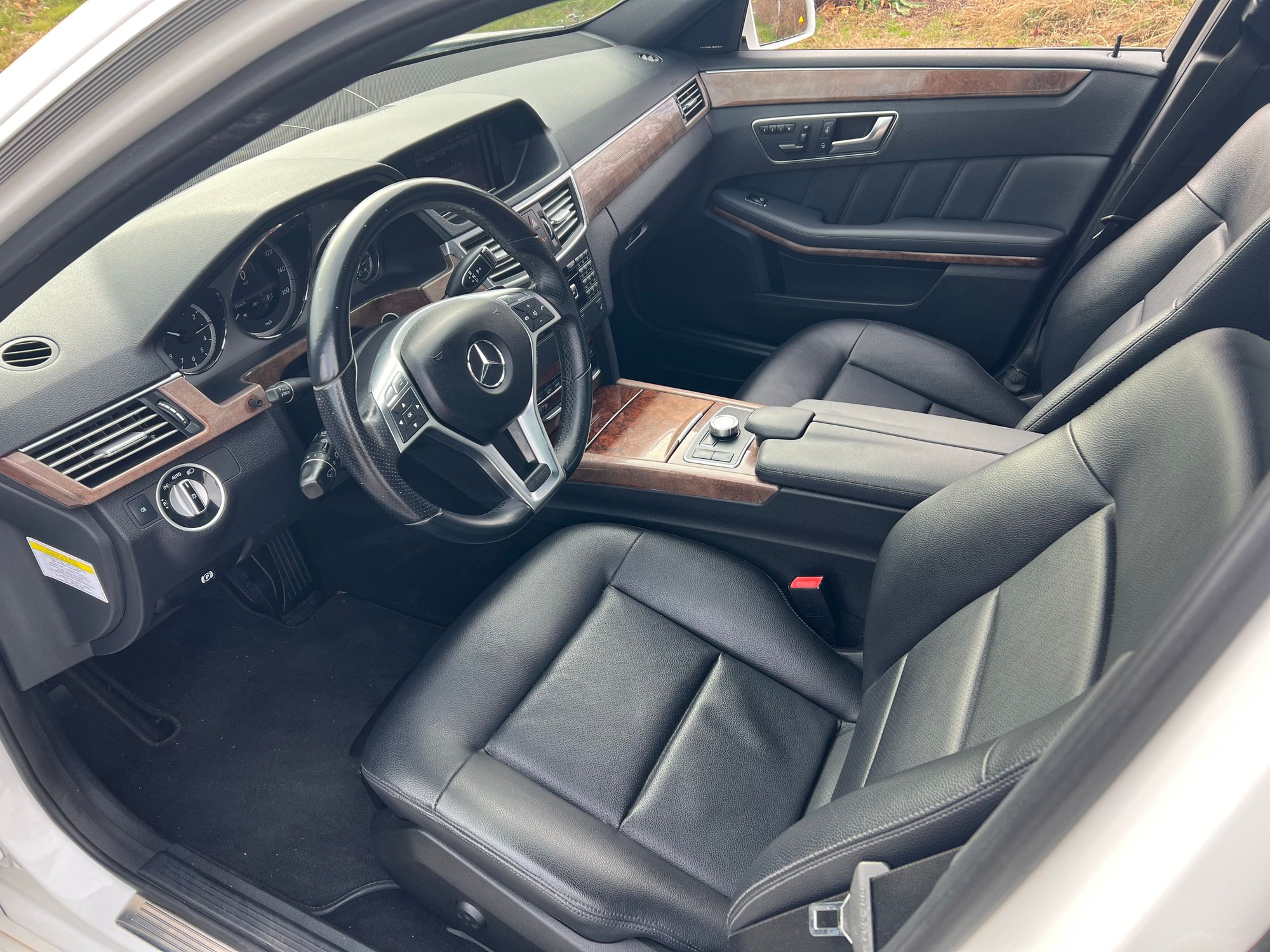

Well, I've done it! I picked up a Polar White 2013 E350 yesterday and I'm loving it so far. The interior and exterior are in fantastic shape, and it had a new rear subframe, rear brake lines, and rear air springs installed in August, so that's helpful for peace of mind. It has a lot of miles (175k), but I'm glad to find one that has been cared for well (or at least seems to – the 4.5-hour drive home yesterday went flawlessly).
