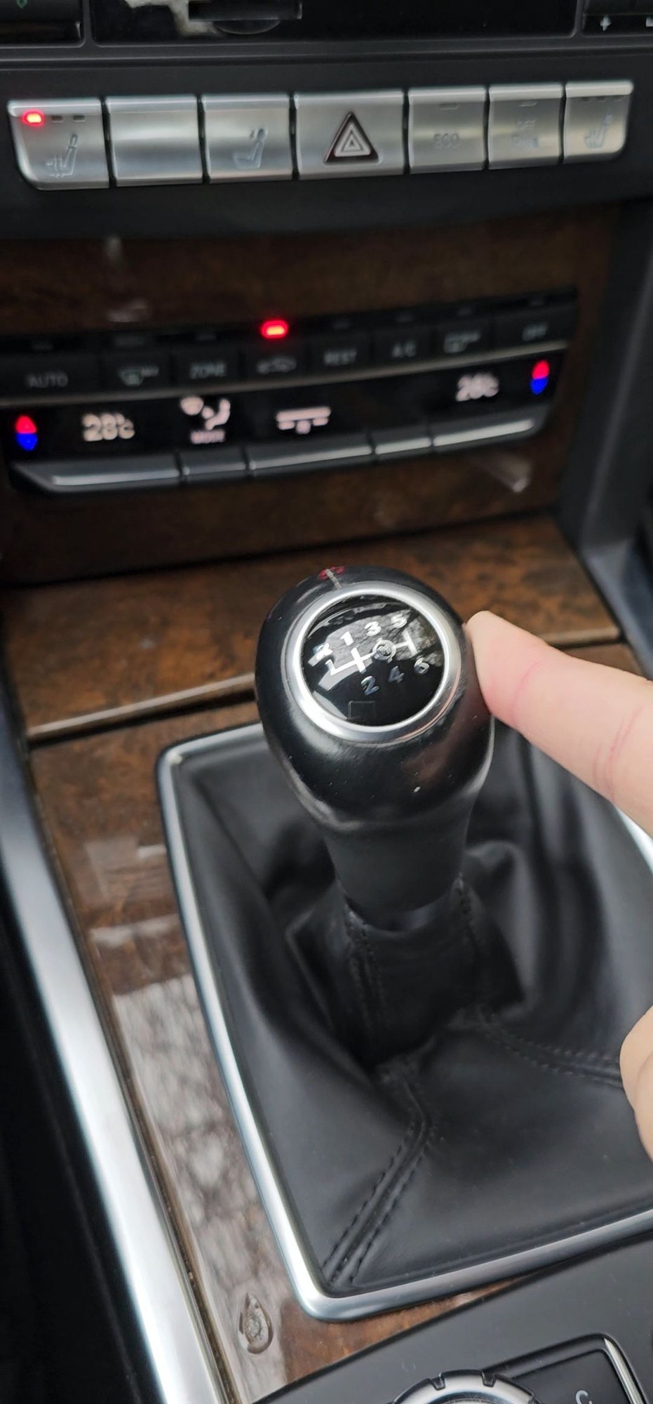

Hi everyone,i have a gearbox problem on my 2013 facelift E220 CDI Rear-Wheel Drive currently having 211000 km on board.What causes vibration on gearbox? It's even more when I bring the stick to the left or the right side in neutral, gear shifting are completely without problems. When i press the clutch on and off nothing changing, same vibration. Also when I start driving in 1st gear when clutch pedal is up it's causing a huge vibration and shaking to the car. But if it'sdownhill then absolutely does not do anything, and this only happens to 1st gear. First idea that's coming to my mind is that gearbox mounts, what else can cause this vibrations? Thanks for any advice 🙏

old rubber.... now chewing-gum
-1- Easy ...:
2x engine + 1x tranny mounts
Parts + labor: from $500 to 1000.USD
-2- The next campaign will be to work on your prop shaft couplers, center bearing and differential.
