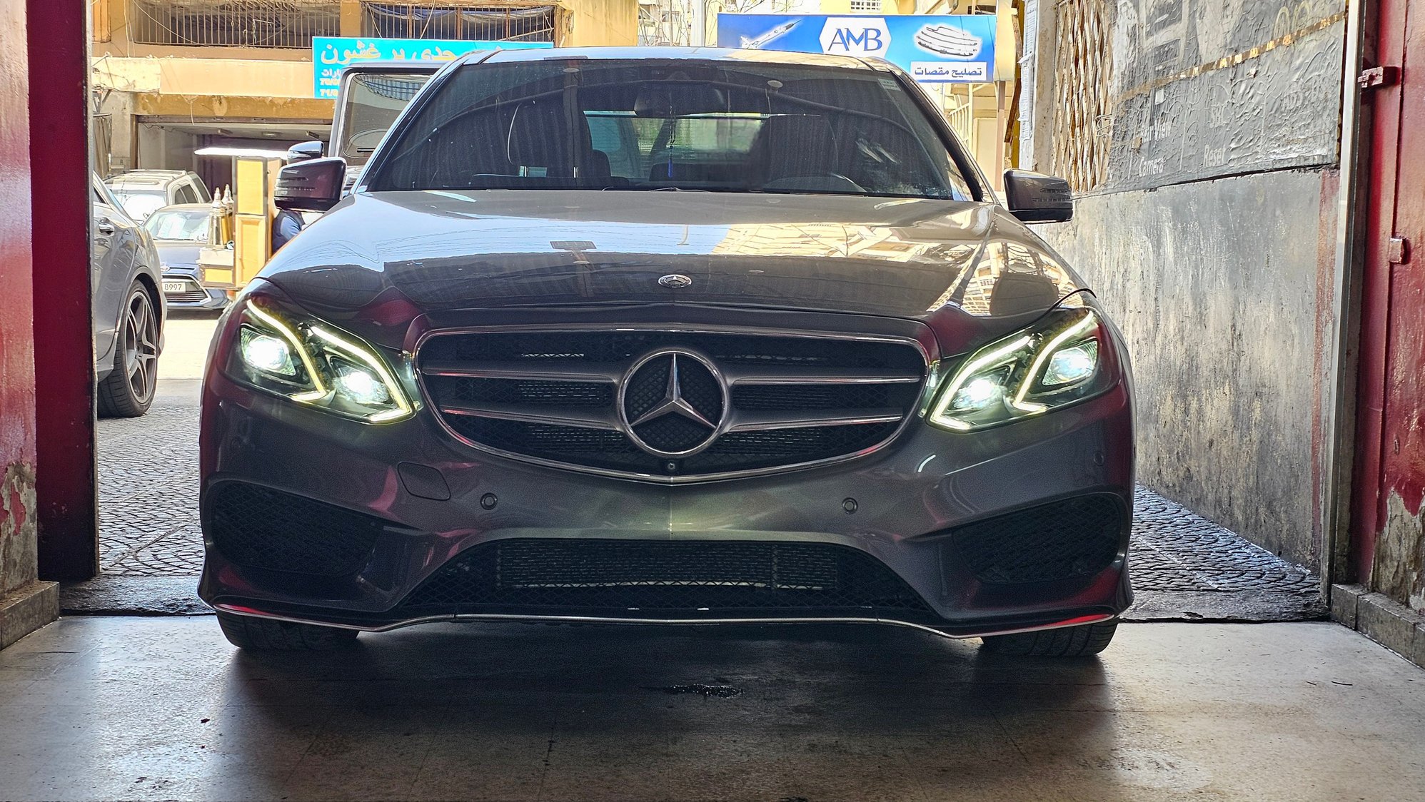

I have this 2016 E350 that had its headlights converted to the multibeam headlights. I don't know why but they seem dim. Here is 2 photos and a video
NOTE: The photo and the video are brighter than the actual brightness of the headlights, the actual brightness of the headlights is lower. Please any advice / help. The car is a US Spec car and the headlights fitted are Japanese right hand drive headlights. That is why the beam feels mirrored. Also note that the headlights are a dimmer than what is in the video.

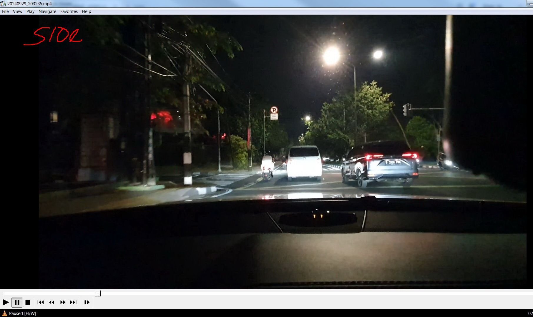

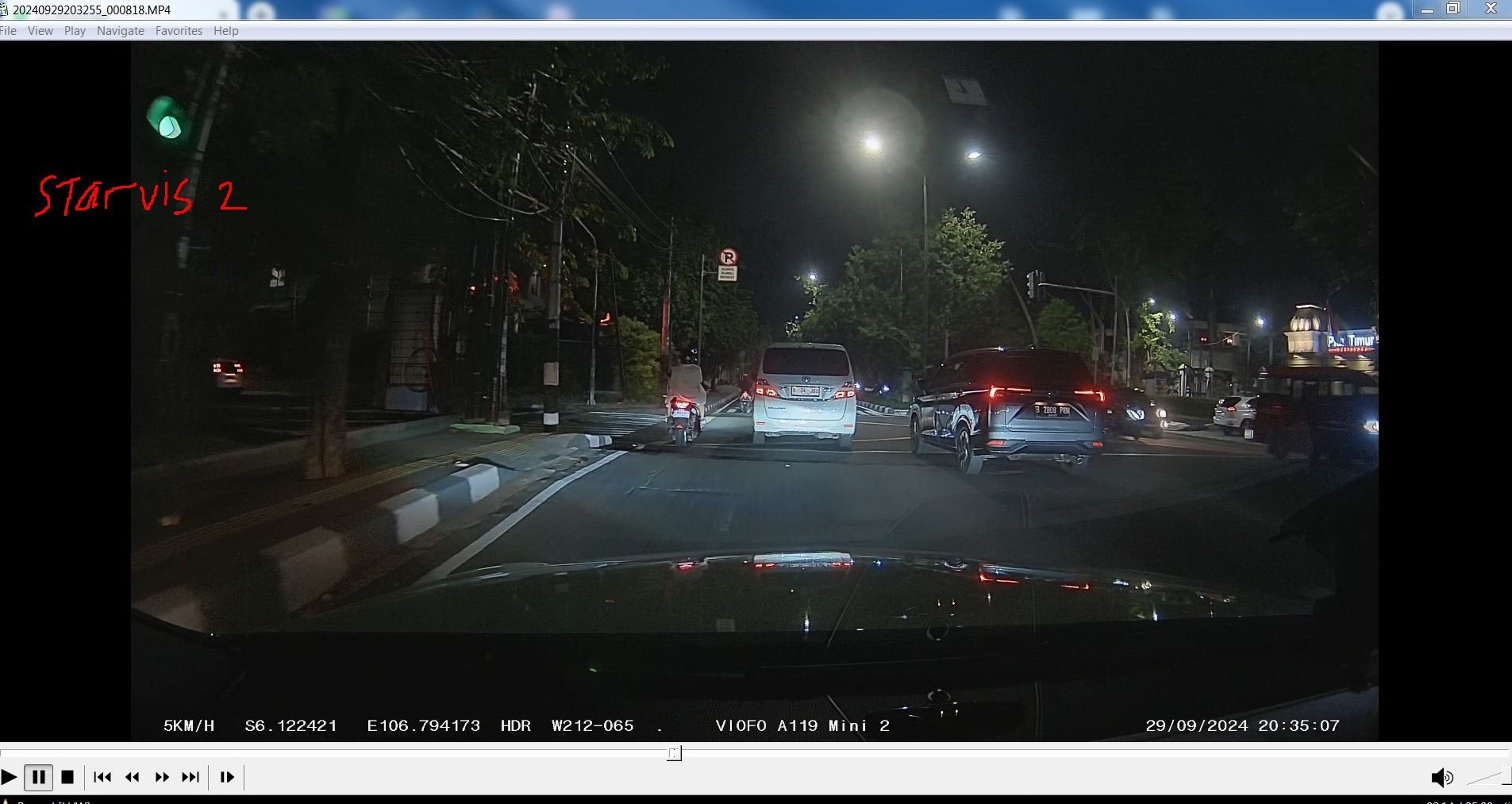

Here is my low beam stock headlight if using cellphone camera , Samsung S10e
If using Starvis 2 sensor DashCam, Viofo A119 Mini 2
Samsung S10e
Starvis 2 sensor

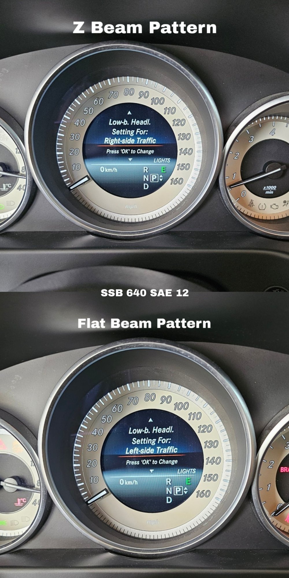

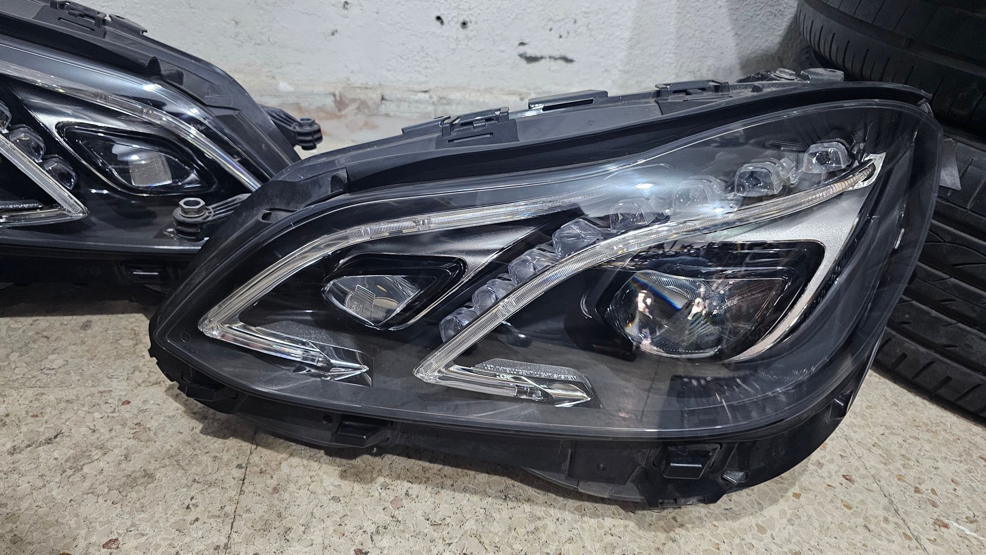

Hellooo , thanks for your reply. As you said my headlights are the exact ones like yours, same beam and yes they are w212 original mercedes. My headlight output is the same as yours with the footage of the dashcam. The footage of your dashcam is the most releastic output, my headlights has the same output as yours. But do you think it should be like that? I mean i think the xenon headlights of the pre facelift w212 is more brighter.
Here are some pictures
The car after the installation
The headlights ( original headlights [Used but in clean condition])
The Programming
The Programming
The beam option
The beam option

Helloo, yes, programming had to be done in order to activate intelligent headlights feature such as corner illumination and when the light turns with the steering.
