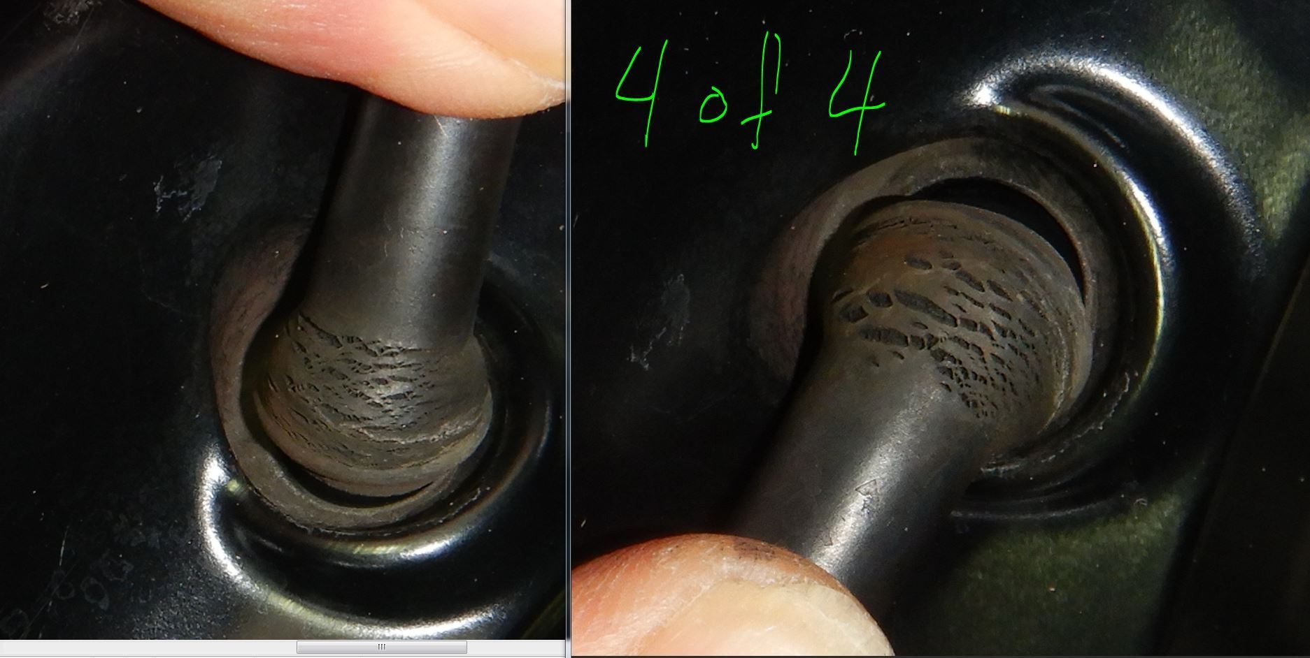

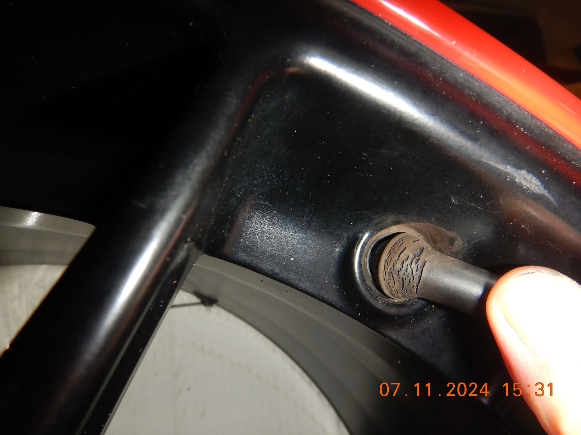

I am no more on rubber valve stem, but I bought 4 spare wheels recently and the age of the wheel is year 2020 production date and the rubber stem tire valve is surely 2020 as being oldest too.
Here is their condition :
Wheel 1 of 4
Wheel 2 of 2, same condition.

Wheel 3 of 4
Wheel 4 of 4
Now, go and inspect your rubber stem tire valve.
