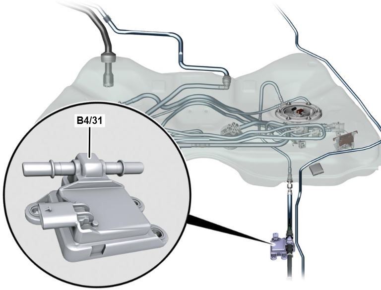

Based on MLE350 flex fuel, it is at the top of the fuel tank. Code 929
https://www.benzworld.org/threads/ml...094554&slide=0
If W212, it seems under the tank, close to it : https://mbworld.org/forums/e-class-w...ml#post8010090
If W204 C class, its close to tank,
Basically it is CLOSE to the fuel tank or at the fuel line.
https://mbworld.org/forums/c-class-w...78-solved.html
Looks like this :

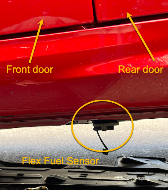

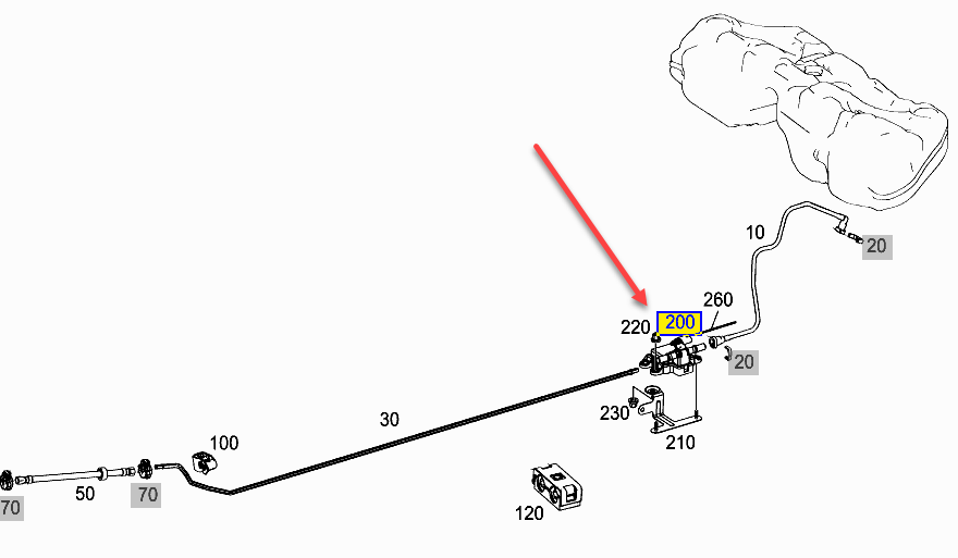

On the W204 C-Class, the sensor is fairly easy to access. You just need to remove the plastic splash panels underneath the driver's side. From the diagram, it looks like the sensor may be in a similar place on the E-Class. But read the entire thread that @S-Prihadi provided because it shows the short is caused by water and how to fix the problem.
Flex Fuel Sensor on W204 C-Class
