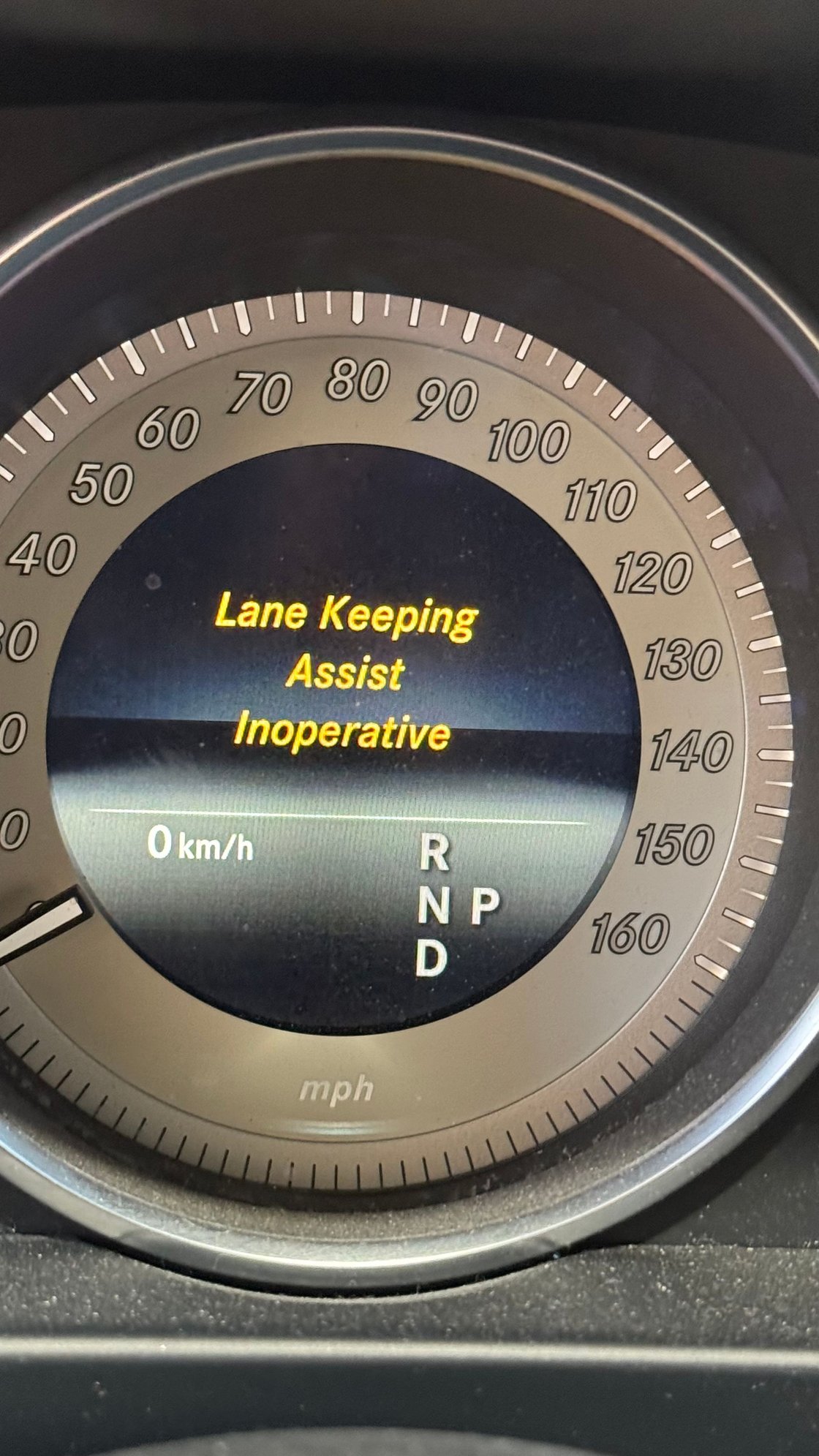

do you see the big message displayed about "Lane Keeping Asz..."
this suggest a bad CAN bus connection = luck!
Here: if only your tranny was bad, you would not get this message.
Conversely this bad CAN message hints that your tranny and a bunch of other modules are not "connected" .
Give us a complete chassis scan so we can see thr whole network... there's a bad guy in there... i don't think it's your tranny -
That may be your luck to find a shorted pair of wires for free.

Very well observed, but i should have elaborated my thread better…

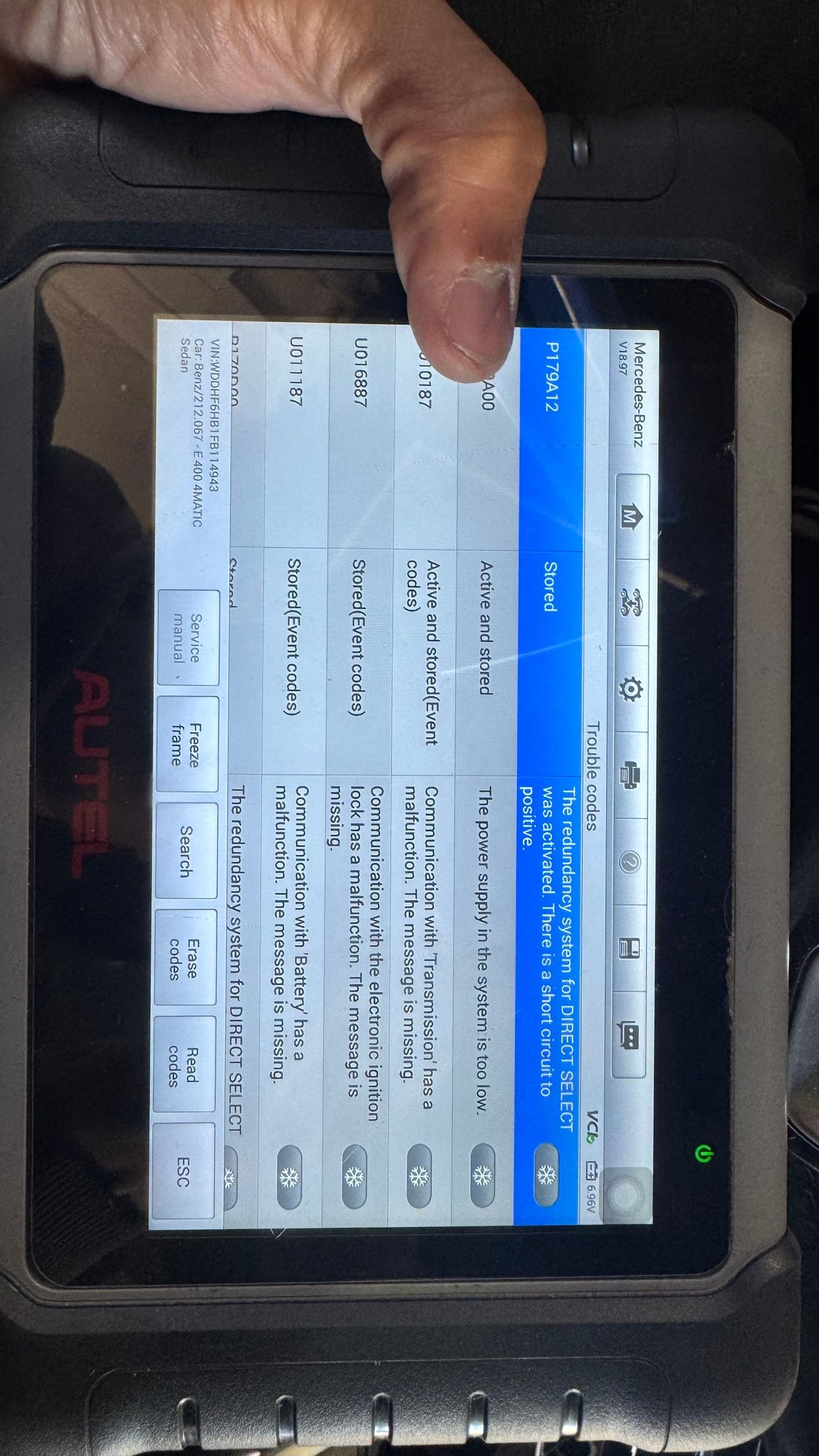

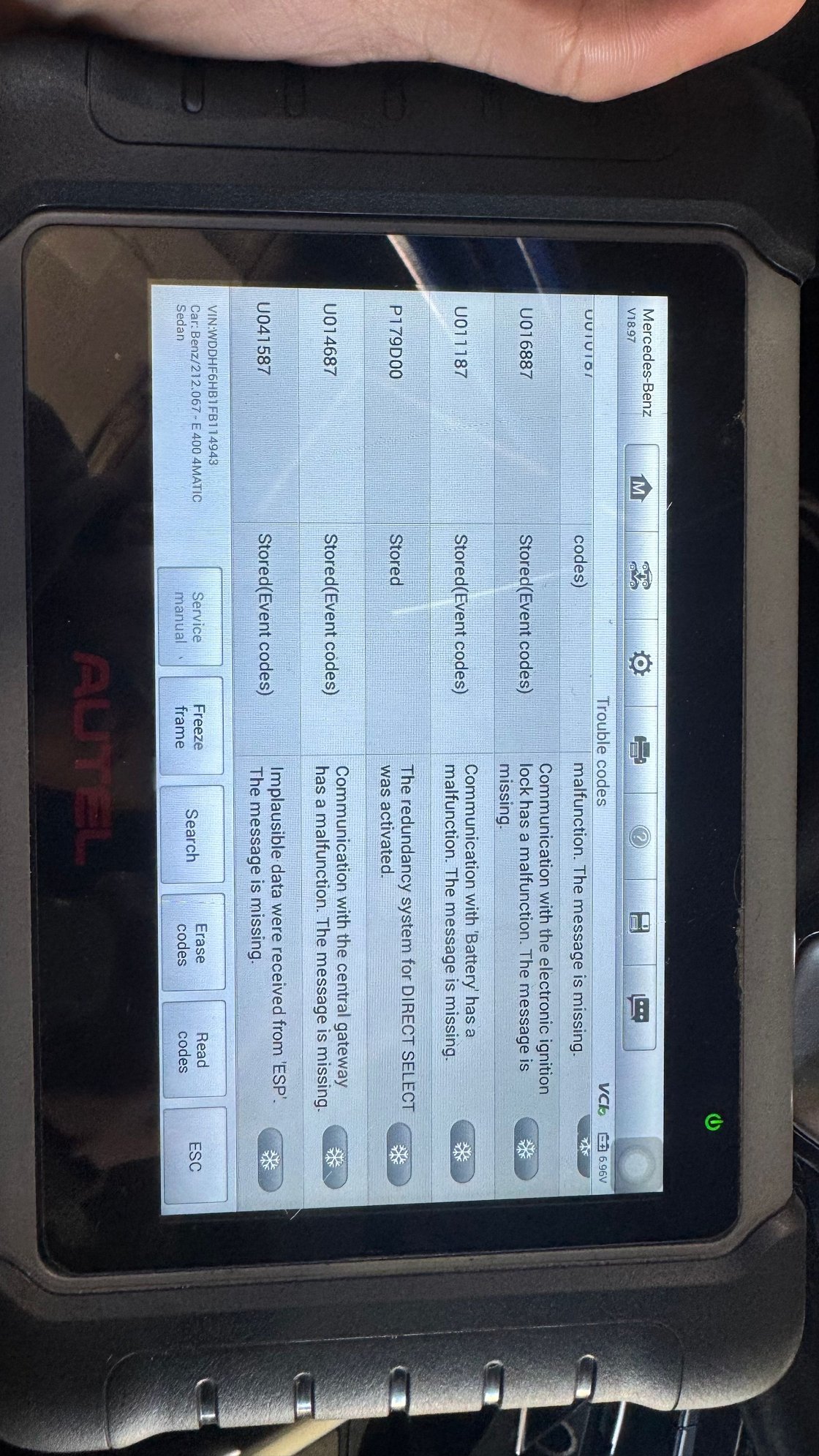

Should have mentioned that the car doesn’t start for more than 3 months while i was waiting for parts, with that the battery was very low when i took the picture, had a lot of codes i wasn’t considering… Cleared the codes and replaced the battery, codes didn’t came back
I don’t have a very good scanner, much less a star diagnostic tool, but ill leave a couple of pictures of the codes read initially with my autel
Battery Voltage displayed on top right corner
Should as well have mentioned that, yes i can hear the transmission shifting, or better, trying to shift since is a longer sound than when would normally do. I performed the “range sensor teach-in” function and completed with no issues, like the car and the diagnostic tool were recognizing the shifts.

Ok, got it!
More good news: you canot expect any module to be reliable on 6V power.
To diagnose your going to need a decent voltage above 12V min.
Under 10V the network goes sideways... untrustworthy.
Disconnect all power
then reconnect to a good 12V power
reset codes
rescan fresh faults
Also I need to know what module flags "no connection to gateway".
We need to know what module calls what fault... not just an A to z alphabetical list.
BESIDES you can easily use this scanner to connect with the TCU for interactive status and live tests.
That will help understand what happening and not happening.
