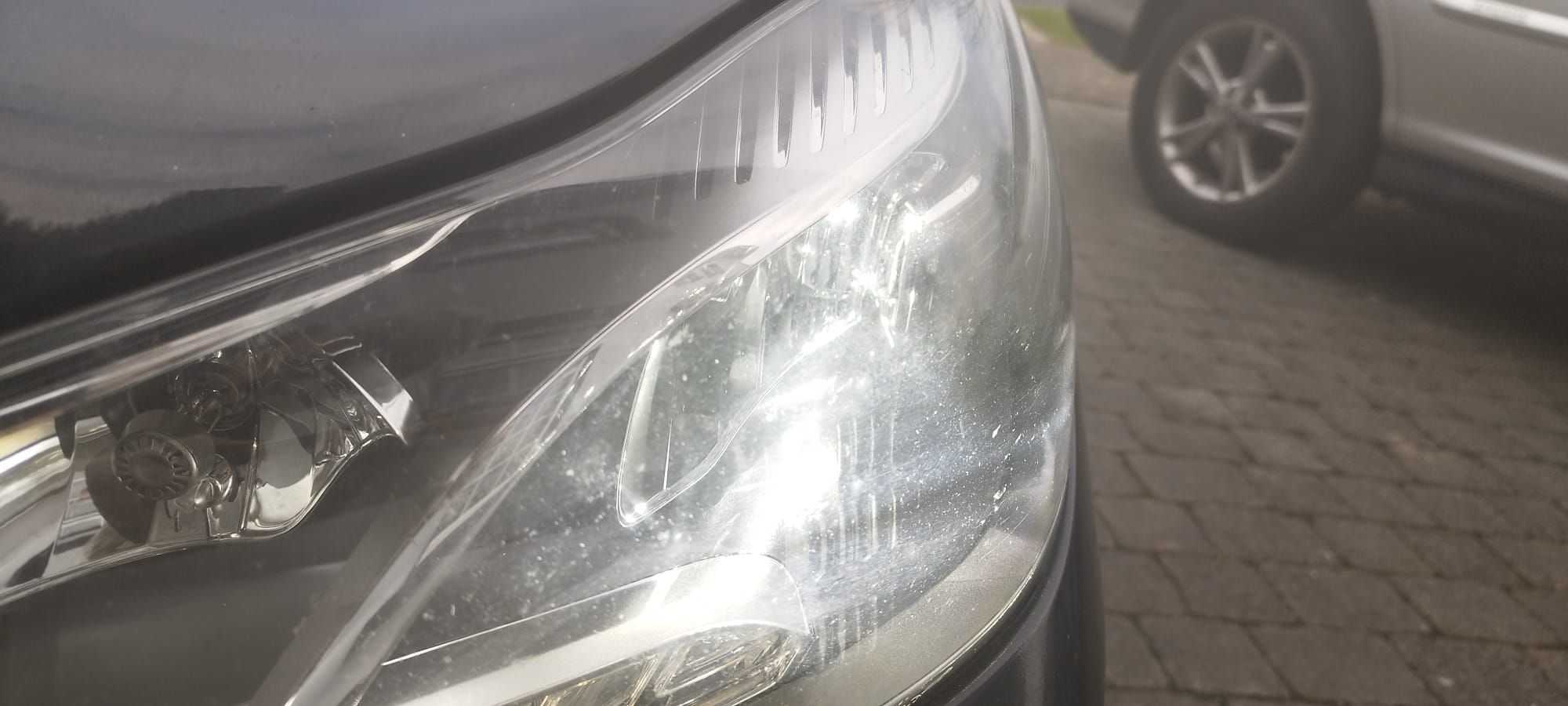

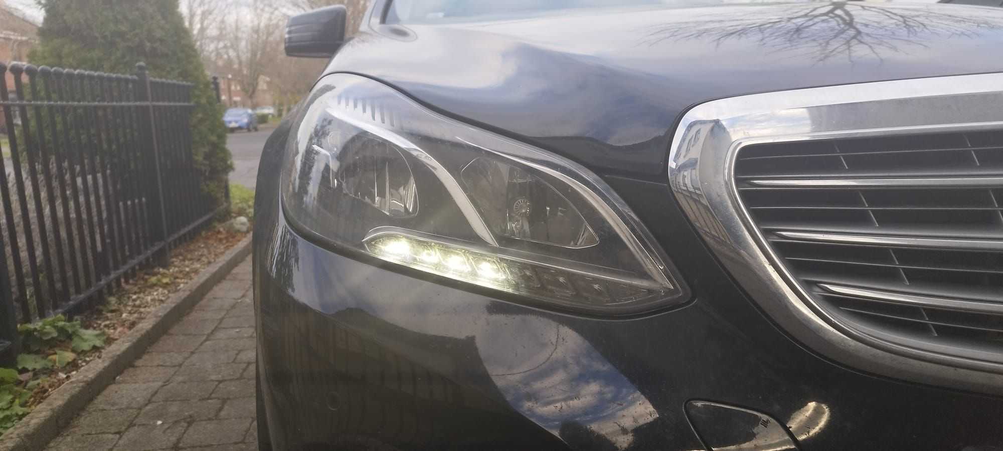

Old Dec 10, 2024 | 07:04 AM
kelly.paul's Avatar
Joined: Dec 2024
Posts: 5
2002 Mercedes-Benz E-class
Left side working
Left side working
Bulb on far left of image not working here
Old Dec 10, 2024 | 07:12 AM
trigital's Avatar
Joined: Dec 2011
Posts: 1,692
Likes: 488
From: Spain UTC/GMT +2 hours
W213 All-terrain
Of course is independently fused...
