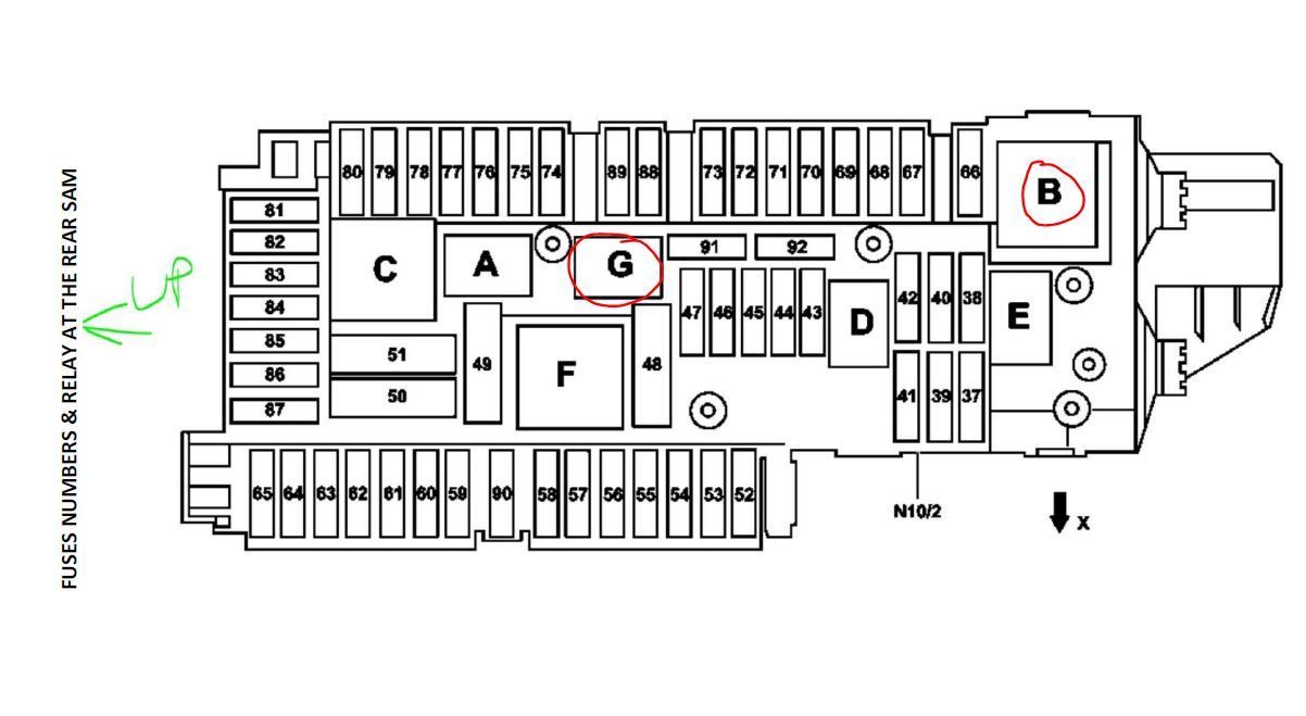

I have an S212 facelift E350, and all the power sockets have stopped working, possibly coincidentally, as has the command screen.
I've checked the fuses 71, 72,76, 26 & 11 and they are test ok with a multimeter.
The car starts and drives fine.
Any ideas what to check next?

Check if these relays actually triggered to be ON when Ignition Key in accessories mode.
Ground to those fuses should read system battery voltage, 12+ volts.
Based on my car a sedan face-lift too, but it would be identical to our wagon.
The Audio/Command thingy, later yah.

In the end, I found that the issue was that both of the USB chargers I was using to test the power sockets were faulty.
