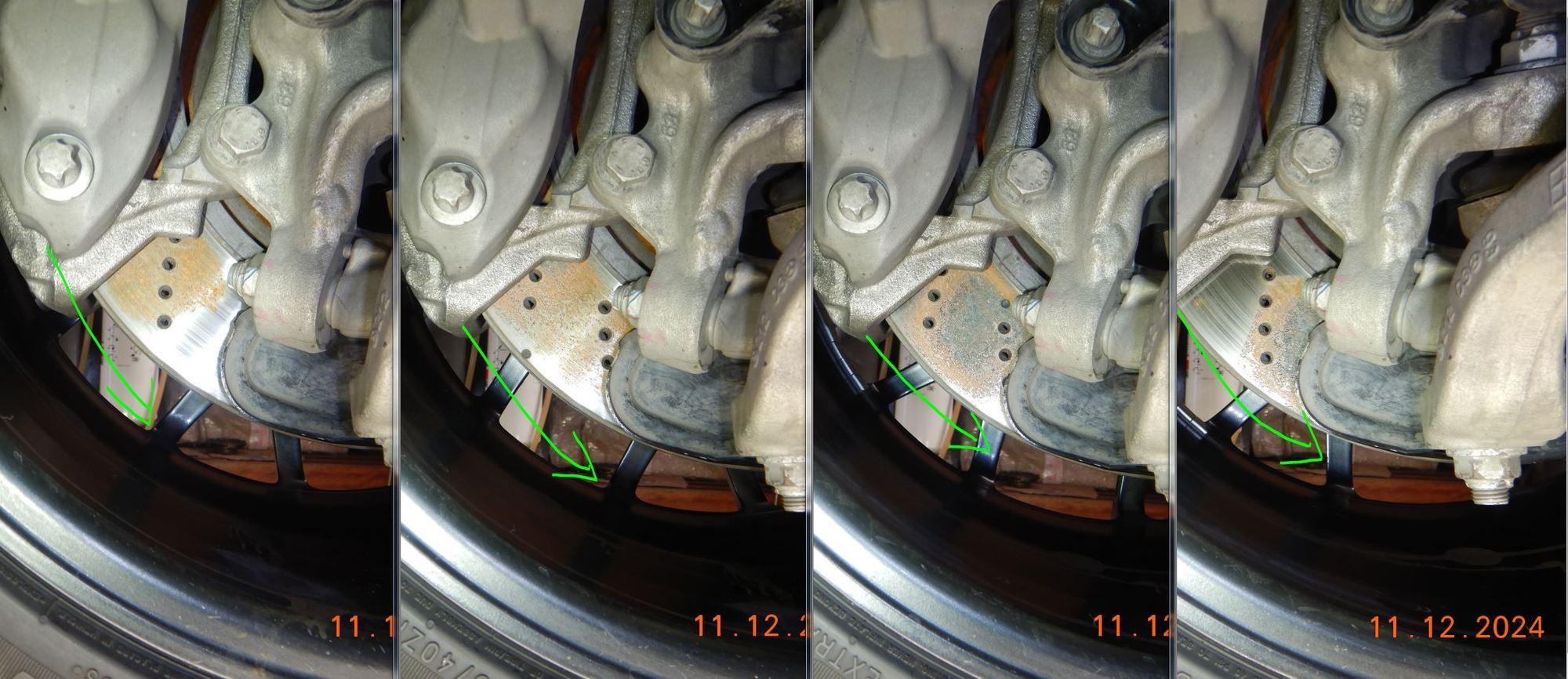

When I failed to dry the brake pad by driving around my house area with brake pedal mild touch on disc rotor, below will happen.
This is simply a 12+ hours duration. Wash the car at night 5PM to 7PM, the next day mid noon below is what I get.
Using green scotch-brite pad can only clean it so much

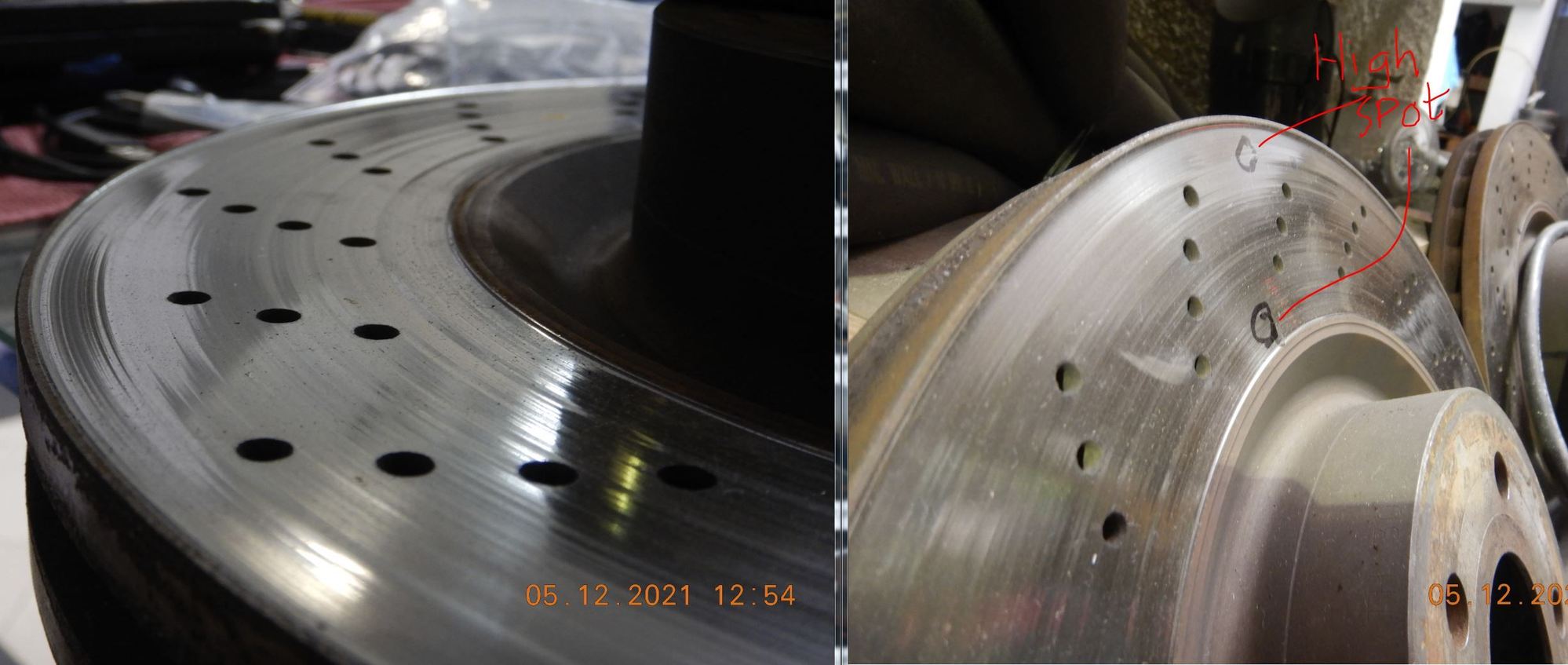

I was also cleaning every damn cooling holes on the front disc rotor, as when and if they rust and creating micro high spot, it will attack the brake pad and long term
you will see disc rotor un-even grooves like below : My old set

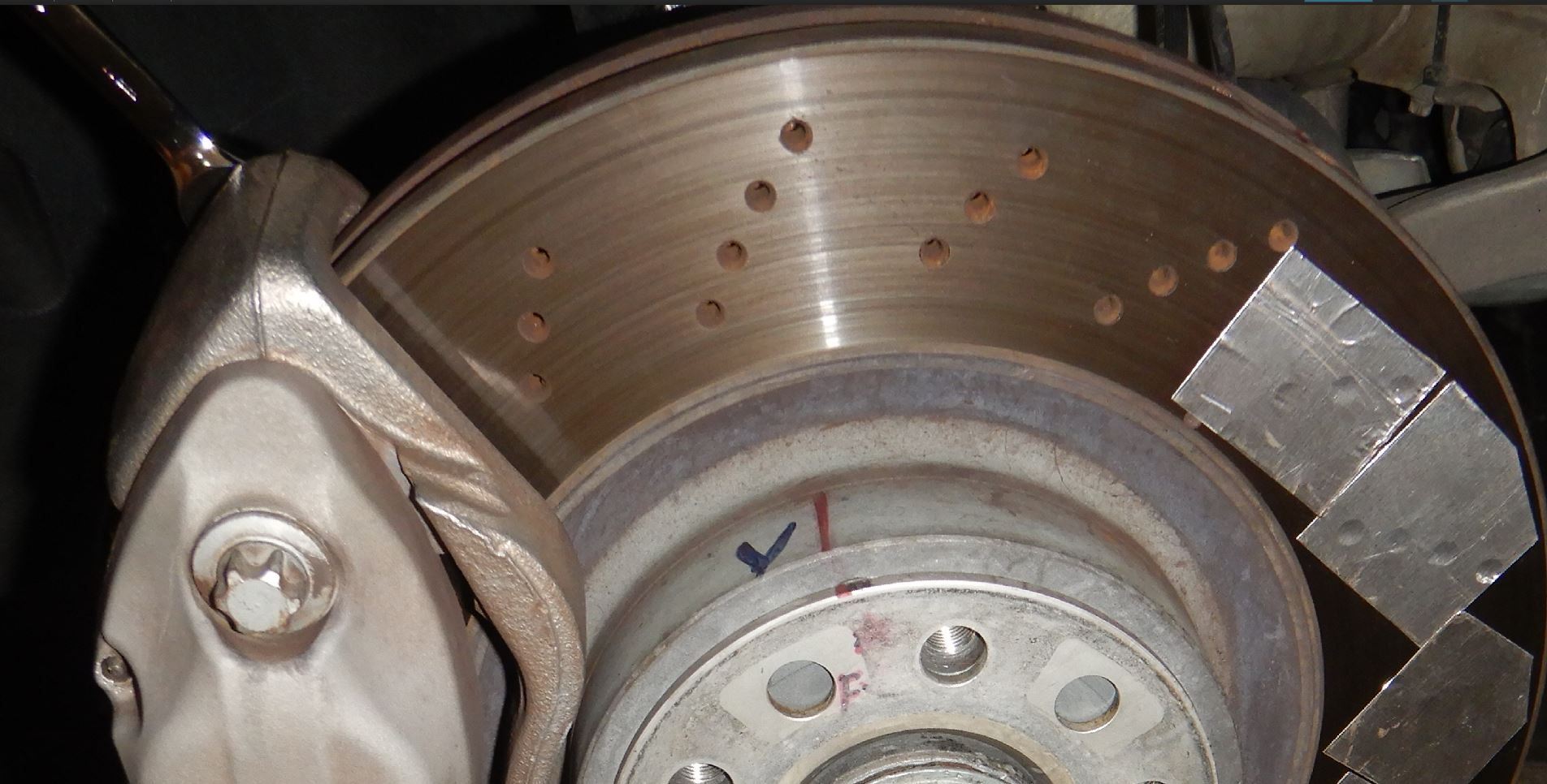

I have replaced my FRONT disc rotors ( photo above ) in 2021 at 34,000 KM, now I am at close to 43,000 KM so 9,000 KM old front rotors today..
I want to keep disc rotor as smooth as possible till its end of service life. Now it is smooth. Last month October photo archive at 9,000KM of use.

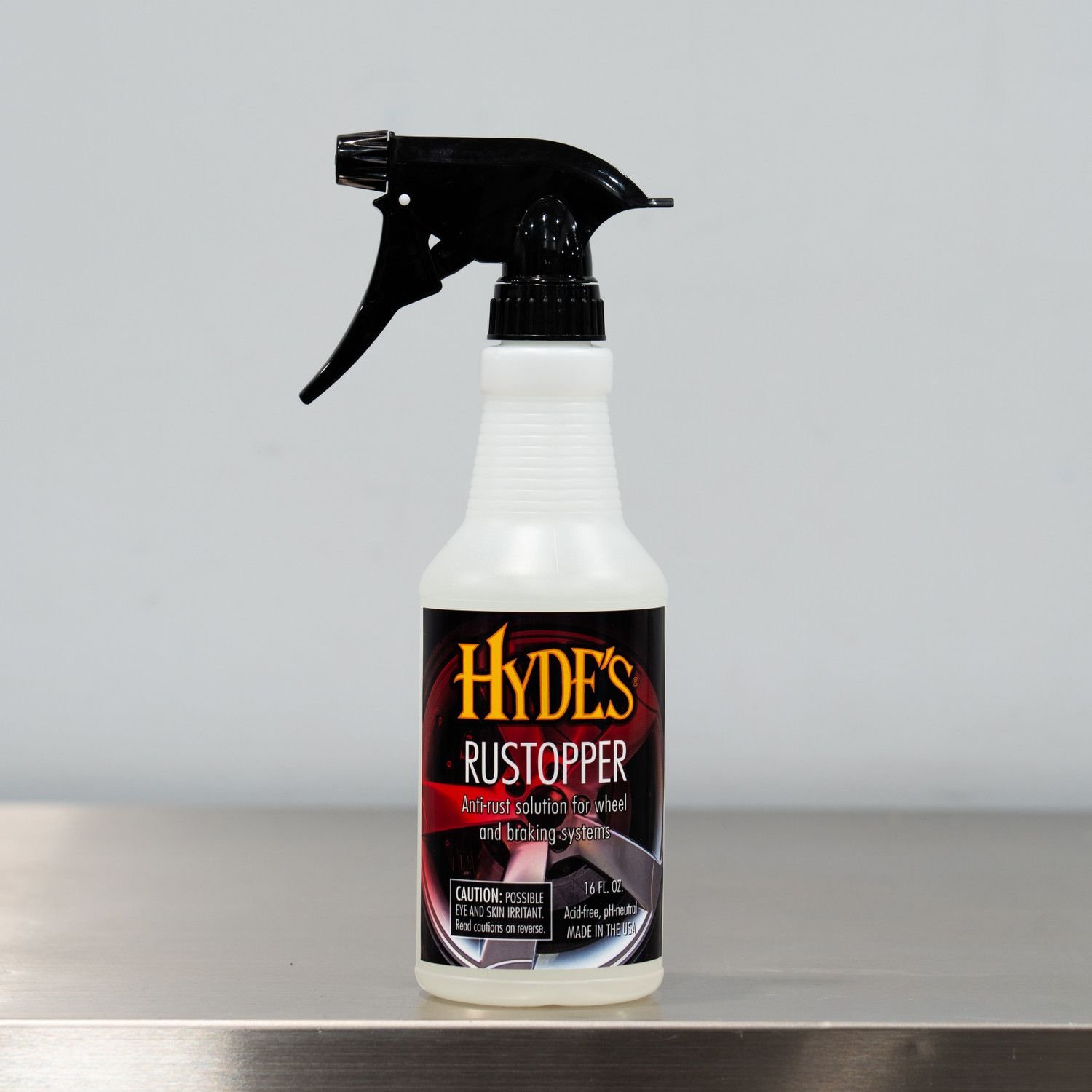

A product called Hydes Rustopper may be of interest to you.

Thanks Steve, I can't get that in my country
