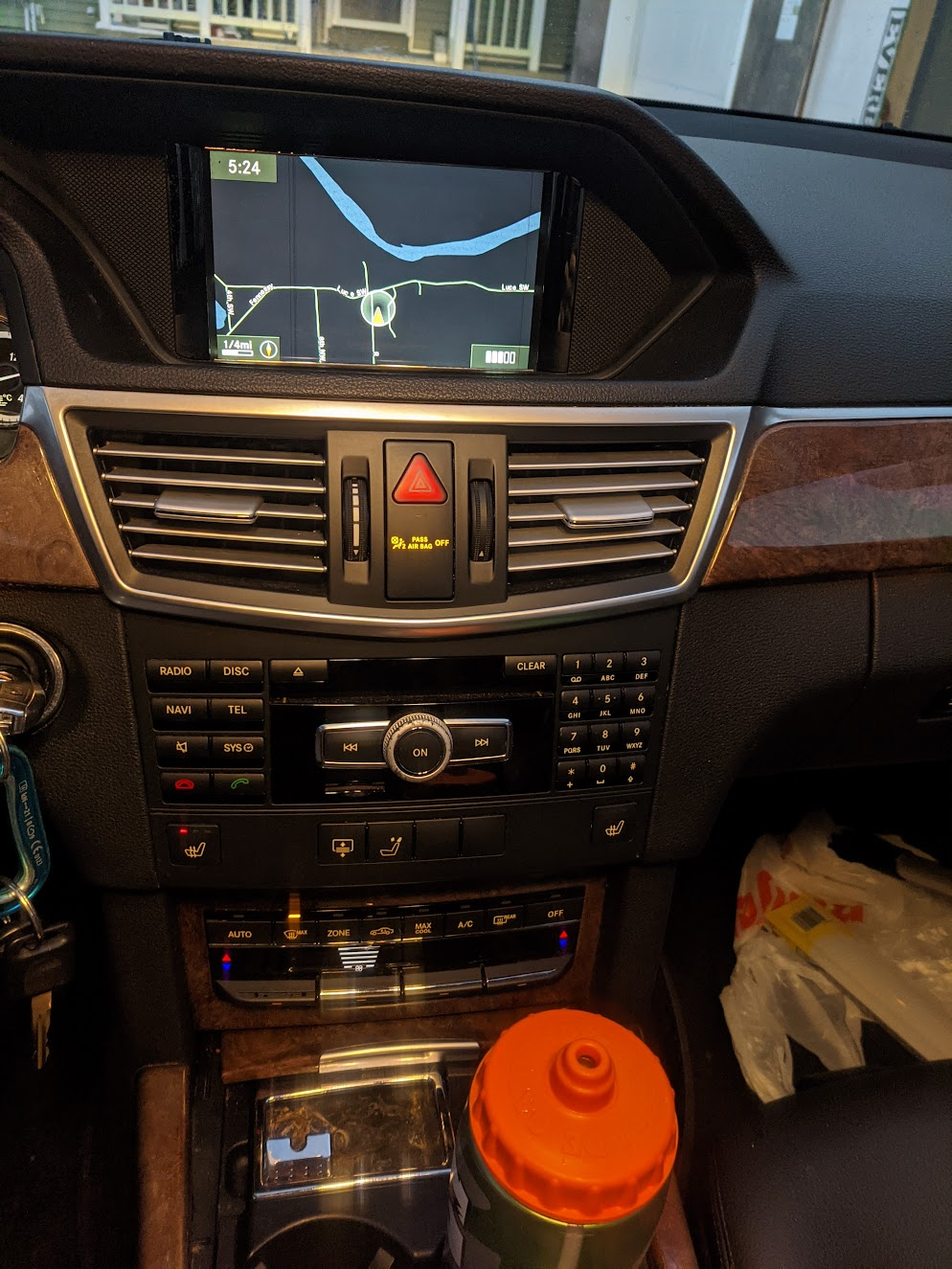

I am trying to find a replacement knob as mine is worn for my 2012 E350. Mine is worn. Junkyards around me don't have E350s unfortunately, though I set a notification that will trigger if any show up. I tried taking the knob from a 2011 C300, and although it worked fine, it's about 10mm too long. eBay has a bunch of on/off button replacements, but that's not what I'm looking for here. Does anyone have a part number or maybe a list of vehicles this stereo shipped in so I can broaden my junk yard search?

2012... is that an NTG4.0 type COMAND head unit?
That rotary knob is part of the facia sub-component...
none of which I think are available as spare parts.

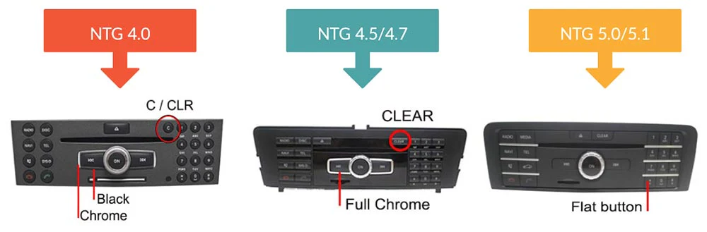

I think it's NTG 4.5:

Ok, after posting this I started researching again. The 2011 C300 I saw in the junkyard had an NTG4.0 stereo, hence the almost-compatible knobs. This site lists NTG4.5 stereos from 2011-2015:
  • SL550, SL63, SL65
  • C250, C300, C350, C63
  • E350, E550, E63
This bums me out a bit more, because there was a 2013 C300 at the junkyard, but sadly the whole stereo was gone from it.
