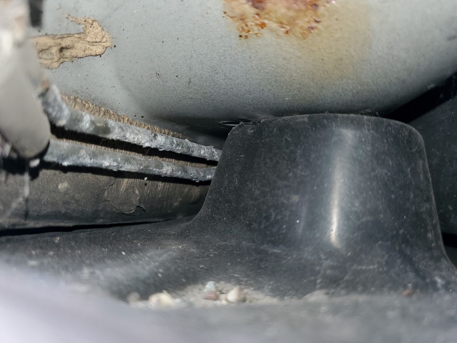

I tried 3 different products all around the car recently. I'll see how things look in the spring to see how they worked. Im thinking just using Fluid Film would be fine.
- Fluid Film. Sprayed great using the straw included. Left a nice coating. Was able to stick the straw under the panels under the car to spray down the brake lines that run along the side. Only negative is it does stink like a zoo.
- Blaster Surface Shield. Sprayed great but no straw included. When i did try using a straw they just shot off so spraying inside holes wasnt easy.
- CorrosionX HD. The stuff leaves a THICK film. Im seeing sand and small rocks imbedded everywhere. Probably should have used the CorrosionX XD instead.
From the looks of it I think this coming year i'll go ahead and replace the section of rear passenger brake line where it runs under the car. The drivers side looks much better leading me to think the drivers was replaced at some point.

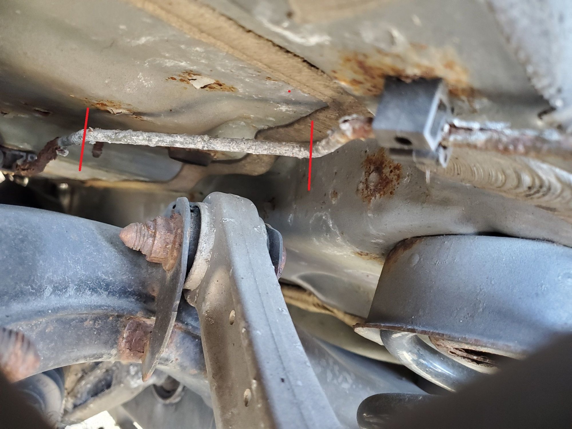

The brake lines look fine for now. Thats why I went under to take a look to see if they were like the section I had to replace. The sections under the car will be easy to replace with hardly any bends. I'll grab another roll of nickel copper line. For the rear section i replaced i bought a 12' roll for $6.99 and used around 6' of it.
I still have the section I removed to look at. Can tell what is just surface corrosion or what is rusted through. If I replaced everything on my 15yr old car that had corrosion and rust I would end up with a new car.
Heres the old line and this section still looks good, just surface corrosion.
Now this section is rusted and cracking. Clearly needed to be replaced.

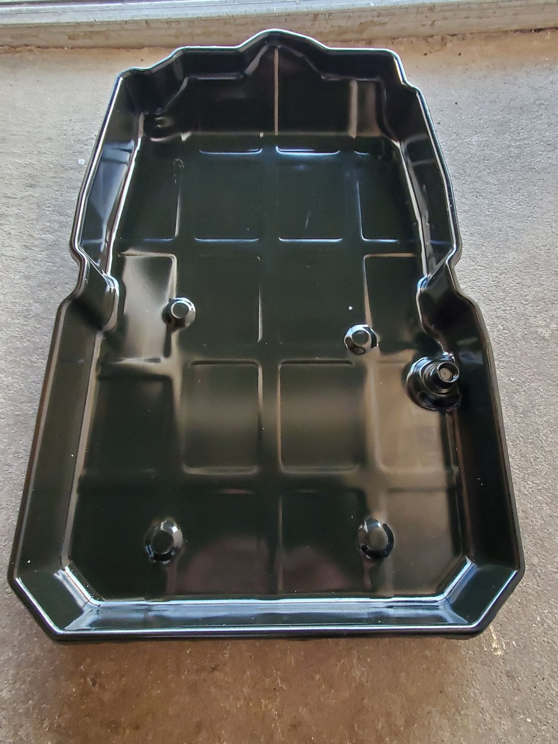

Good example is the rusted transmission pan I recently replaced. i saw all the rust and thought it would start leaking any day. When I removed it and inspected it the inside looked fine. I even took a screwdriver and hammer to it trying to make holes in it and couldnt. Glad I replaced it anyways, but i see it wasnt really critical that I did.

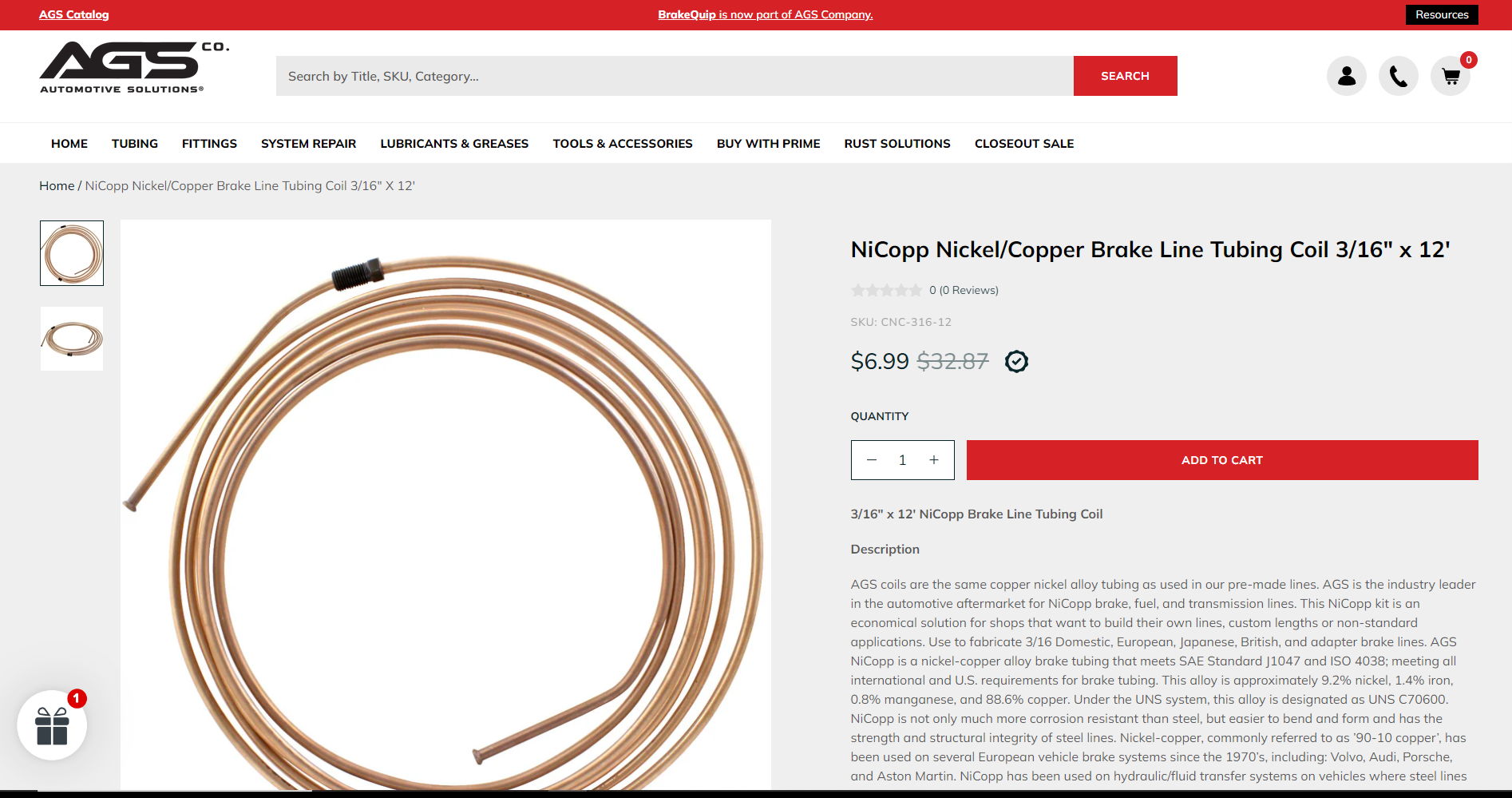

If I felt i couldnt make the lines myself i was looking at linestogo. Seems like a very good price. I tried it myself with the nickel copper rolls and it came out good though.

I wonder how a Mercedes dealer makes the lines. I know the lines themselves come in rolls. The part #'s are the same for many other models so its not exactly specific. Do they bend them by hand or do they have some automated machine that bends them? The lines on the car look too perfect to be done by someone.
I didnt go with stainless because i read they are very hard to flare properly and im my case I flared the old lines still on the car.

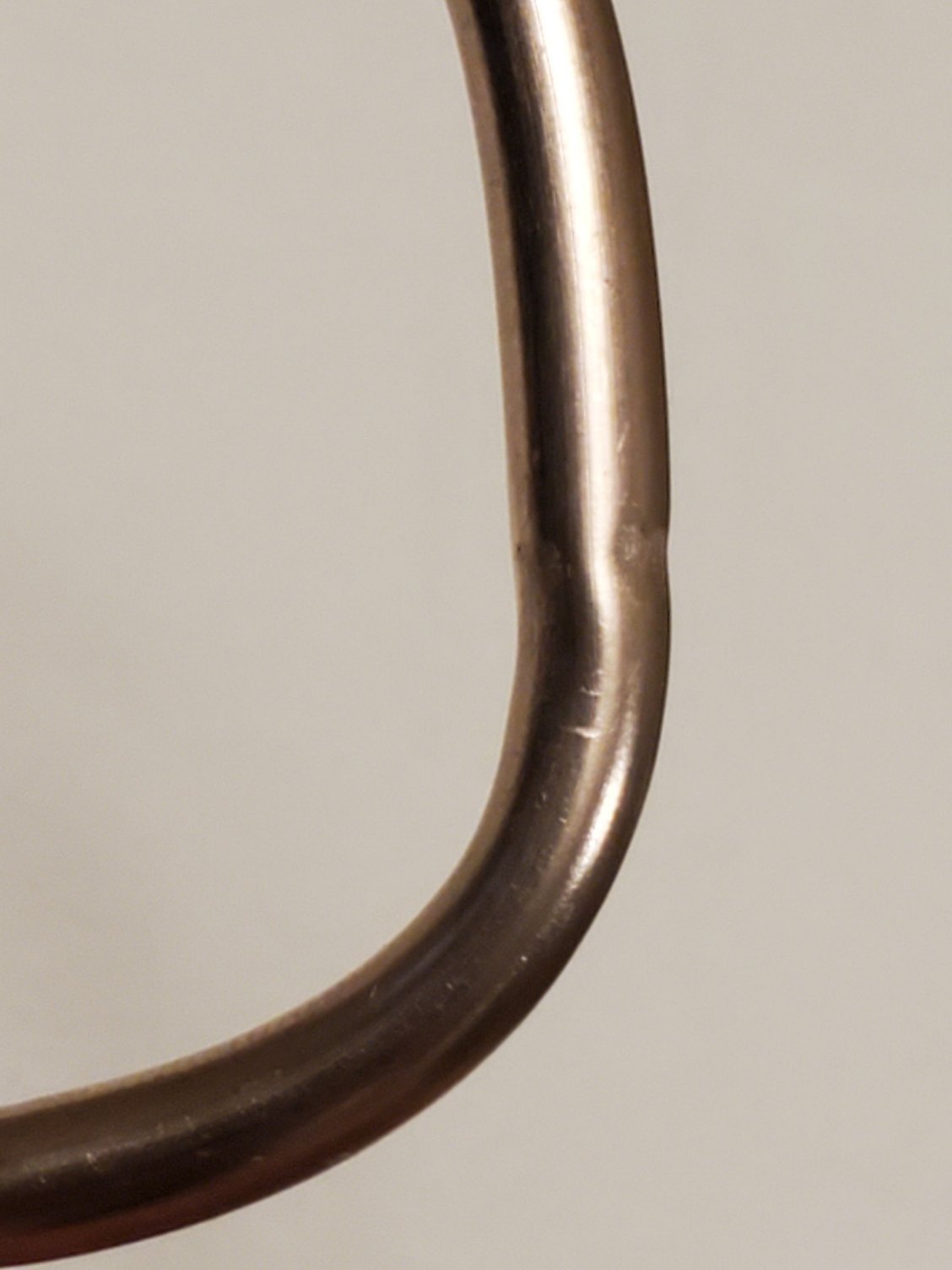

If someone knows of a hand held tube bender that works perfectly id like to know. I bought one off Amazon and it worked but it kept leaving indents on the line. I'd like to get my 90 degree bends tighter. i kept my old line to practice with and try and get it better. I wouldnt mind re-doing the section I installed.
I just ordered another 12' roll on AGS. Came out to $7.43 with tax, free shipping. This is the same line i already used. I did buy some fittings from them before but they didnt look that good so never used. used the Mercedes fittings instead.
