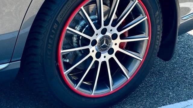

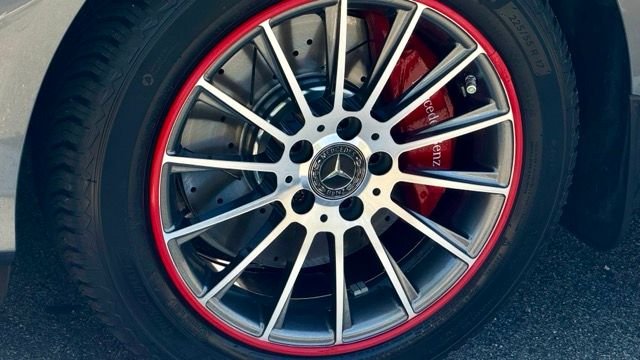

Hello, is it possible to replace the front brake solid rotors with vented rotors? I have a 2016 E350 4Matic wagon with Luxury trim. It's not a Sport so I'd like to be sure the upgraded rotors will fit. The solid front rotors have warped and I'm wondering if vented rotors would remain cooler and not warp. I'd likely get non-Mercedes brand rotors, such as Zimmermann. Thanks.
I know that this is an old thread, however I just stumbled across it. The answer is absolutely.
I just changed out my OEM rotors and brakes because of brake judder issues every couple years. I have a MY 2017 E300 Luxury model with 17” rims which you don’t see often these days
I ended up going with Power Stop Evolution Z23 Front and Rear Brake Kit-Drilled/Slotted zinc plating coated Rotors & Carbon Ceramic Brake Pads. They have 342mm or 360mm, mine was the 342 mm.
Primary Focus: Excellent daily driving, commuting, light performance upgrade.
Target Vehicles: Broad range of cars, trucks, SUVs, and crossovers that are used for everyday transportation. This kit is for drivers who want a significant step up in performance, cleanliness, and quietness compared to their vehicle's original factory brakes.
Brake Pad Compound: Carbon-Fiber Ceramic formula. This is a very popular, balanced compound.
Benefits of the Z23 Kit:
Improved Stopping Power over Stock: The carbon-fiber ceramic pad formula provides a noticeable increase in braking effectiveness and a more confident pedal feel compared to most standard original equipment (OE) pads.
Very Low Dust: This is a major benefit for maintaining clean wheels. The ceramic compound is specifically formulated to produce substantially less brake dust than semi-metallic pads, keeping your vehicle's wheels cleaner for longer periods.
Virtually Noise-Free Operation: Engineered for quiet performance, the Z23 pads, typically paired with multi-layer rubberized shims, are designed to minimize squeaks and squeals common with some aftermarket or performance brake pads.
Excellent for Daily Driving Comfort: It offers enhanced performance without sacrificing the smooth, predictable feel desired for everyday driving, stop-and-go traffic, and general commuting.
Corrosion Protection: The drilled and slotted rotors included in the kit usually feature a zinc plating or similar coating. This helps protect against rust and corrosion, extending the lifespan and maintaining the appearance of the rotors.
Complete Bolt-On Solution: Designed as a direct replacement, these kits typically include everything needed for installation: brake pads, drilled & slotted rotors, and premium stainless steel hardware clips.
