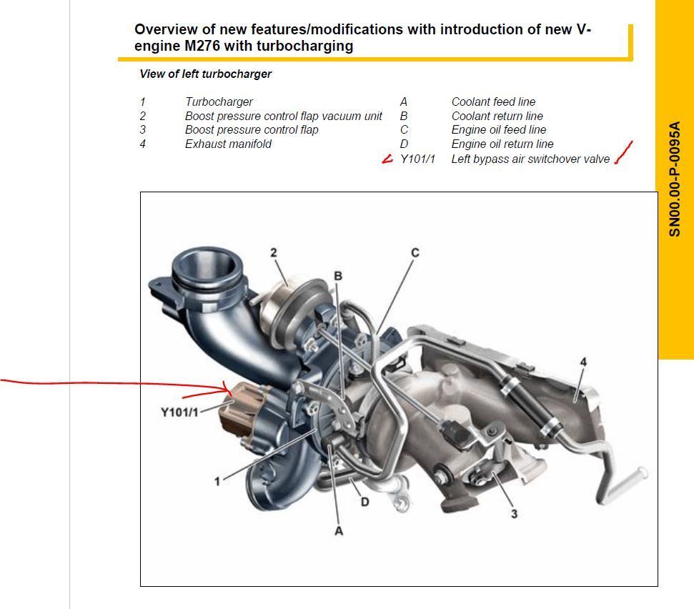

There is another pressure control device speific to only M276.8 turbocharger, but on the intake side ( cold ) and not like wastegate which is on the pressure side ( hot )
It is called bypass air switchover valve
