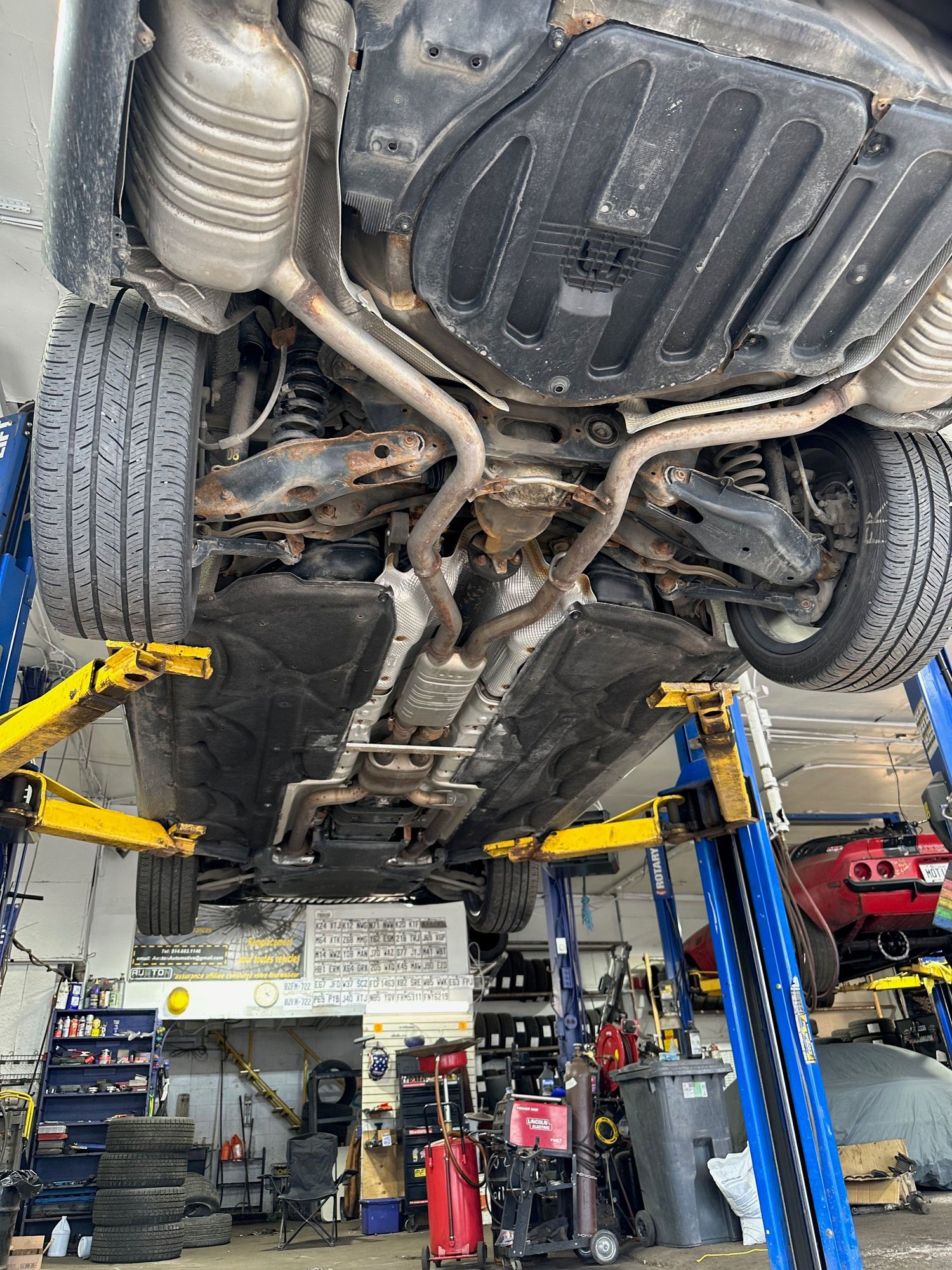

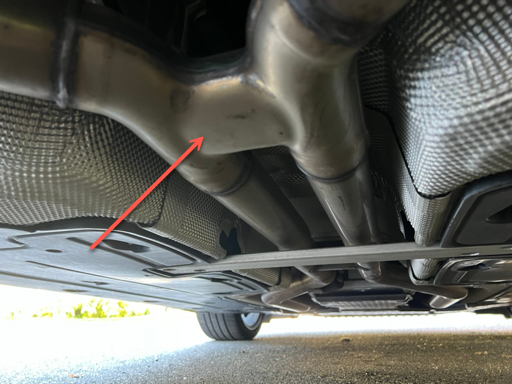

  • Does your exhaust have a cross-over pipe? (See pic)

  • I do not have a cross-over pipe, I will upload a screenshot of the bottom of the car if that helps

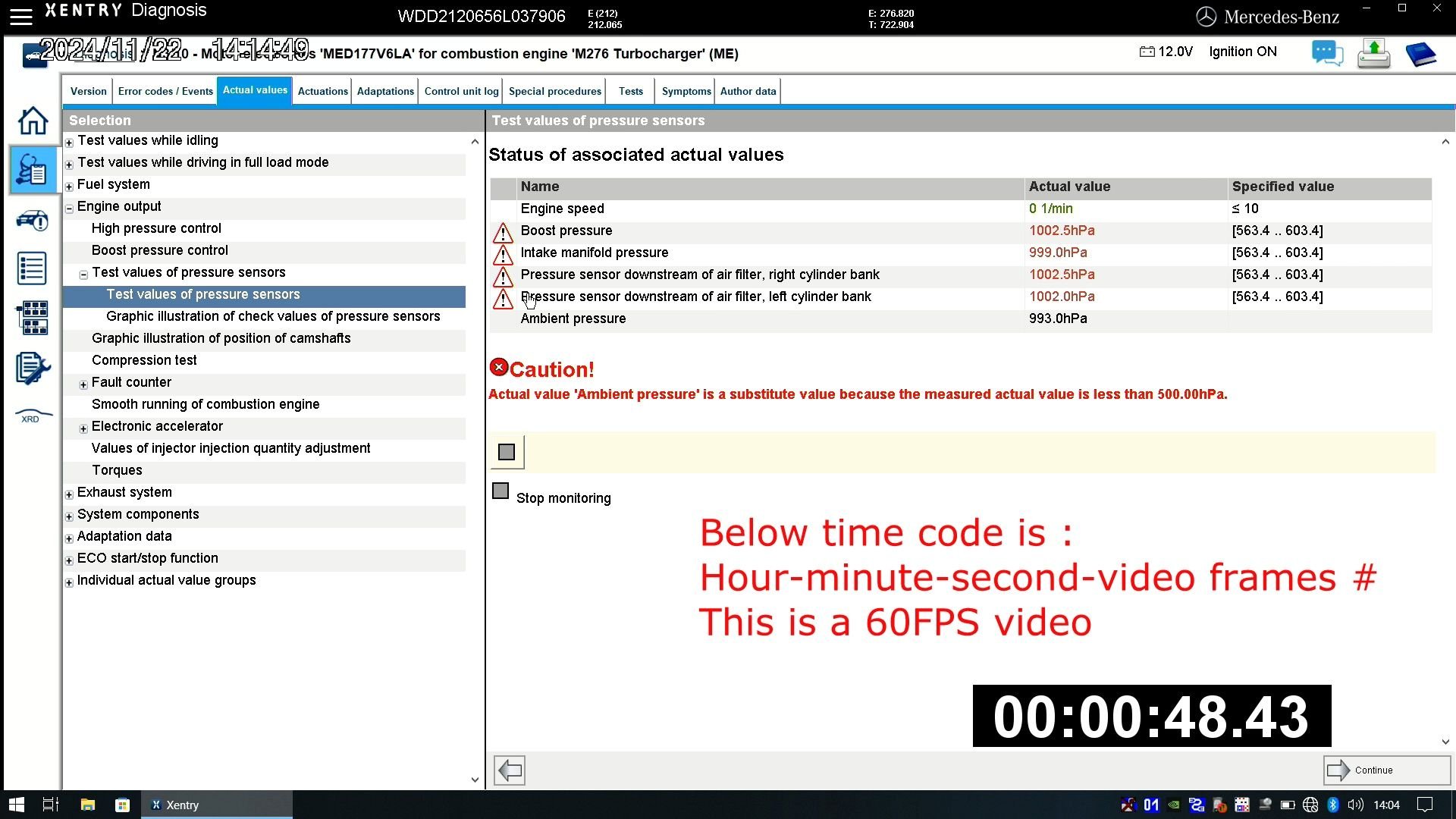

I don't know what is the expected boost level of a stock E400 (I can make a log on mine latter on this week) but your is maxing out at 53 kPa (0,53 bar or 7,7 psi) which seems low. I would expect an stock engine to use something in between 0,8 and 1 bar of boost. since you mentioned there is a noticeable rattle between both wastegates, it could be interesting to drop the cats and inspect the hot side of both turbochargers. Testing the pressure the wategate actuators are working can also give you some guidance in the right direction. If you have a borescope, you can inspect the cold side of the turbos by just removing the airboxes (one screw on each side).

Keep in mind those engines have a natural rattle on their wastegate. This is only significant if one side is different them the other. @JettaRed could be on to something. If the previous owner had that engine tunned and de-tunned it before selling it could be just a programing issue.

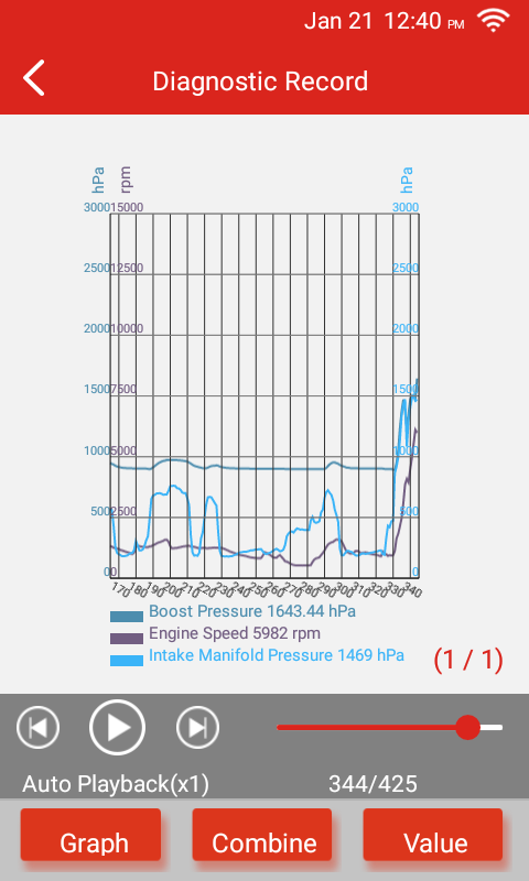

I did a first gear pull while recording the data with the Creader Elite Scanner. I don't know how to export data from it yet but I was able to extract a print screen. The car lost a bit of traction and the TC did its thing so the acceleration curve is not the smoothest. In any case, maximin boost was at 1,643 bar and maximum intake manifold pressure maxed at 1,5 bar (which I assume was the target value).
Looking again at OP data, there's something I've noticed that while his boost maxed out at 0,5 bar his intake manifold pressure was reading 1,5 bar. It might be just a difference in absolute or relative pressure reading from the scanner. My ambient pressure was at 901 hPa (0,9bar) so my engine required a boost of about 0,6 bar to reach the target manifold pressure. But since the boost pressure sensor reads absolute pressure, it read 1,6 bar.

Thank you for doing the measurement! I would say that there is a small difference in boost numbers but nothing crazy. Like @JettaRed mentioned, I will try a pull in 2nd and 3rd gear and report back

I'm still getting into the grips with the Creader scanner and its datalogging function. I'm going to try to find a parameter group that allows me to select boost pressure and engine output (HP/torque) however I could not find a customizable parameters group like in Xentry.
I am using the Veepeak OBDCheck Ble with an app on the phone. Works well too

So me can't access my datalog on my E400 engine.
The E400 of W212 , the engine M276.820 at 333 HP is torque limited to 480Nm, and not boost limited per se.
I am speaking of standard engine, not tuned one.
The turbocharging algo is targeted for mid torque and not redline WOT. This engine is comfort engine and not sporty engine.
Highest turbo boost of 0.8 bar or 11.7psi or 80Kpa above ambient pressure of the location, or altitude.
If at sea level, we can get to see the boost to 11ish psi above ambient, or 1.8 BAR of Manifold Absolute Pressure.
1 ATM at sea level is very close to 1 BAR, its 1.013 BAR in fair weather sea level.
Read post #112 here : https://mbworld.org/forums/e-class-w...ml#post9068187
As I said, this is comfort turbo, the maximum boost is at 4,500ish RPM , not at 6,000 ish RPM.
In fact at high gear, at low 3,000 ish RPM there could be high boost too.
Electronick, what is your location altitude ?
You can verify what your ECM is seeing by not running engine, but Ignition ON and using entry.
There will be 4 pressure sensors value you will get.
01 - The built in ambient pressure sensor inside the ECM MED17.7. See black color value at 993.0 hPa
02 - The Intake Manifold Absolute Pressure sensor at the front of the intake manifold
03 and 04 - The air filter box pressure sensors, one each side.
To Note :
AA. Your high pressure fuel sensors value is good. Its operation profile is the same as mine
When idiling, 120ish BAR or 120,000 Kpa is normal, no 1 in red. Highest 190BAR at above idling RPM but throttle being light is normal, no 3 in blue.
Kickdown for higher RPM, 150 BAR is normal, No 2 in green.
BB. How good is your wastegate flap condition ( air tightness ) to keep boost, no one will know until visual inspection is done.
CC. Your lambda sensors the front ones seems good, in terms of its operation.
Test your low fuel pressure values while doing 1st and 2nd gear WOT.
Make sure you have enough fuel volume into the high pressure pump.
Read here , post #12 : https://mbworld.org/forums/e-class-w...ml#post8568085
Fast summary
Let us know the result.....

Thank you for this info @S-Prihadi I agree that this is a comfort turbo and I do drive my car in a relaxed fashion (unlike you haha). From the boost figures and from what I experience, it seems like there is boost but it just takes some time before it's there. I just connected a vacuum pump to the boost solenoid (on the turbo end) and the pressure was about 27 inHg / 13,2 PSI. I can fully close the wastegates with the vacuum gauge with 17 inHg / 8,3PSI so this seems like a little overkill. When I actuate the wastegates with xentry I am not sure if they close fast enough. I will upload a video, let me know if you prefer that I upload it to Youtube.
I am pretty close to sea level here in Montreal, I uploaded a screenshot of the xentry pressure values.
Last week my laptop battery died and I can only use xentry while stationary. When I will have this fixed, I will check for the fuel pump voltage. I might as well just change the filter.
For me the most likely issue at this point is some sort of exhaust issue with some back pressure in combination with the waste gates operating slowly or not properly closing. But not severely enough to trigger a code. What do you think of the boost values in my test file compared to being at sea level?
