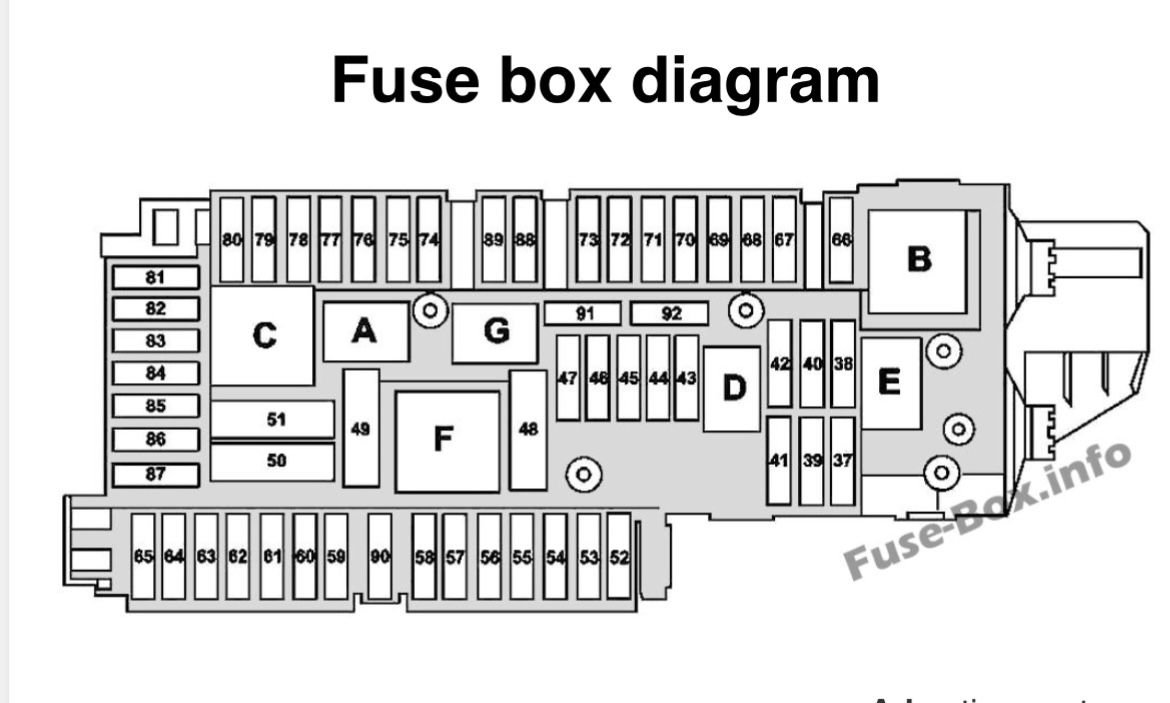

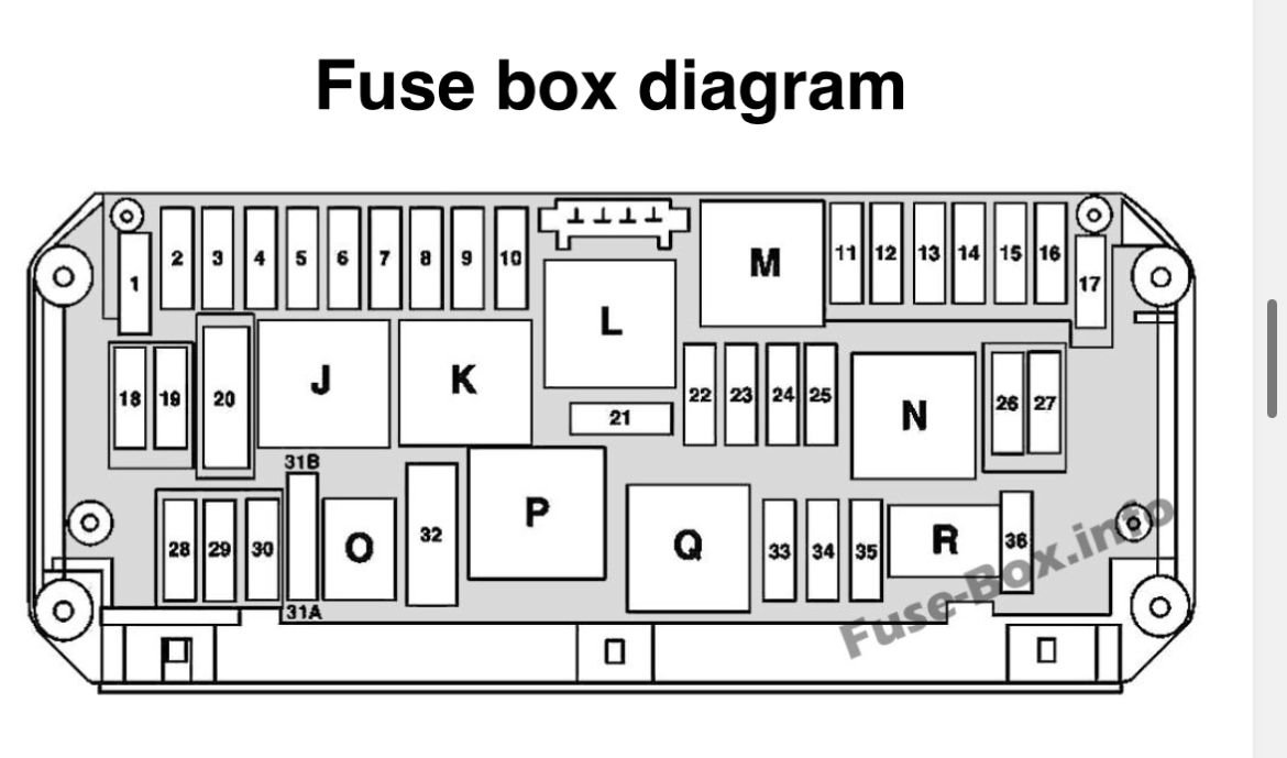

https://fuse-box.info/mercedes-benz/...uses-and-relay
You can check for power and ground at the blower connector, and determine if the problem is upstream or downstream

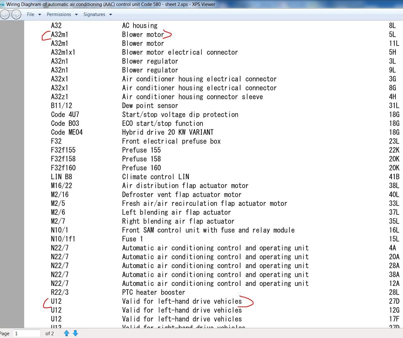

Who gave you those fuses number ?
It is so very wrong. Fuse #22 at front SAM is among the fuses for engine computer in almost all gasoline engine models of W212 and surely not HVAC blower, but is also used as radiator fan control , not main power.
Fuse #75 at rear SAM is not for HVAC blower too.

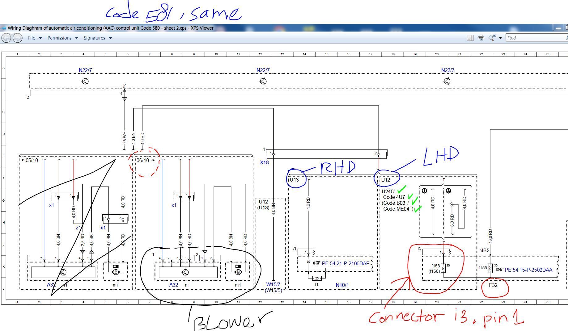

Here is the actual high power fuse location for HVAC blower. A32.
It is at F32 Front Pre-Fuse box
You are in luck, me is cleaning my F32 today...LOL.

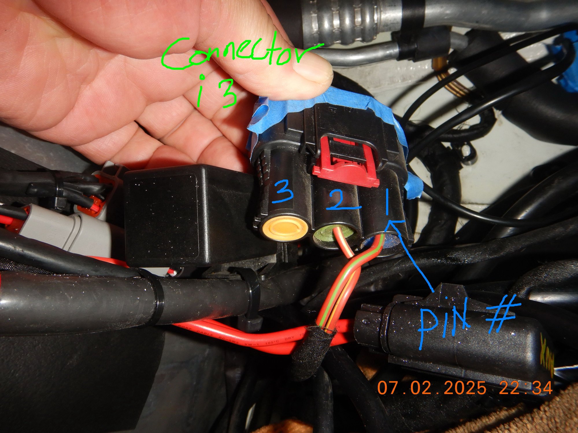

Connector i3 is below :
The PIN 1 or the P1 is the HVAC blower fuse for USA or LHD cars

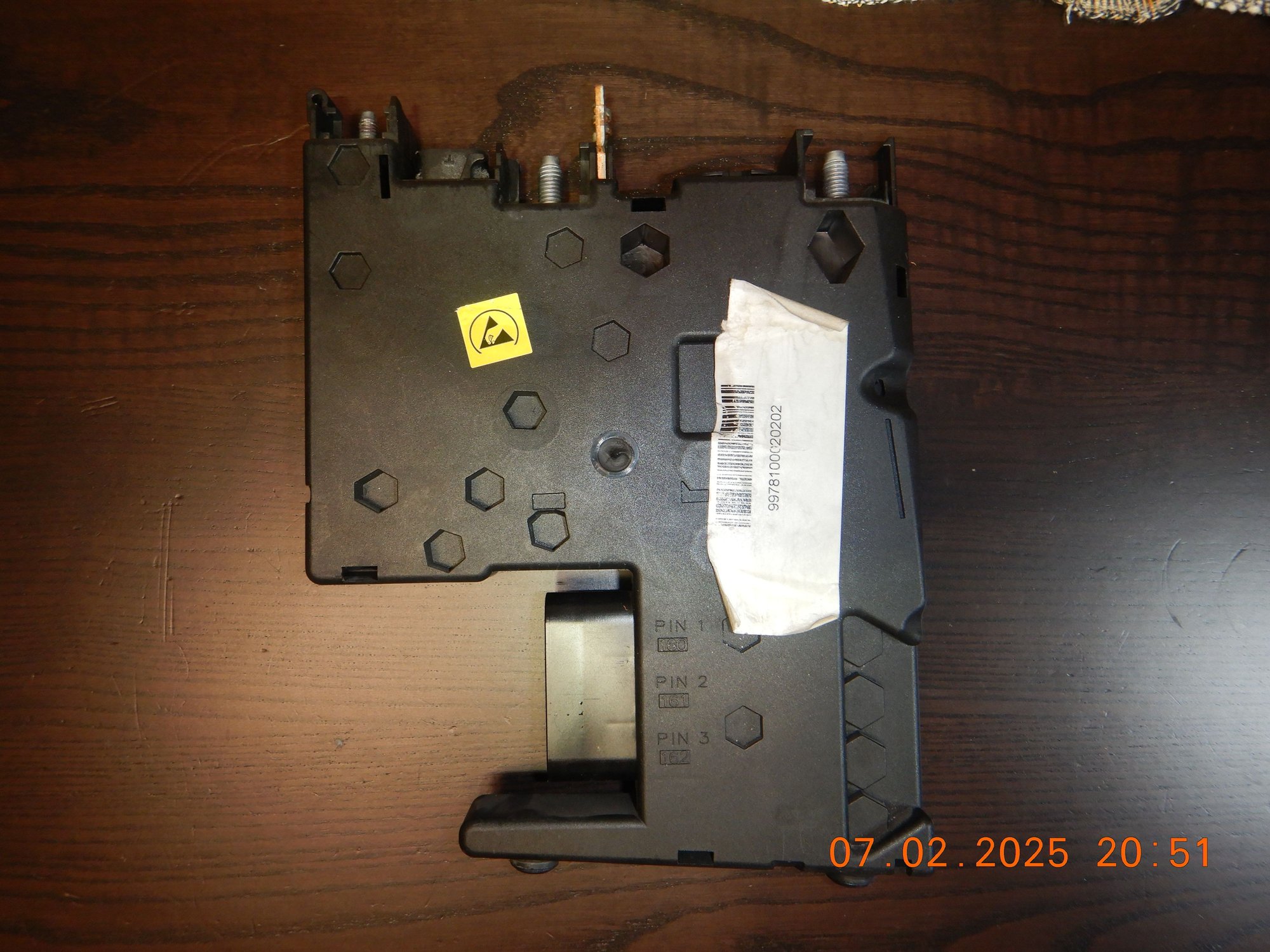

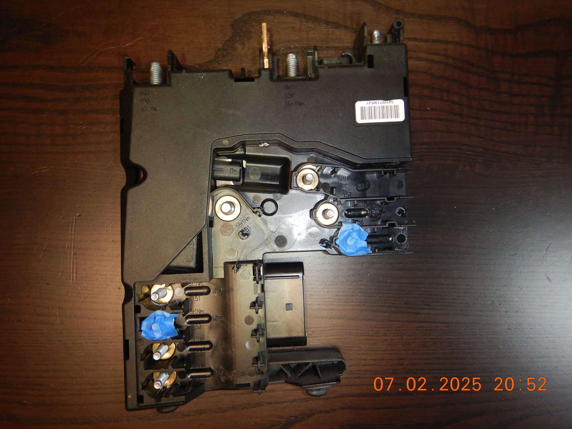

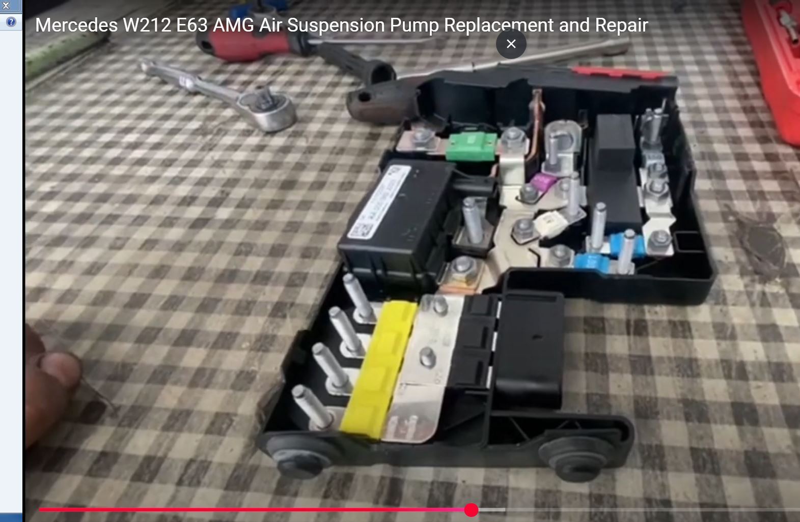

This F32 is the one on my car/ Facelift model.

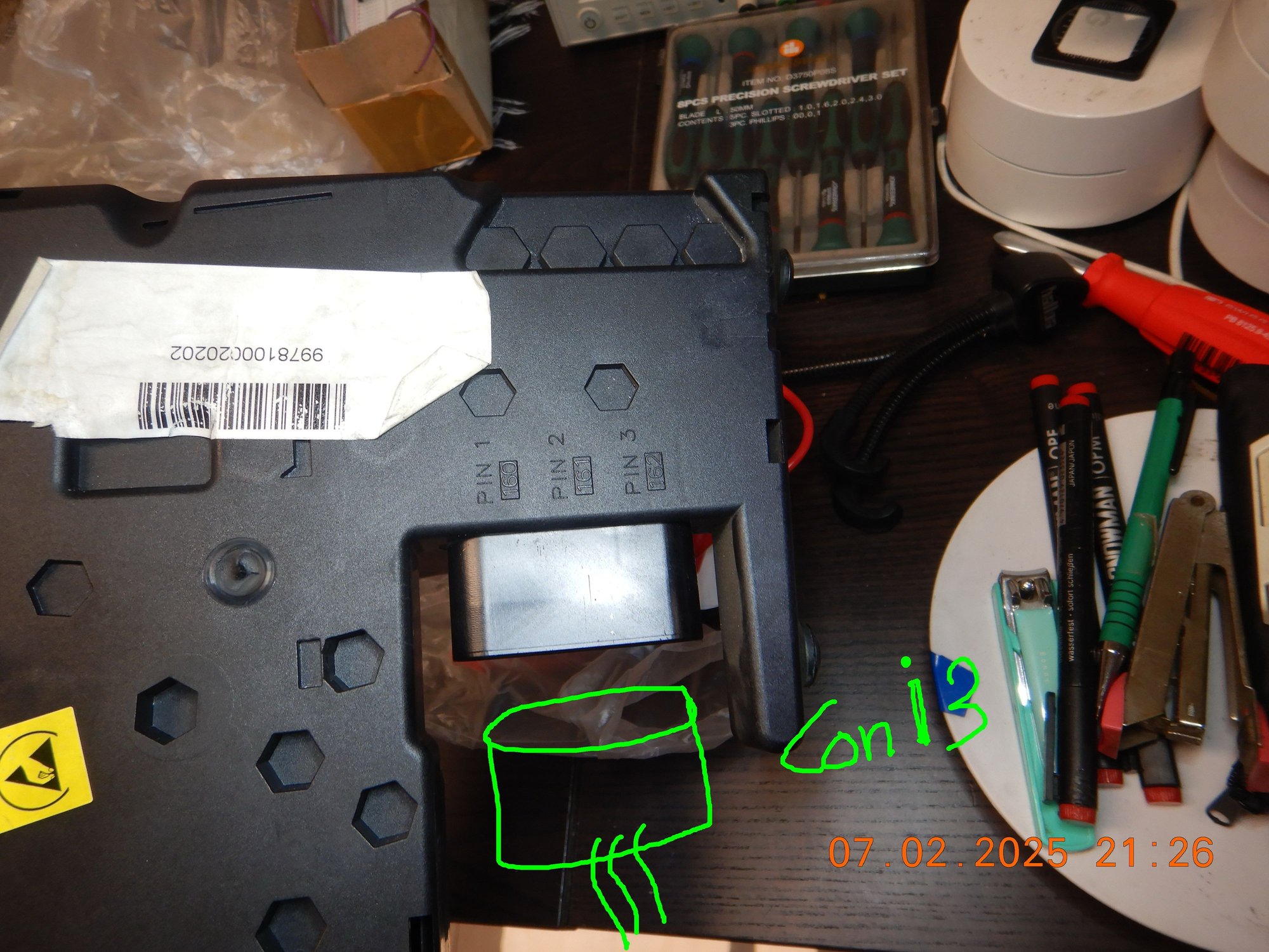

MB does not sell the fuse block stand alone, but you can modify it somehow.

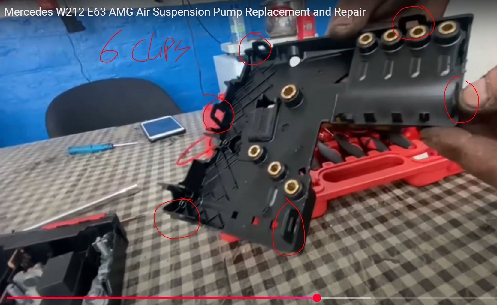

Here is a video of F32 tear-down, opening up the F32 is rather tricky so I heard.... the 6 clips can break
Good luck.........

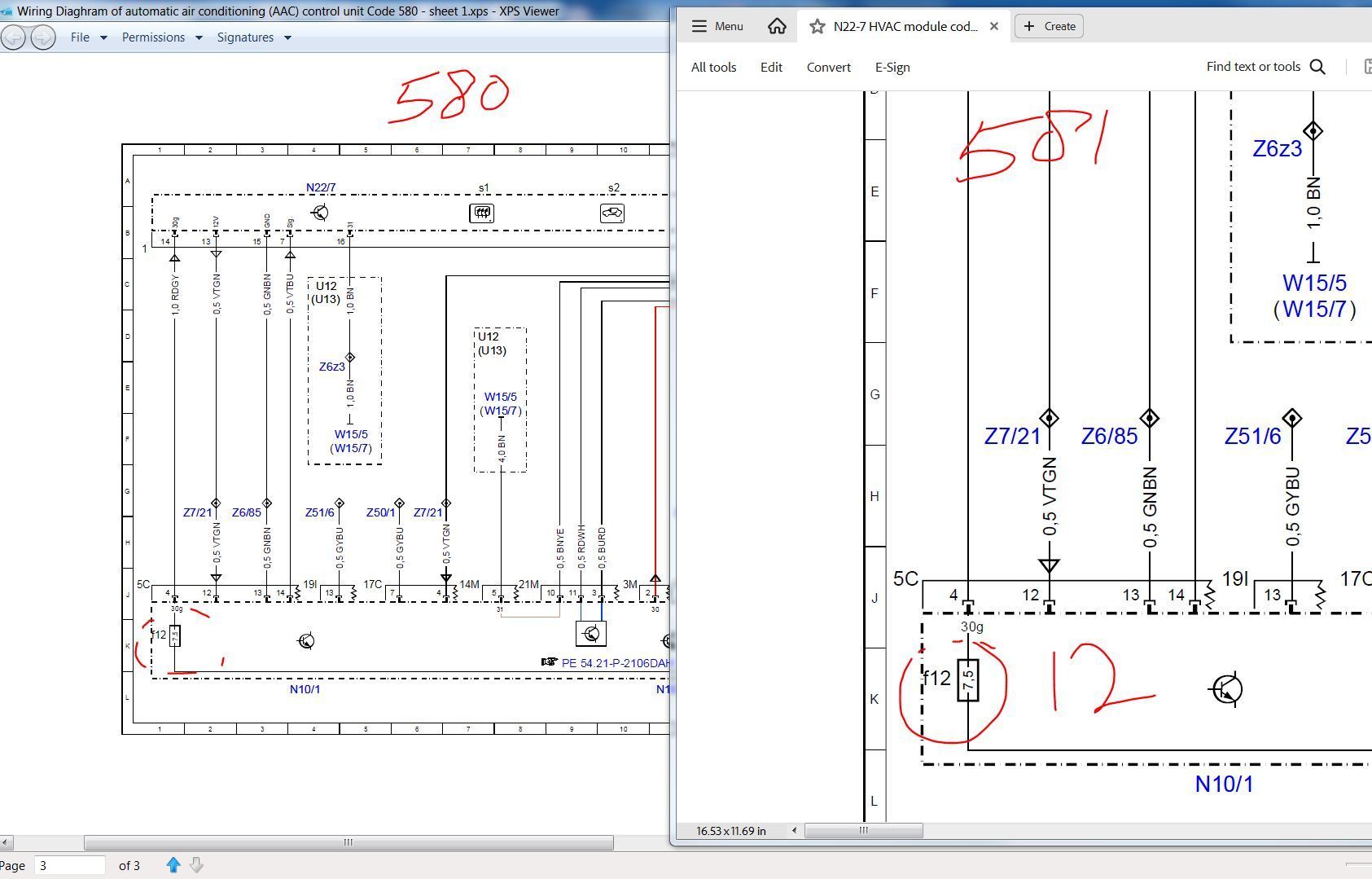

If only AC Computer fuse, that is fuse no 12 at Front SAM
