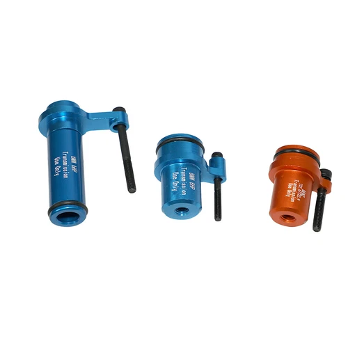

Don't recommend flushing right? Introduces air?
If torque converter has the drain plug, it is good enough for near 100% drain.
If TQ has no drain plug, the "oil-push" adapter would be good to use.
This adapter fits at the filter port and you can then push new oil into it and TC will get the new oil.
I would not call this a flush per se.
One of this below is the adapter I speak of....
Transmission Oil Drain and Flush Kit for Mercedes Benz 722.6 722.9 BMW 6HP & 8HP - Picture 4 of 10
Air trapped in oil will go away when tranny oil pumps starts running, no worry...as long as fluid level is proper
Sounds good, so point flushing.
