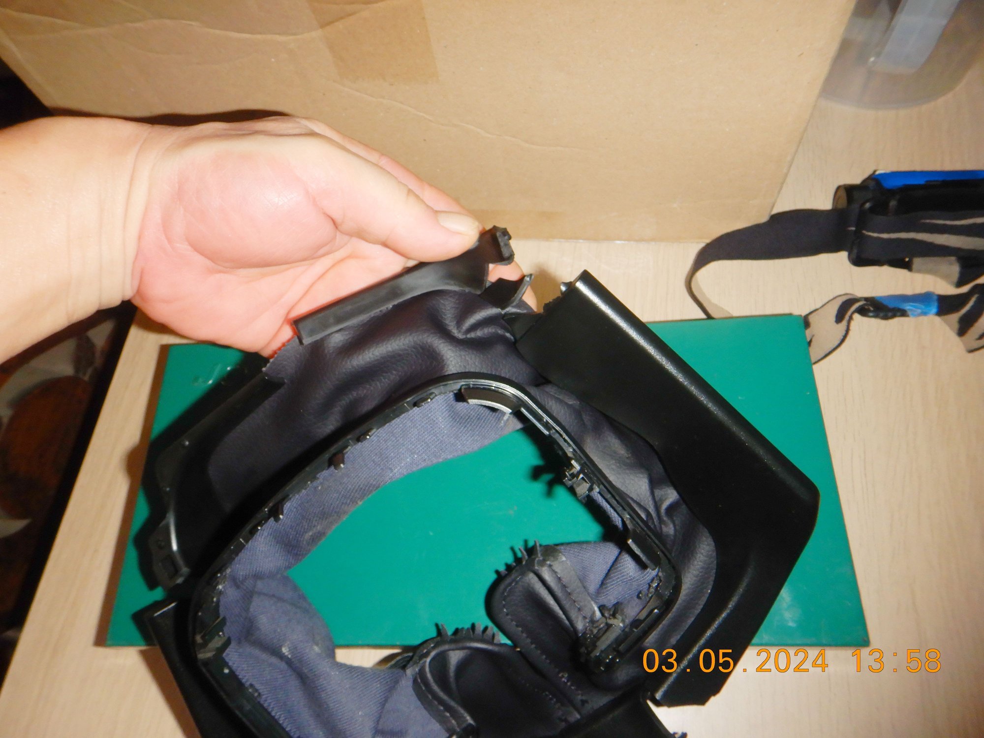

Taking out the EIS from the mounting hole in the dashboard:
I took off the outer screw ring. Several videos show guys using 2 screwdrivers. I find using a needle nose pliers or an inside caliper tool much easier than juggling 2 screwdrivers.
It's STUCK, not just falling out through the hole, behind the dash as several videos show.
Several videos show going to all lengths of removing the dashboard vents and trim, removing the radio, removing the panel above the pedals. USELESS. There is absolutely NO access to the EIS from any of these approaches.
Then I went in through the skirt area of the steering column. As I started to carefully pull the skirt trim back, the plastic cracked in 3 pieces, so I tore that all out. Still, not enough room for a child's hand to get in and get at the box. This guy's demo was more realistic to what I'm encountering. I'm going to give it one more try tomorrow, and then it's dremel cutting time.

This is a more proper way, and the only way when u have to replace the broken skirt/trim ( I broke mine already LOL ).
I broke it when trying to replace N80 steering column. Brittle plastic with age.

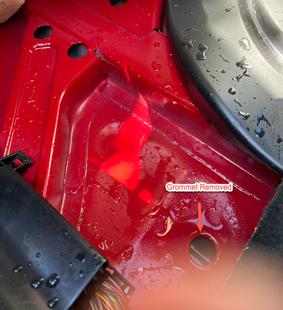

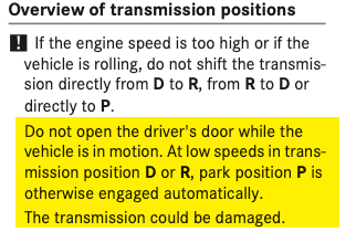

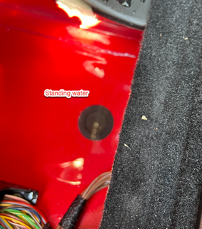

Couple of things:
At slow speeds, the tranny will shift into Park automatically if the driver's door is opened. I've only tried it at a standstill, but it's been reported to happen at slow speeds. Maybe a bad door switch could cause this.
If concerned about water intrusion and accumulation, pull up the carpeting and remove the drain hole plugs (grommets) from the floor boards.
Drain plug in place
Drain plug in place
Drain plug (grommet) removed

Originally Posted by JettaRed
Couple of things:
https://cimg9.ibsrv.net/gimg/www.mbw...de0a37b379.png
Drain plug in place
https://cimg2.ibsrv.net/gimg/www.mbw...35a141d886.png
Yes, DO NOT do that, it was a very frightening experience, and the transmission wasn't happy, I accidentally did exactly this when I started driving and the door wasn't closed properly, when it swung open a bit (still latched but not fully latched) it thought I was opening the door and the transmission slammed into Park, I am not sure if the brakes was also automatically applied but makes sense if it did.
Old Mar 15, 2025 | 05:57 PM
W205C43PFL's Avatar
Posts: 31,734
Likes: 6,177
I forgot to mention you have the same or similar behaviour if for example you accidentally pulled the parking brake while vehicle is in motion, it tells you to release parking brake but the car slams to a halt. Ouch!

not relevant: At slow speeds, the tranny will shift into Park automatically if the dr
The car door was fully closed, this was not the issue. I was going slowly, under 5mph, and the car made a clicking/grinding noise, jerked to a halt shifted into park. Door closed, seat belt securely clicked in, no dash warning lights. Car just having a mind of its own for a half mile up a muddy gravel road.

The car door can be closed and still have a bad switch. But you would probably get a code for the door switch if that was the case.
Clicking noise, sounds like the vehicle auto engaged park, parking pawl engages at below 10 or was it 5 kph if you do press it by accident, it keeps on clicking until it is slotted and the vehicle is stopped, I had that happen once before.
